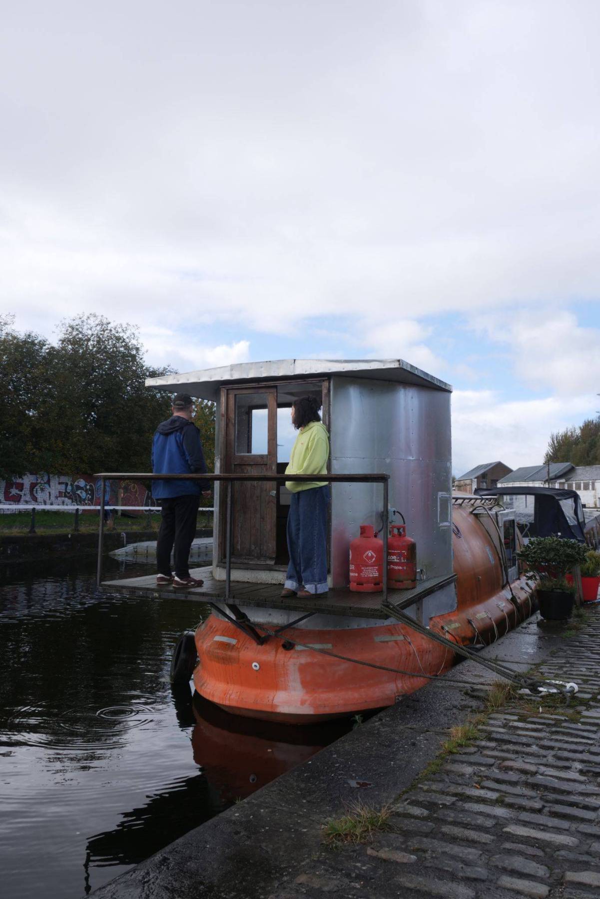

Hello boaters!
We're new owners of a renovated lifeboat that sits on the Forth & Clyde canal at Applecross, Glasgow. The engine on the lifeboat is a BUKH DV48 but is currently out of action. We believe the engine needs a service and there is potentially as electrical fault with the ignition.
We need to tow the boat down the canal away from our current mooring. Are there any boaters who might be available to tow for a day rate or know of other better options?
Thanks!
