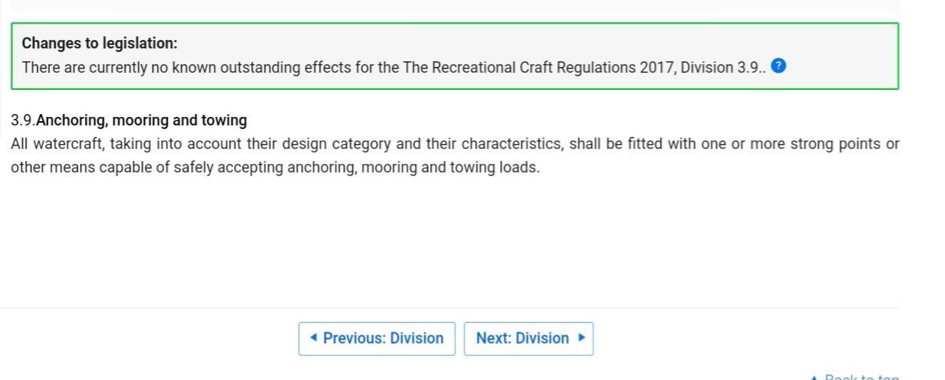

David Mack Posted November 7 Report Posted November 7 (edited) Alan, you are at it again. What you have quoted is not mandatory. What do the Essential Requirements of the regulations actually say? Edited to add I've looked it up. All very general compared to what you have quoted. Edited November 7 by David Mack

Alan de Enfield Posted November 7 Report Posted November 7 57 minutes ago, David Mack said: Alan, you are at it again. What you have quoted is not mandatory. What do the Essential Requirements of the regulations actually say? Edited to add I've looked it up. All very general compared to what you have quoted. And you are 'at it again'. If the ISO specs are complied with, it is an automatic complliance, but it you decide to 'do it another way' you need to provide evidence that your method gives 'as good a' result as the ISO standard. How do 'you' take into account the design characteristics / category without knowing what loads will be applied ? The ISO standard shows how to work out the towing / anchoring loads so it's easy enough to compare alternative methods. It does not tell you HOW it must be attached. Did you finally agree that Hire boats are commercial boats ? (you went very quiet on the subject)

Tacet Posted November 7 Report Posted November 7 (edited) 47 minutes ago, Alan de Enfield said: And you are 'at it again'. If the ISO specs are complied with, it is an automatic complliance, but it you decide to 'do it another way' you need to provide evidence that your method gives 'as good a' result as the ISO standard You're at indeed at it again, Alan. Compliance with ISO creates only a rebuttable presumption with RCR. And there is no requirement in the RCR to provide evidence of a method giving as good as a result as the ISO. Meeting the Essential Requirements of the RCR is sufficient in itself. Edited November 7 by Tacet
Alan de Enfield Posted November 7 Report Posted November 7 1 minute ago, Tacet said: Compliance with ISO creates only a rebuttable presumption with RCR. Which is what I said. The application of harmonised standards is not the only means to demonstrate the conformity of a product. However, only harmonised standards, after publication of references in the Official Journal of the EU (OJEU), may provide an automatic presumption of conformity against essential requirements covered by such standards. With the exception of the Directive’s mandatory reference to some harmonised standards (see Point 3), the manufacturer can choose whether or not to apply and refer to harmonised standards. However, if the manufacturer chooses not to follow the harmonised standards, he has the obligation to demonstrate that his products are in conformity with essential requirements by the use of other means that provide for at least an equivalent level of safety or protection. These can be technical specifications such as national standards, European or international standards which are not harmonised, i.e. not published in the OJEU, rules of notified bodies or the manufacturer’s own specifications. In these cases the manufacturer does not benefit from the presumption of conformity, but has to demonstrate the conformity himself. This implies that he demonstrates, in the technical documentation of a relevant product, in a more detailed manner how the technical specifications he uses provide conformity with the essential requirements. Manufacturers are advised to stay informed about the developments in international standardisation. Even if the manufacturer has not used harmonised standards, a change in the relevant harmonised standard could mean a change in the state of the art that implies that his product may not be compliant.
