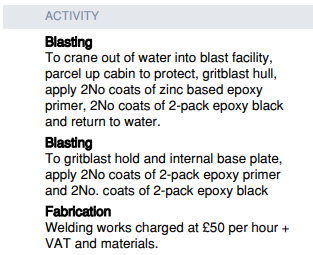

Sandblasting including the baseplate is very expensive, over £2000 at 60ft so there should not be any ambiguity in the boat's papertrail. The sandblasting cost might have been rolled into a larger invoice for a hull restoration job.
What concerns me most about your current situation is the surveyor is effectively saying the boat has not been comprehensively surveyed as yet from the perspective of a potential buyer. This is a dilemma for you as you have already shelled out for a survey and placed a deposit.
£2000? If you're including painting in that, please let me know what yard you're using. The figure is more like £5k for a full blast and paint.

Blimey! I'll definitely look into what this means in terms of insurance and what the options are moving forward.
No, that is why I used the word "sandblasting" and made no mention of "painting". I did suggest the sandblasting had being rolled into a larger restoration job.
I wouldn't really call "painting" a "larger restoration job". This work is undertaken as one and the same thing. See a portion of my recent quote below:
