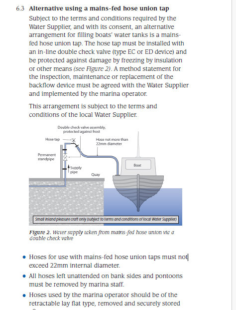

Alan de Enfield Posted October 27, 2024 Report Posted October 27, 2024 (edited) This Information and Guidance Note gives advice to owners, operators and users of inland and coastal marinas on suitable methods for filling boats (pleasure craft and similar small boats) with water to be used for drinking and domestic purposes. By using one of the methods described, marina operators will fulfil their legal duty to avoid contamination of the mains water supplies and will ensure the safety of drinking water supplies in marinas and their surroundings. There a number of alternative methods, the simplest being ................ Note the requiremenst for double check valves and the max size hose is 22mm ID Edited October 27, 2024 by Alan de Enfield

David Mack Posted October 28, 2024 Report Posted October 28, 2024 9 hours ago, Alan de Enfield said: This Information and Guidance Note gives advice to owners, operators and users of inland and coastal marinas on suitable methods for filling boats (pleasure craft and similar small boats) with water to be used for drinking and domestic purposes. By using one of the methods described, marina operators will fulfil their legal duty to avoid contamination of the mains water supplies and will ensure the safety of drinking water supplies in marinas and their surroundings. There a number of alternative methods, the simplest being ................ Note the requiremenst for double check valves and the max size hose is 22mm ID And also note the requirement that unattended hoses must be removed. In other words, this is not suitable for a permanent connection.

Alan de Enfield Posted October 28, 2024 Report Posted October 28, 2024 44 minutes ago, David Mack said: And also note the requirement that unattended hoses must be removed. In other words, this is not suitable for a permanent connection. You are correct : I made no mention of permanent connection as that is not what was being asked - It is illegal (WRAS) to have a boat permanently connected to a mains water supply.
