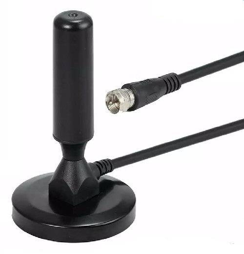

I have had an old style tv aerial on my boat since time began.... well the last 30 years or so.  On a stainless pole that sticks up about 1 meter.  It's finally been blown off the boat and looks a bit sad now it's spent a few weeks under the boat.
I have rescued it and straightened it out a bit.  But whilst looking for an upgrade on the internet, I have come across a vertical aerial with a magnetic base which will clamp to the boat.
Here is a pic of an example
Has anybody tried one and it works ok?  I am moored up nr Conglton (Macclefiel canal).  The old style aerial does work mostly but is an upgrade to the new type the way forward.?

Yes they work well. Mine has a usb that plugs into the TV that powers a signal booster also. I hang mine in the window and it works in most places. Worth the tenner they cost.

If you're in a good signal area they'll work fine. In a poor signal area they won't, they have much lower gain than the traditional aerials.
So it all depends where you're moored -- but for a tenner you might as well give it a go, and send it back if it doesn't work.

That'll be physics then, because a directional log periodic antenna has much more RF gain (dBi) than any small panel antenna, and even more so a small stick one -- all adding amplification does is amplify the small signal and the noise together... 😉
So if the signal is pretty poor -- which is often the case out in the sticks -- an old-style antenna will win every time, if it's just poor the panel will probably work OK but the stick won't, if it's good the little stick will be OK -- as will almost any old bit of wire stuffed into the aerial socket... 😉
