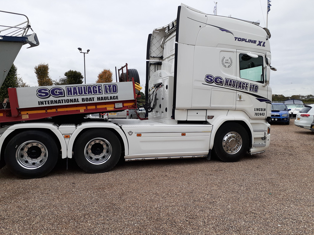

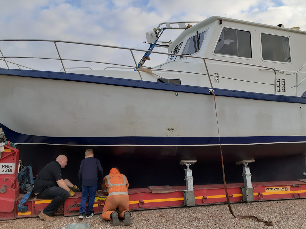

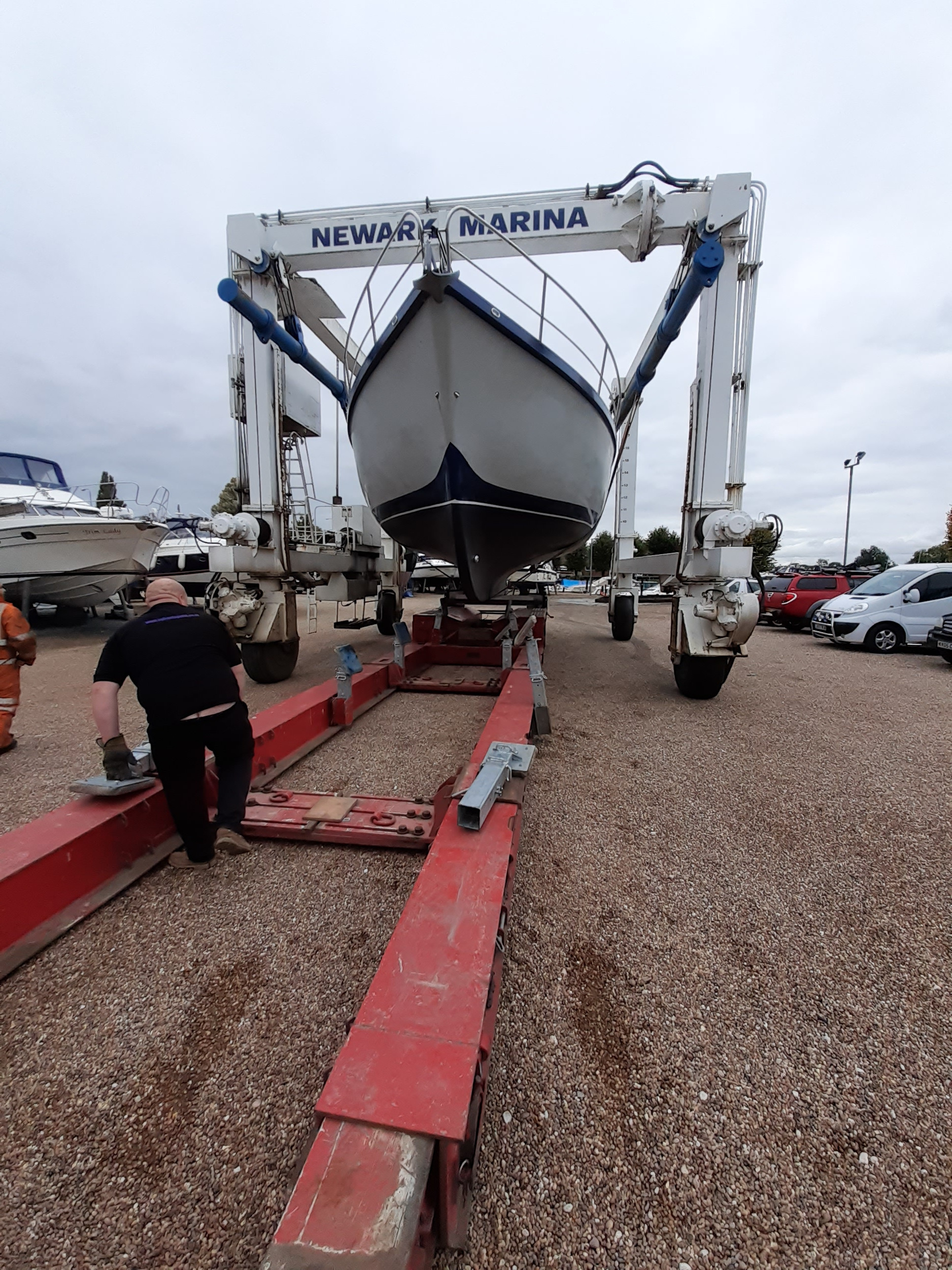

On 23/09/2024 at 15:11, Alan de Enfield said:
Mine was an expensive specialist mover as the height of the boat meant it wouldn't fit under standard UK bridges (16' 6") even with everything folded down.
I had to get a special low loader that had a hydraulic trailer so that when they got to a bridge it could be lowered from 'road driving height' down to 100mm, go thru the bridge, stop and raise it again. (It then came down to 16' 0" so was OK).
It cost £2500 to move 205 miles (across england from Newark to North Wales. Took 2 days due to Police driving hours restrictions, and two people and an Escort vehicle.
If you want to call them the name is on the side of the truck. They do International collections and deliveries so know what they are doing crossing borders. They do have 'normal' boat moving lorries as well.
Being in Lincoln they are well placed to do Hull - Rotterdam for a Netherlands pick up.. back to Hull and up the A1 to Scotland.
Simples.
I'm sure I've heard of SG Haulage, I might've even sent an email for a quote from them but got no reply. Perhaps my best bet would be to phone them up instead?
