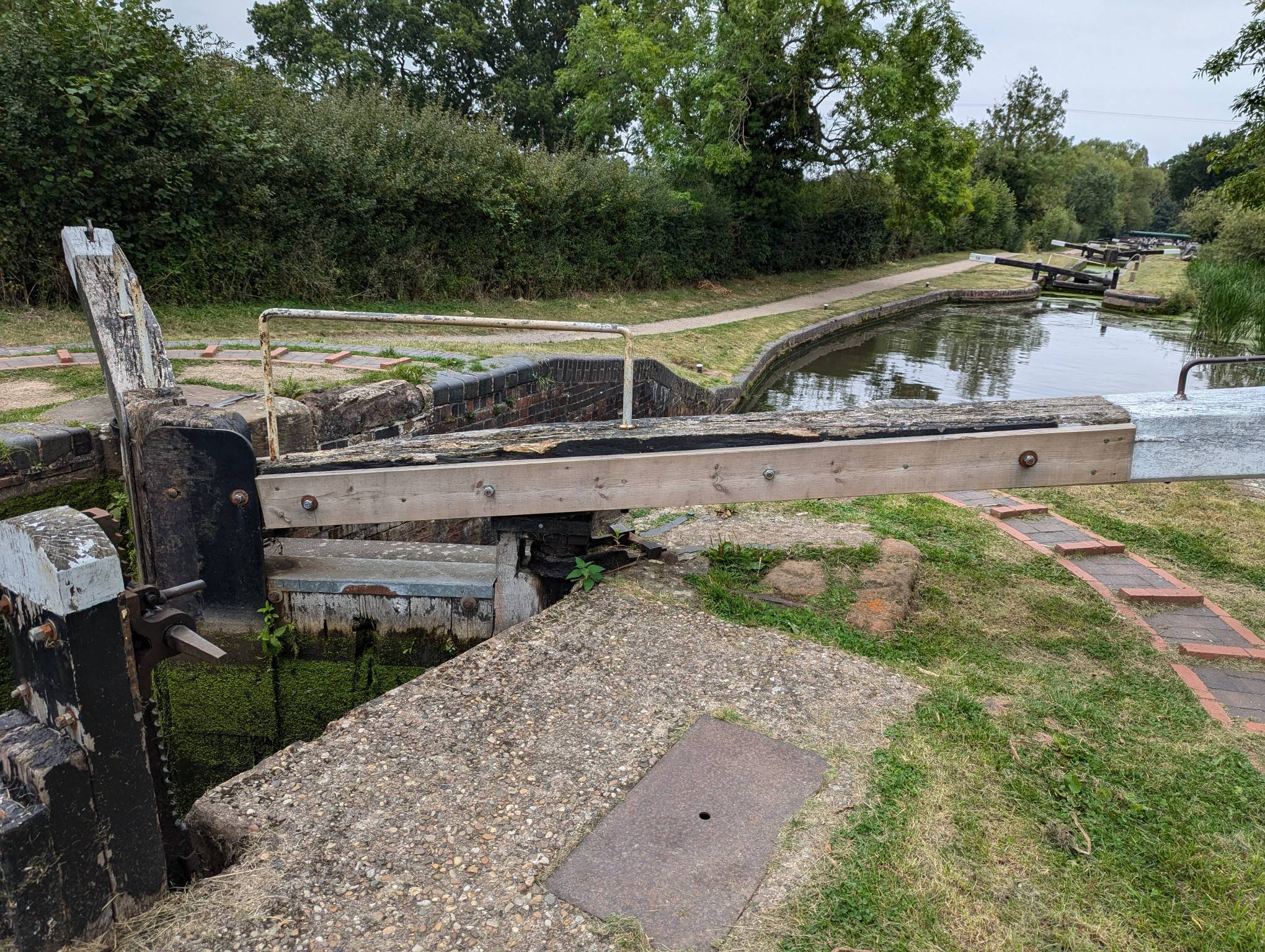

What your photo doesn't show is the leakage through the bottom gate that virtually equals the input from the gate paddle as the level rises.
Thankfully the queues formed by the slow operation means there is inevitably some other boaters about to lend a hand ( or bum or back)😁
I encountered dozens of these 'temporary' repairs down the GU this summer.
I suppose it's easy to be critical of a 'bodge job' but to be fair, the locks are working and continue to be used quite heavily.
Much better than lengthy closure don't you think ?
Rog
Rog
Yeah, but these repairs will eventually fail, due to movement of the balance beam wearing the wood against the steel and continuing rotting of the wood. What happens if they all go in quick succession?
C&RT do seem to be increasingly cobbling things together in the short term. I can only assume this is due to lack of funds rather than apathy.
This kicking the can down the road is only storing up increased costs as eventually these lash-ups will fail and require rectification.  If the necessary funds are not available at this point then prolonged closures would seem to be the inevitable result.  There currently seems to be little interest from central government so the omens are not great.

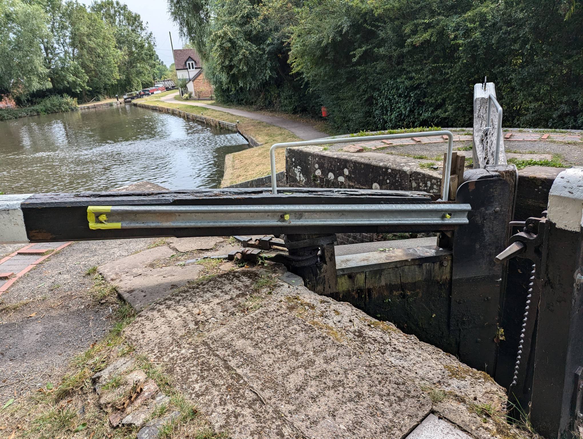

At least that had a proper brace on it.

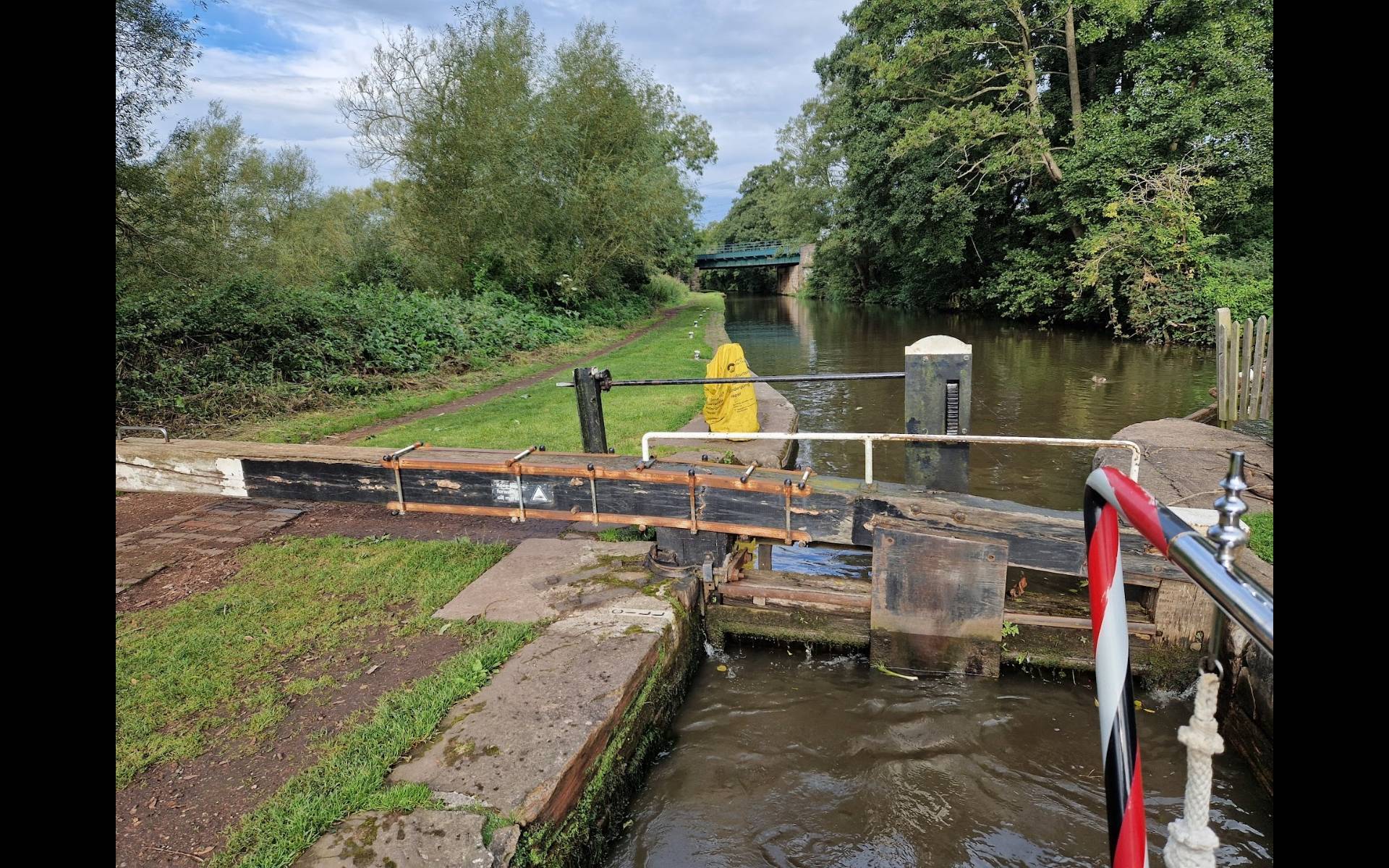

This was Lapworth a few weeks ago. It wasn't just these 2, a couple of the other gates on the flight felt like the beams were not far off failure either.
I did like the yellow sticky tape covering the raw end of the metal work!
