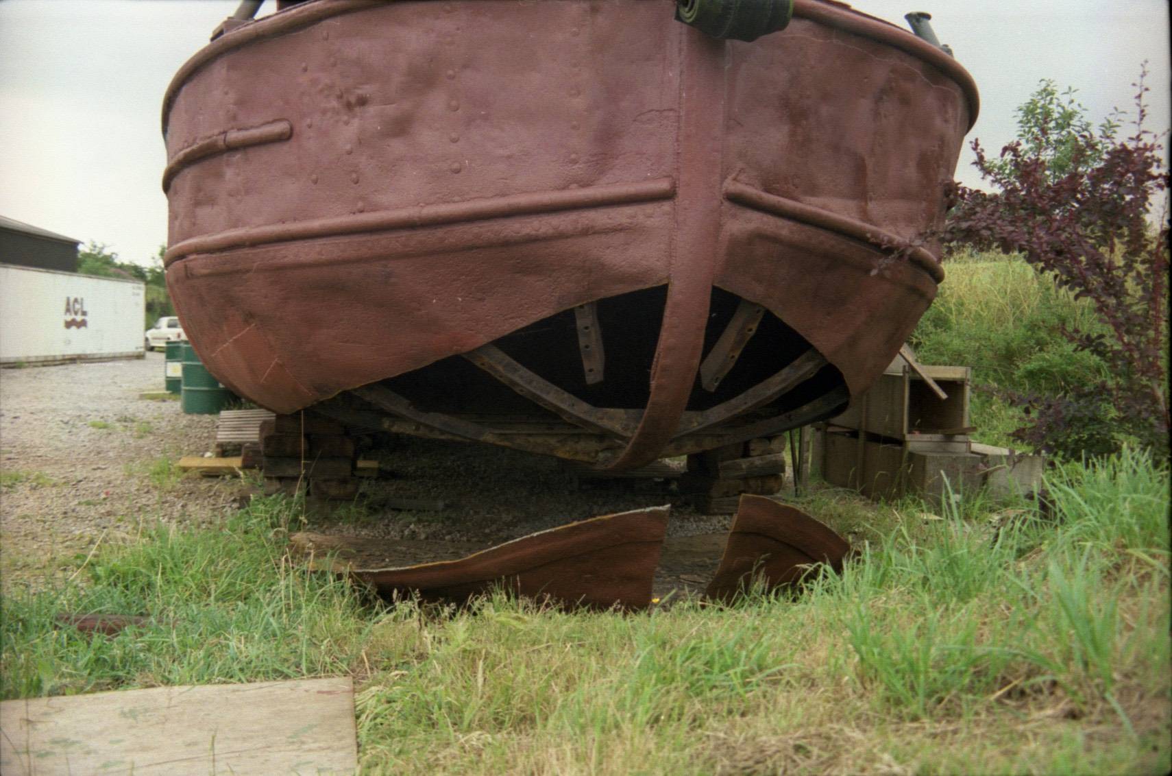

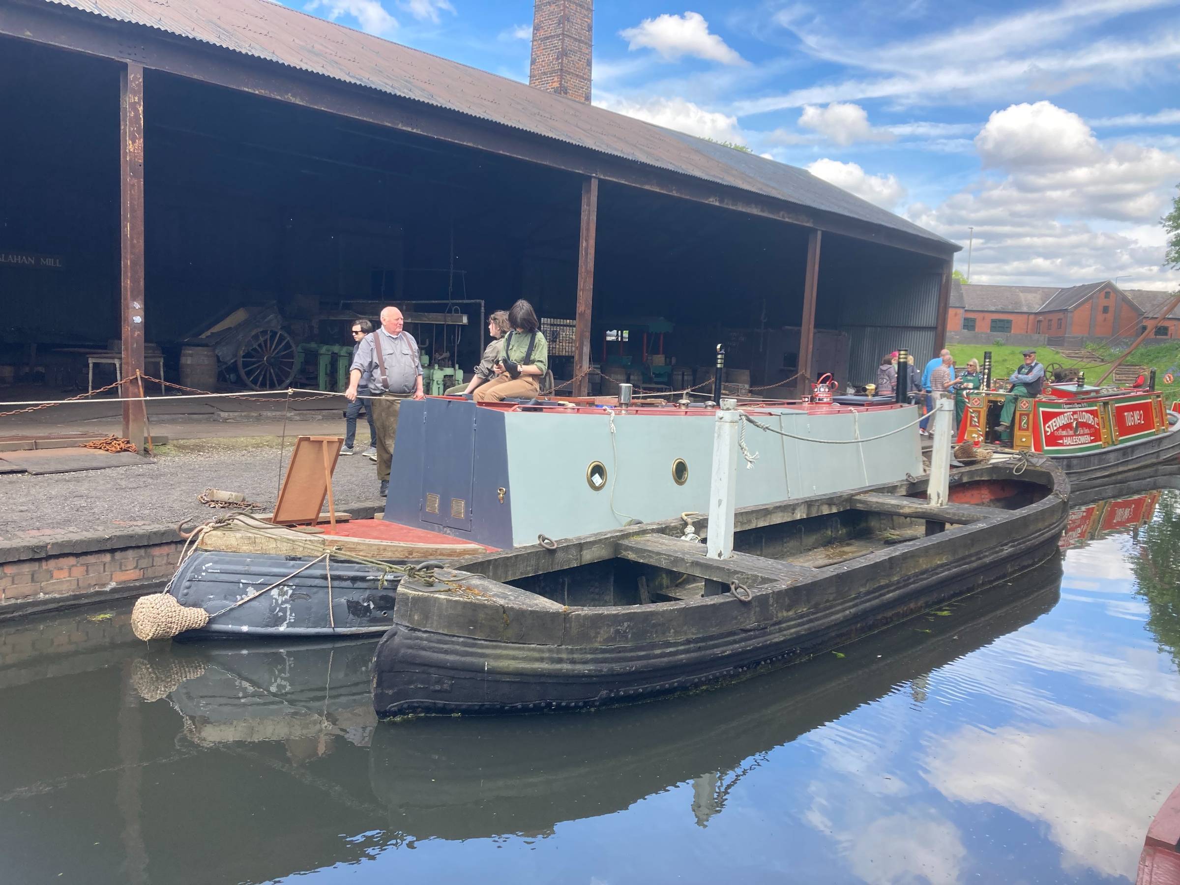

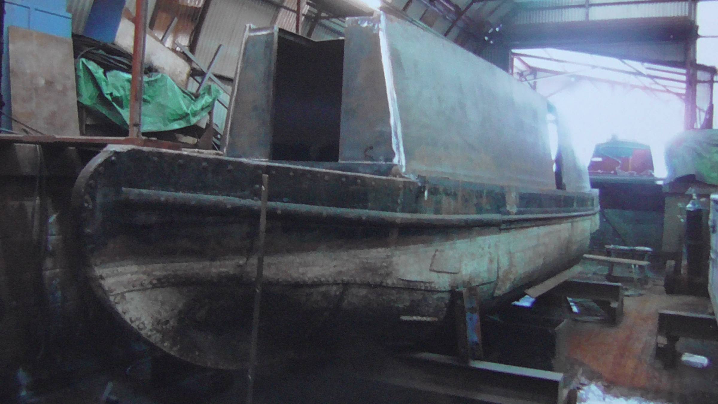

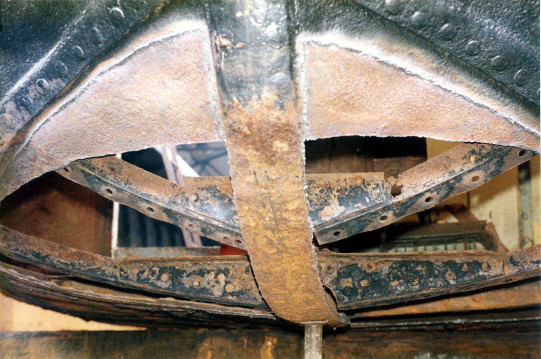

While we're doing icebreaking boat photos, here are sisters Oates and Ross, Coventry and Tardebigge:IMG_20240504_1529572.thumb.jpg.e3743596a2b92187ea6f0c42f6eed6d2.jpg
Another picture of Oates and Ross. Ross is still set up as an iceboat, but missing its rudder (it was broken and has not been repaired). Oates would have looked like this when working but was converted in 1974.
These two boats were probably built in the 1840s, definitely before 1858, with Oates being a few years older. The third sister is Baltic which is between them in age. Note that despite being similar there are differences in shape of the bow.
Alec

As I wrote on the other concrete thread, the L&LC short boats built at Northwich in the 1930s and 40s had a concrete wash painted on the parts of the hull made inaccessible by the bow cabin. I have seen one where the brush marks were still visible.
On ice breaker hull shape, there were two types of boat. The horse-drawn ones were designed to have their boat pulled out of the water, the ice being broken by rocking the boat such that the sides broke the ice. The triangular L&LC design was, in effect a very large and heavy lump of timber which, because of the sides, could float. This was partially pulled out onto the ice, which was broken by rocking the boat and the weight of the kelson. When steamers were introduced, they broke the ice using a steel plate which covered the bow at water line. They could push a horse-drawn type ice boat in front of the bow for thick ice. Modern, is 1960s, ice breakers would probably be of this type.
Absolutely fascinating info to find out- thank you so much!
Could I ask if you know any of the names of those boats or how the concrete held up in them?
It is some years ago that I noticed the concrete wash, and many of the surviving short boats have been further renovated and/or moved abroad since then. There is a list of surviving boats, but it would be difficult to get to see the inside of the bows on most of them. These two photos show the bows of Kennet and Wye during refurbishment. The cement wash sections were removed, but they were at the most vulnerable part of the bow, worn thin by abrasion when loaded.
Steel boats.docx
Really cool seeing all the different internal aspects of the bow like that- what an art form! thank you for sharing :)
