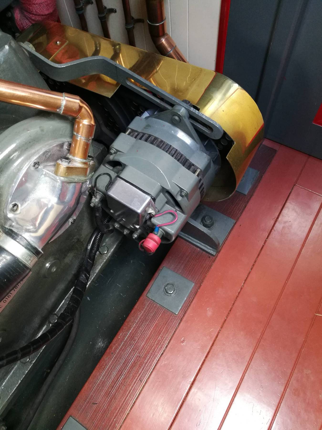

How old or how many hours has the alternator done because it may be worn brushes - if Leece Nevile uses them. I am not sure about that because I have never worked on one. Google suggests it does.
It also seems that it is a 6 diode machine so the warning lamp is not much use for diagnosis. Be very wary, it seems they use B+ to signify the warning lamp connection. On no account connect that to the battery.
This link may help https://www.peivinlookup.com/Category/8LHA2070VB/PRESTOLITE-LEECE-NEVILLE-8LHA-12V-160A-BRUSH-ALTERNATOR

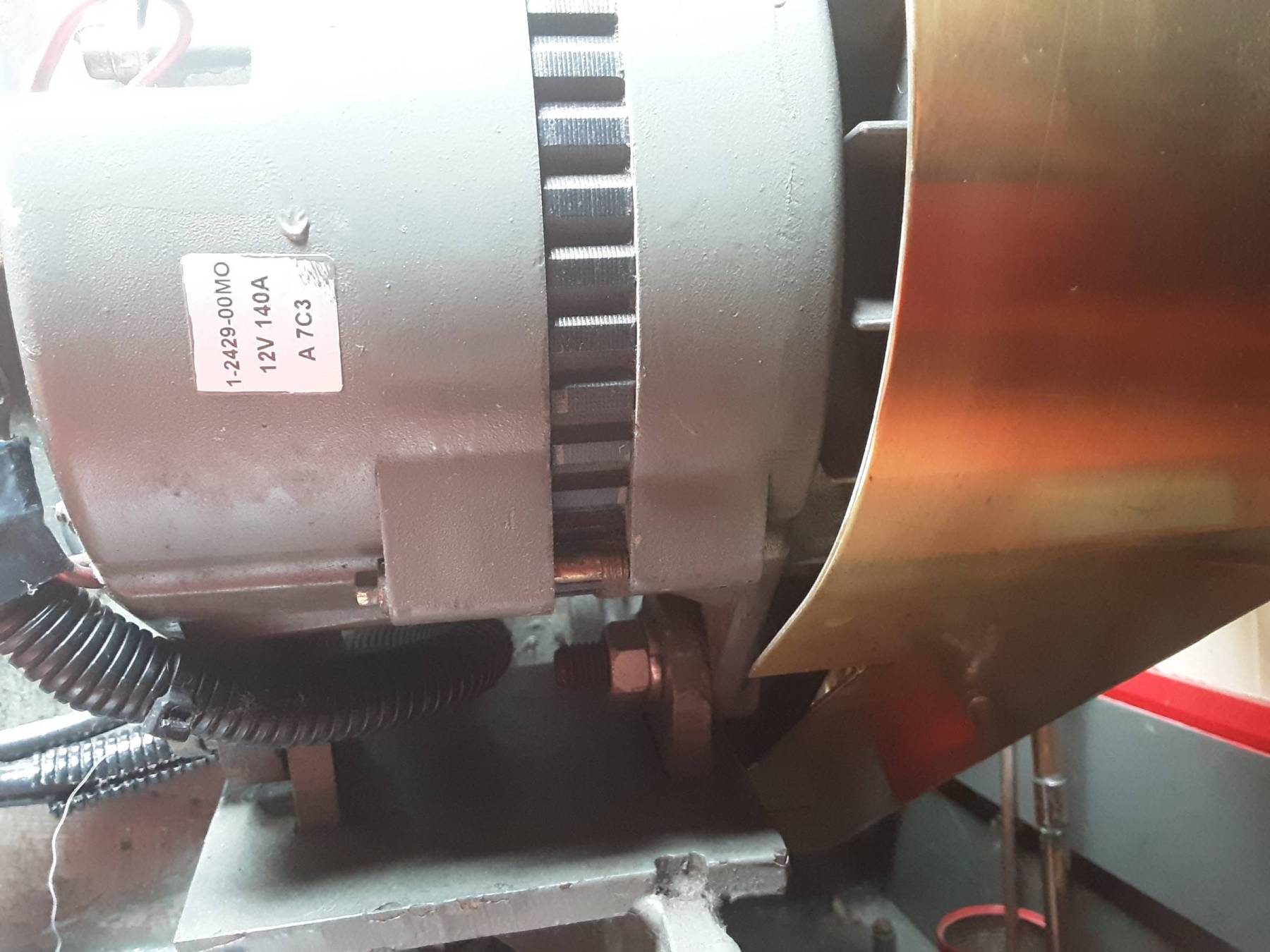

Does the alternator have a warning light? It doesn't look as though it does from the connections, but worth asking! Depending on the exact model, the alternator may use power coming down the warning light circuit as an indication to "wake up" so if the bulb had blown this could be the problem. It would help to know the exact model of alternator as there are a number of similar variants.
If it doesn't have a warning light, there is not much left to check except that I would check it is still connected to the batteries ie if there is battery voltage across the big red and black terminals on the back of it. Otherwise I think you will have to remove it to be checked. As Tony says, one possibility is worn brushes but could be something else. There is a procedure for restoring the residual magnetism in the rotor (necessary for it to start, being a 6 diode machine without IG terminal) but it seems unlikely that this has been lost unless there was some "event" such as mechanical shock or reverse connection.
No lights on the alternator. As far as I know. The only reference on it is the little sticker.

If its the one I think it is its brushless.
Looks like I need to visit an electrician then.
Leece Neville ( Prestolite ) have their own travelling service engineers, a phone call to them may answer your problem directly.
