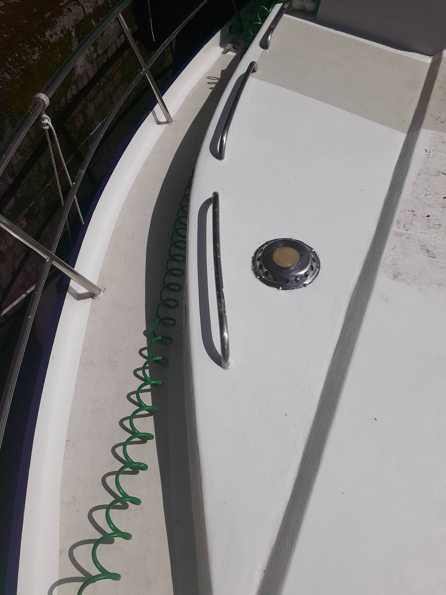

Alan de Enfield Posted August 19, 2024 Report Posted August 19, 2024 (edited) Get a good quality masking tape like 'Frog Tape' it will follow the bow curve and will stop 'bleed under' that you tend to get with the cheaper 'paper' types. It depends on how tight your curve is - not a good picture, but this is mine, done with grey antislip on top of white 2-pack. Edited August 19, 2024 by Alan de Enfield

numpty Posted August 20, 2024 Author Report Posted August 20, 2024 Thank you for your help gentlefolk. I appreciate it. I will bit some of the tape suggested and mask off as carefully as I can. I like the look of your grey nonslip and in tempted to try that@Alan de Enfield Is it cool in the sunlight? My brown is unbearable to walk on with bare feet. I am using ready made nonslip paint and I wonder if I can apply any old undercoat to lighten the brown before applying the top nonslip coat? i do appreciate the help
Alan de Enfield Posted August 20, 2024 Report Posted August 20, 2024 5 hours ago, numpty said: Is it cool in the sunlight Yes. It is 'ready made' with very small plastic beads incorporated into the paint - just needs a good stiring before using.
