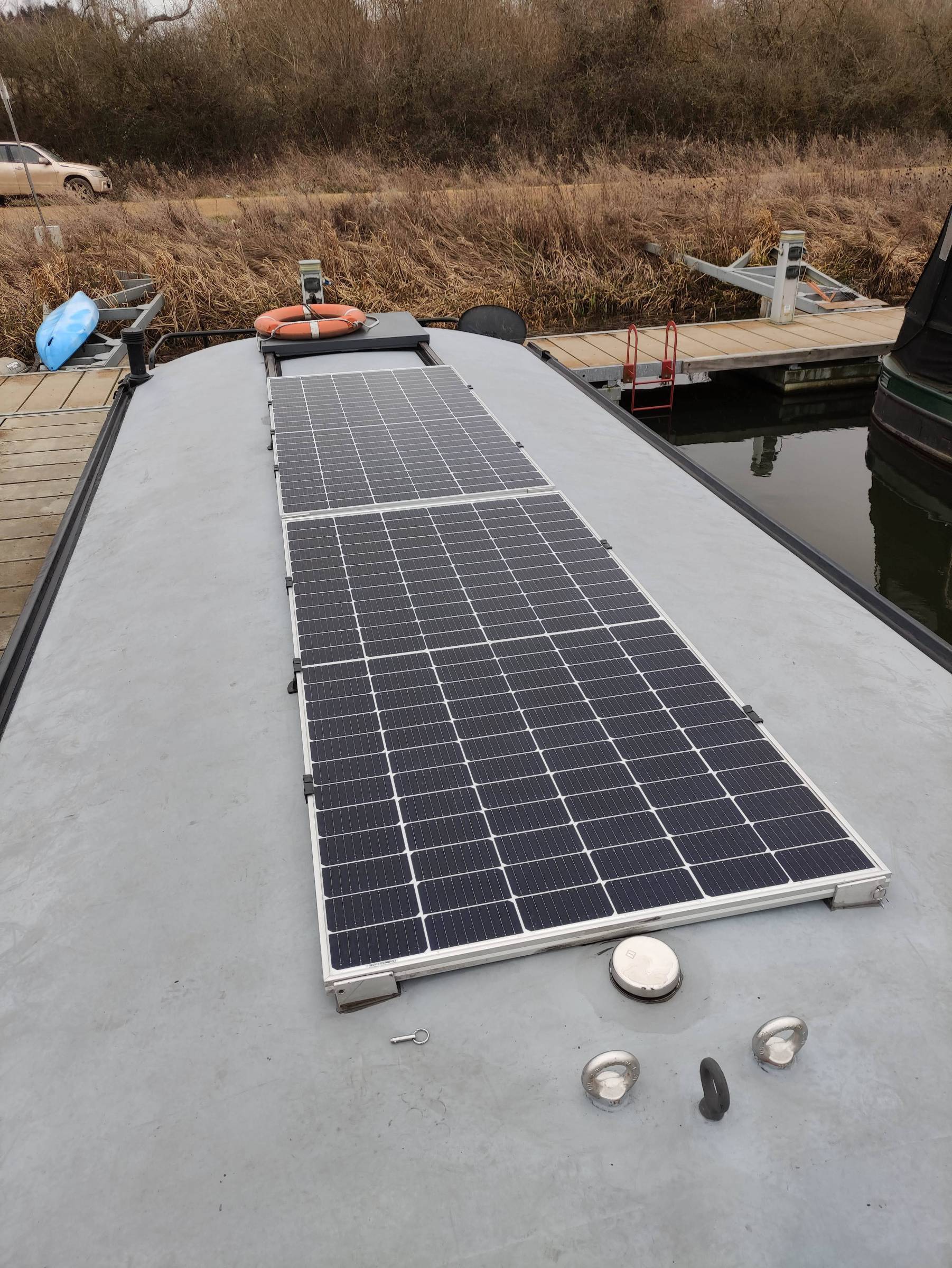

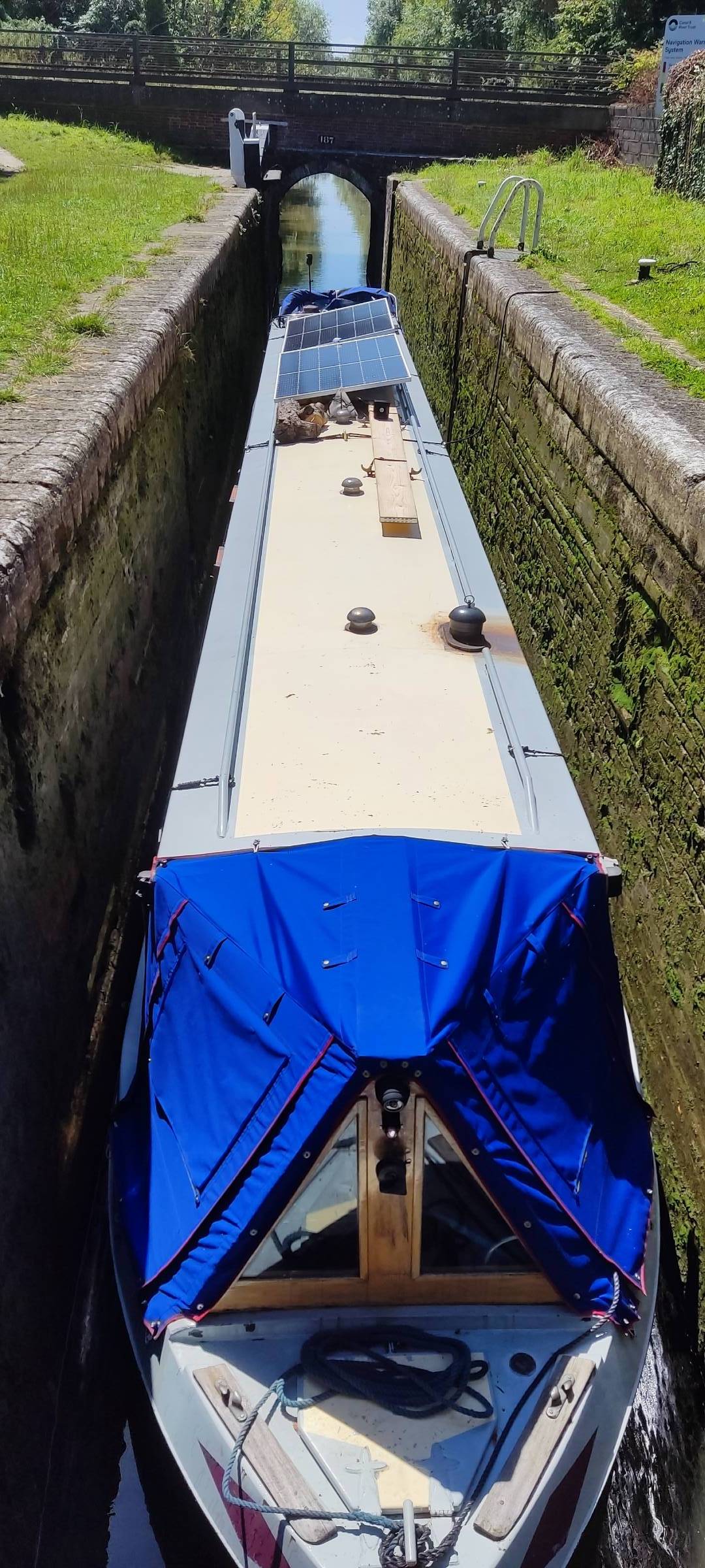

jacob Posted August 19, 2024 Report Posted August 19, 2024 We've got 3 of those Longi 410w panels on our 56ft NB, 2 on boxes and one on a mount. There's a chunk of roofspace left over, and not yet fallen in at a lock trying to navigate round them... I put them in around April, and they've been supplying all our electricity since (CCing), although I'm sure we'll be relying on the engine come October/November to supplement them. This month they've supplied between 2-4KWh each day, with a solar dump setup heating our water to make the most of them.

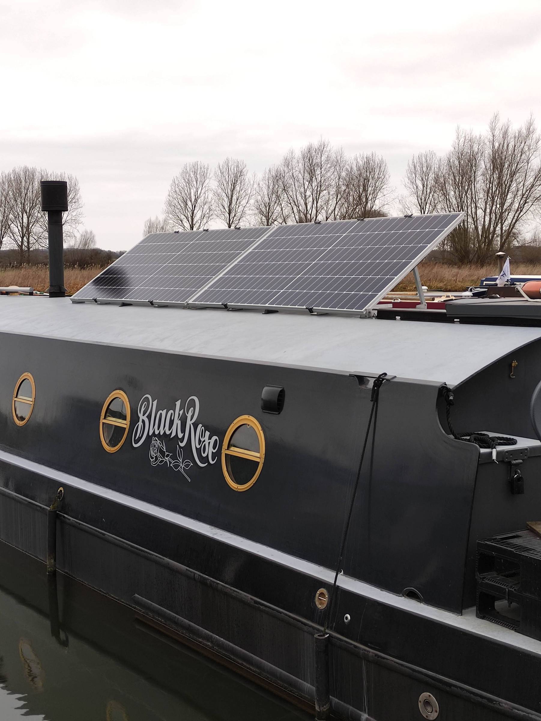

Baralacha Posted August 19, 2024 Report Posted August 19, 2024 21 minutes ago, NarrowboatTor said: Hi Martin, I bought similar sized panels from them last year, 2x 500w for £80 a panel. Pic attached to show how I fitted them and yes they work really well. I can still walk down the sides of the roof and having used the triangle supports the grab rails are still available. They do sit perfectly "square" overlapping the rails tho so you may have to factor that in dependant on your rail position. Works for me and they make a semi decent dryish storage area underneath 😊 Sorry to be critical, but your grab rails appear to reduce the already limited tilt angle of your panels on the brackets. As @Bargebuilder comments, you want a good tilt in the winter - 45º minimum, 60º ideally. I went for flat mounted, 3x 295W mono and haven't regretted it. The winter of 22-23 (my first with solar power) needed no supplementary power to charge my batteries; last winter I ran my generator about six times, as there was both the seasonal low angle of the sun and layered clouds attenuating the light to contend with. Maybe in this case tilting panels might have helped, but it cost me less than £8 in petrol for the Honda.

Torblimey Posted August 19, 2024 Report Posted August 19, 2024 6 minutes ago, Puffling said: Sorry to be critical, but your grab rails appear to reduce the already limited tilt angle of your panels on the brackets. As @Bargebuilder comments, you want a good tilt in the winter - 45º minimum, 60º ideally. I went for flat mounted, 3x 295W mono and haven't regretted it. The winter of 22-23 (my first with solar power) needed no supplementary power to charge my batteries; last winter I ran my generator about six times, as there was both the seasonal low angle of the sun and layered clouds attenuating the light to contend with. Maybe in this case tilting panels might have helped, but it cost me less than £8 in petrol for the Honda. Yep, I'm not to worried about adjusting the angles, it was mainly to get under low bridges or weird shaped sections. Jenny stored safe for winter and the engine also tops up quite happily. February this year and things were topping up solar wise to absorbtion if not fully to float. I don't get to stuck on every little detail, if it works fab, if it doesn't I'll find a way to make it work 😆
