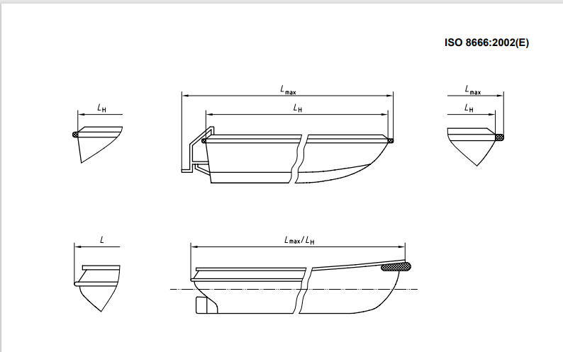

I think it would be the Hull Length (LH) that would be the one to meaasure.
The relevant harmonised standard for measuring the craft’s hull length is the current version of EN ISO 8666 Small craft – Principal data.
5.2 Longitudinal
The lengths of a craft shall be measured parallel to the reference waterline and craft centreline as the distance between two vertical planes, perpendicular to the centreplane of the craft.
5.2.1 Maximum length, Lmax The maximum length, Lmax, shall be measured in accordance with 5.2, one plane passing through the foremost part and the other through the aftermost part of the craft. This length includes all structural and integral parts of the craft, such as wooden, plastic or metal stems or sterns, bulwarks and hull/deck joints. This length includes parts which are normally fixed, such as fixed spars, bowsprits, pulpits at either end of the craft, stemhead fittings, rudders, outboard motor brackets, outdrives, waterjets and any propulsion units extending beyond the transom, diving and boarding platforms, rubbing strakes and permanent fenders. Outdrives, waterjets, other propulsion units and all movable parts shall be measured in their normal operating condition to their maximum lengthwise extension when the craft is underway. This length excludes:  outboard motors;  any other type of equipment that can be detached without the use of tools.
See Figure 1 for monohull measurements and Figure 2 for multihull measurements.
5.2.2 Length of the hull, LH The length of the hull, LH, shall be measured in accordance with 5.2, one plane passing through the foremost part of the craft and the other through the aftermost part of the craft. This length includes all structural and integral parts of the craft, such as wooden, plastic or metal stems or sterns, bulwarks and hull/deck joints. This length excludes removable parts that can be detached in a non-destructive manner and without affecting the structural integrity of the craft, e.g. spars, bowsprits, pulpits at either end of the craft, stemhead fittings, rudders, outdrives, outboard motors and their mounting brackets and plates, diving platforms, boarding platforms, rubbing strakes and fenders. This length does not exclude detachable parts of the hull, which act as hydrostatic or dynamic support when the craft is at rest or underway.
