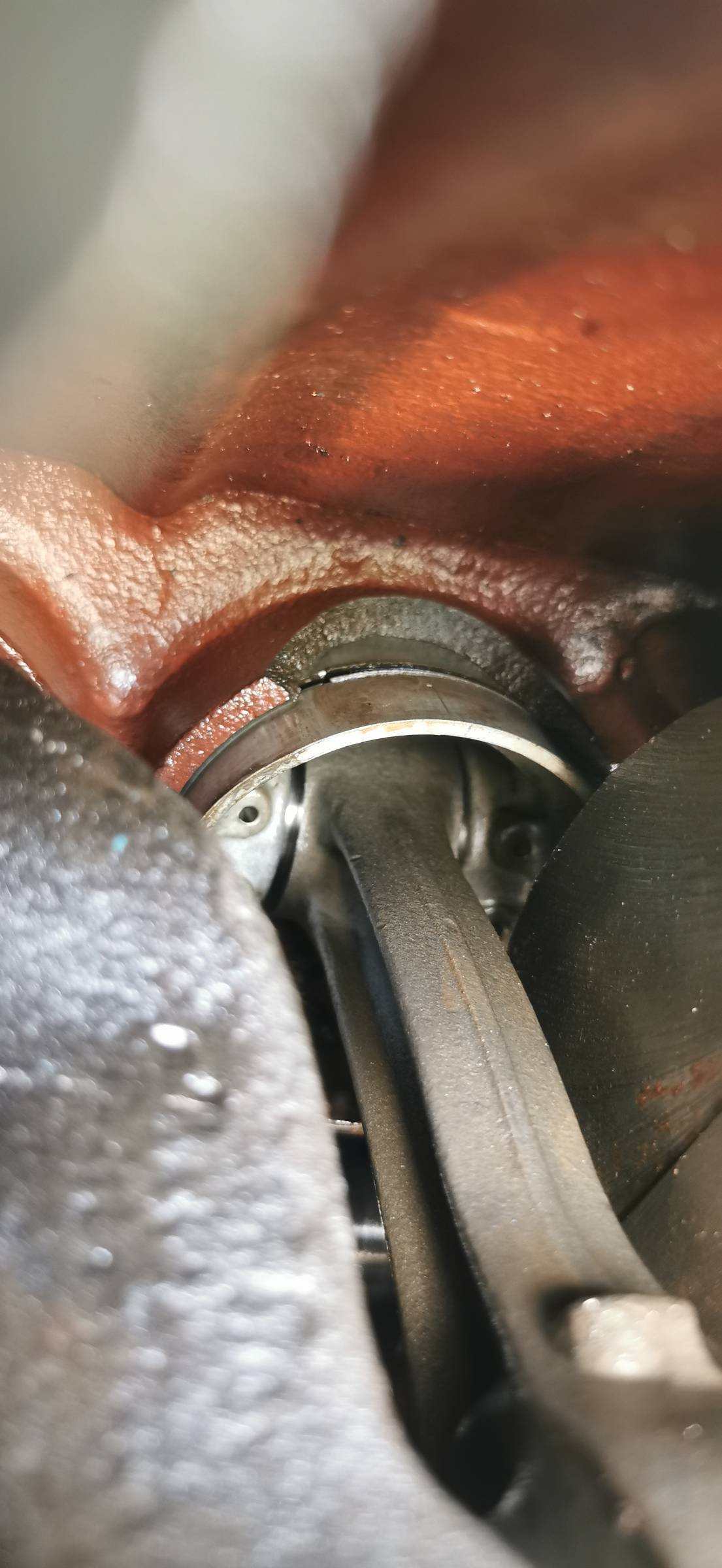

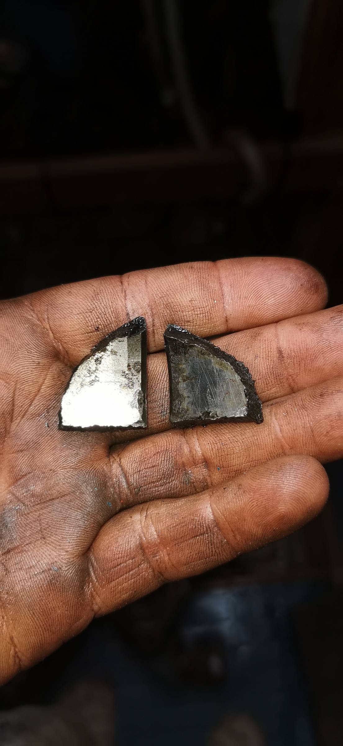

TammHaTamm Posted July 31, 2024 Report Posted July 31, 2024 (edited) Hello, The engine block broke due to water entering the diesel. It bent a connecting rod and broke the sleeve of one of the cylinders. Repair seems risky, so I prefer to replace the block, connecting rods, pistons, crankshaft, etc. Do you think it's possible to find a new block? I don't think this engine is still in production, but I've heard there's an obligation for continued availability. I wonder if that's true. And otherwise, if by chance someone has an old BMC for sale, even for parts, as you might have guessed, I'm interested. 🤞 Edited July 31, 2024 by TammHaTamm
StephenA Posted July 31, 2024 Report Posted July 31, 2024 I don't think there is an obligation for continued availability. The BMC 1.5 has been out of production for decades in the UK, production did continue in India and Turkey but even that has now stopped as far as I know. So the chances of a new block are pretty much zero. I don't know if that damage could be fixed with a rebore and new sleeves - but someone else might know.
Slim Posted July 31, 2024 Report Posted July 31, 2024 I don't think you quite understand the history of your engine. UK production ceased in or around 1955. To expect product support some 60 years later is a little optimistic. Indian production took over for some years but I suspect your chances of sourcing a block are fanciful. Best to contact Calcutts or try e bay. Be aware that rebuilding a scrapper engine is not cheap
MtB Posted July 31, 2024 Report Posted July 31, 2024 BMC 1.5 engines pop up on ebay quite regularly. Buy one to get a block capable of being rebored or you might find one in good enough nick to just drop in and use. Try this for example: https://www.ebay.co.uk/itm/156120304751?
