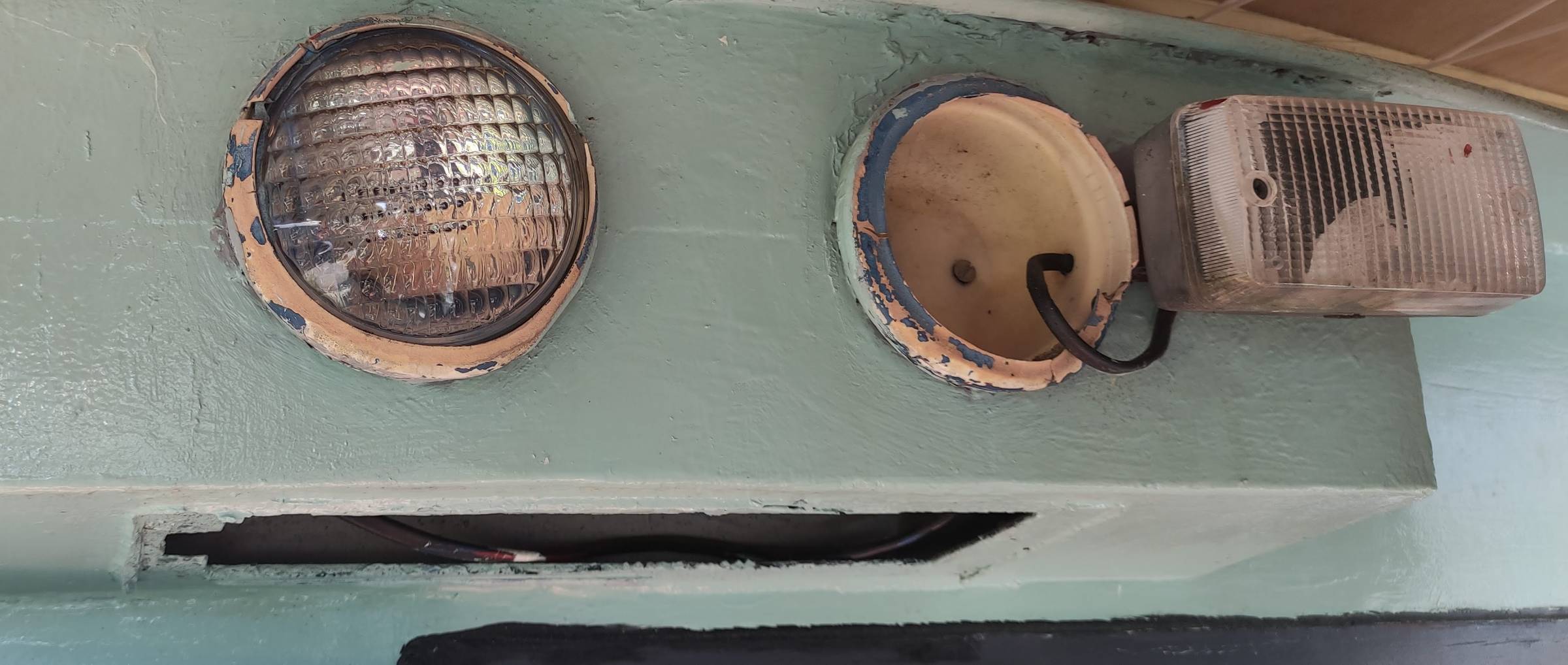

Quick question regarding boat headlights and cable size.
I just ordered these from Amazon: https://www.amazon.co.uk/dp/B07C144KGT?ref=ppx_yo2ov_dt_b_product_details&th=1
They are 4.5 inch 30W Black LED Fog Lights normally used for motorbikes.
The reason I picked these is that they have to fit in the circular mounts at the front of the boat, and these lights look almost identical (in size) to those previously in there. (Theres only one, but not working one left, the other is missing). The mounts are for 2 lights at the front of the boat.
Question is, are these actually suitable, because now that I look at the wiring, and the voltage drop calculator at 12V Planet, it seems the draw is 5Amps (30x2/12) and the cross section for that over a 15m single (30m there and back) cable run (Boat is 17m long) would need to be 6mm^2. Which seems way thicker than the cables that are currently running to the lights, or thicker than any of the 12V cables I've so far found on the boat.
Did I do the calculation wrong, or are these totally the wrong lights?
Photo of the lights attached, but probably doesn't help for the question, just context :)
Edited by Redhawk106
Try them on your existing cable. I very much doubt it will be unsafe at 5 amps unless it is bell wire.
Just checking that, you realise that the 6 sq mm is Conductor Cross Sectional Area, not the whole cable cross-sectional area. As long as the LED electronics don't get upset, the excess volt drop on thinner cable should not prevent them working, possibly at a lower light intensity. 28/0.30mm cable is safe for more than 5 amps (about 17 amps I think), but may cause volt drop, that size is fairly common on boats.
Even 14/0.30 (2.6 sq mm CCSA can safely carry around 8 amps, but that is thin cable and I think you need more strands of thinner area to meet best practice and some regs.
I'd also test them out and see if the beam pattern is to your liking. As they are Fog lights they will have a flat wide beam not well suited as tunnel lights. My boat has one of those round LED tunnel lights and it's amazingly good....the beam is large, round and diffused so perfect for tunnels.
30w of LED lighting will be far too bright, expect every opposite direction boat to crash into you and give you lots of abuse. But at least you will be able to clearly see their rage. Might make a good TickTock video.

Thanks for all the replies. I knew the wattage sounded crazy high, but as they were motorbike side lights I figured they won't be as bright as the main motorbike light, and also figured your boat light needed to be bright. But sounds like it should not be.
Perhaps the voltage drop would indeed then be a good thing and drop the brightness somewhat. Thanks for covering the technical part of the question Tony.
I'm than happy to return these and get lower wattage lights, but it's been quite hard to find suitable ones at a decent price. I just want some lights to fit the existing holes in the mounts, I don't NEED them to be as bright as these are.
Then there's the connectors. Even finding those on Amazon has been tricky as plenty reviews complain about melting and only suitable for low power. I do have some waterproof cable connectors, but seems a shame to cut off the ones the lights came with.
But TL;DR, clearly several people think these are too bright and wrong beam shape. Im happy to swap as long as they are round and 4.5 inch diameter roughly, but struggled to find others so far.
