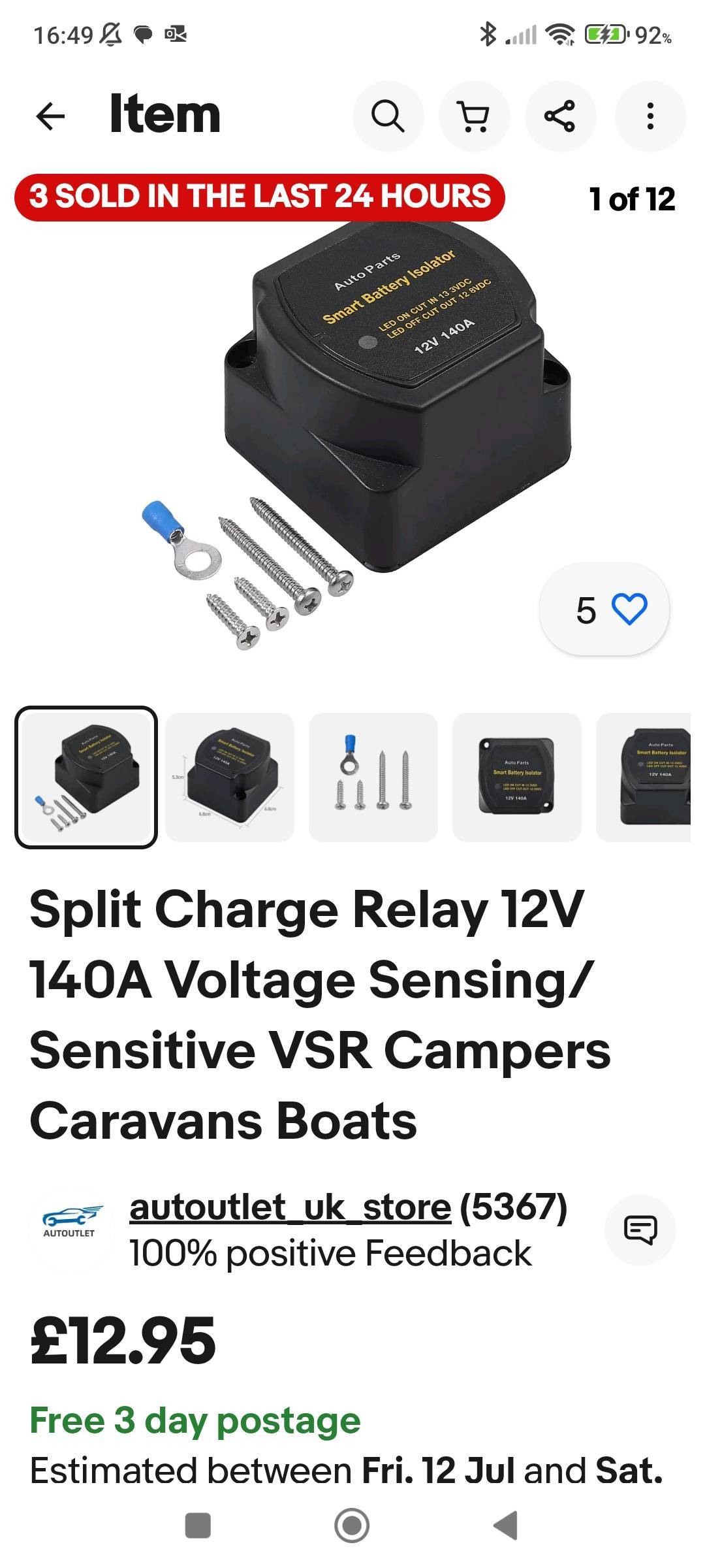

A VSR starts at about 12 quid, they're simple to connect and they don't need testing.
My suggestion to fit a VSR was echoing Tony's. Yes it's a proper job, not a loose solar panel with trailing wires connected by croc clips which is liable to get nicked and isn't actually any simpler at all.
