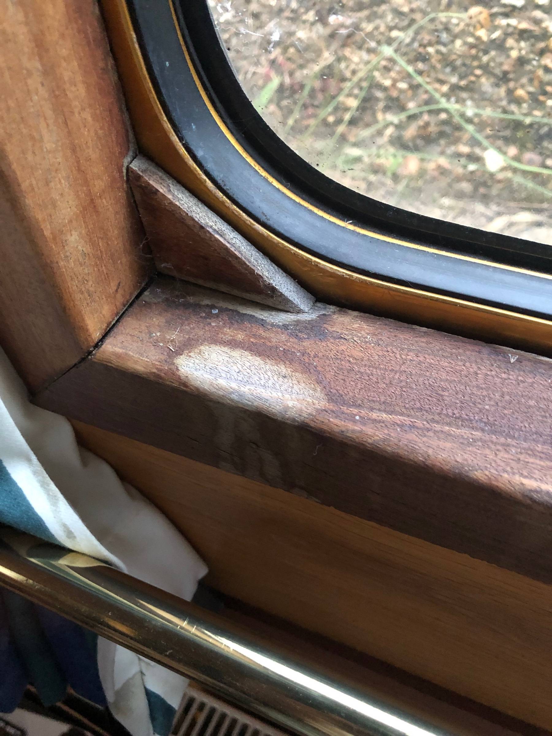

5arahj6yne Posted July 2, 2024 Report Posted July 2, 2024 Hi big boat brain - the wooden window casings inside my boat are looking a bit worse for wear. Can anyone recommend process & products to get em lookin lovely again? Seems like they want stain & oiling rather than varnish?
BEngo Posted July 2, 2024 Report Posted July 2, 2024 Unfortunately water stains like your picture tend to be permanent. The best you can do is probably a gentle sand along the grain with 240 grit then 400 grit, followed by some teak or danish oil. N 1
Higgs Posted July 2, 2024 Report Posted July 2, 2024 (edited) I would double check and do your research but, it's a problem I'm contemplating on a sailboat I have - how to protect the wood. Varnishing seems to be one of the least resistant, and requires regular maintenance. Oils maybe the answer, but It also requires frequent attention. Some use an epoxy resin to first be absorbed, then varnish for visual aesthetics. Oxalic acid can be used to remove or reduce staining. A product called the Barkeepers Friend, sold at Dunhelms, contains oxalic acid. Or, it could be obtained via Amazon. Anyway, I'm still mulling over these options. I have varnished the tiller handle in Schooner. An outdoor varnish. Don't know how it will hold up. Already put on 5 primary coats. Not finished. Edited July 2, 2024 by Higgs
Lady M Posted July 2, 2024 Report Posted July 2, 2024 If you use varnish, please make sure it is NOT water based. You should be able to tell this from the brush cleaning instructions. DAMHIK
Alan de Enfield Posted July 2, 2024 Report Posted July 2, 2024 2 hours ago, 5arahj6yne said: Can anyone recommend process & products to get em lookin lovely again? Step 1 ) Ensure the water leak (source of water) around the windows has been fixed. Or, whatever you do to the wood you will be doing again fairly quickly
Higgs Posted July 2, 2024 Report Posted July 2, 2024 2 minutes ago, Alan de Enfield said: Step 1 ) Ensure the water leak (source of water) around the windows has been fixed. Or, whatever you do to the wood you will be doing again fairly quickly Easier said than done, with condensation, and with no double-glazed windows. I'd be inclined to use epoxy on the lower areas of wood at the window. The wood will be able to resist the moister better.
