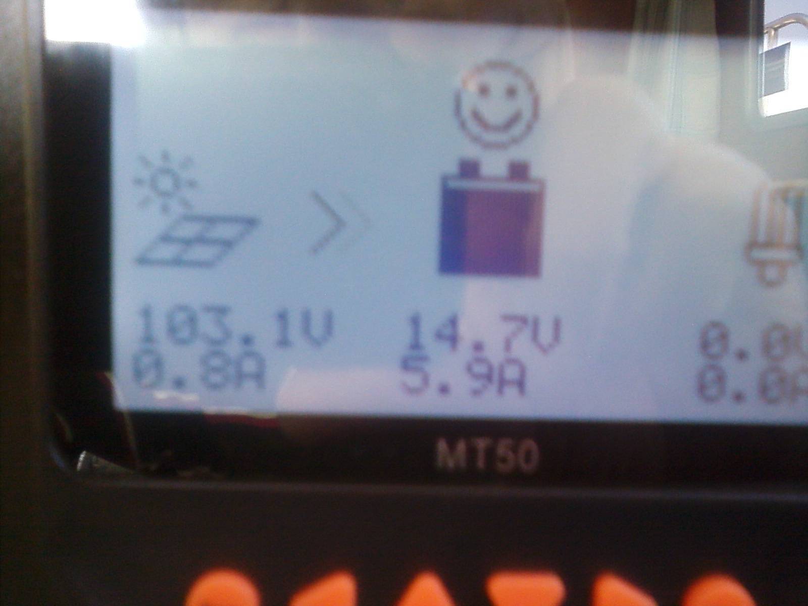

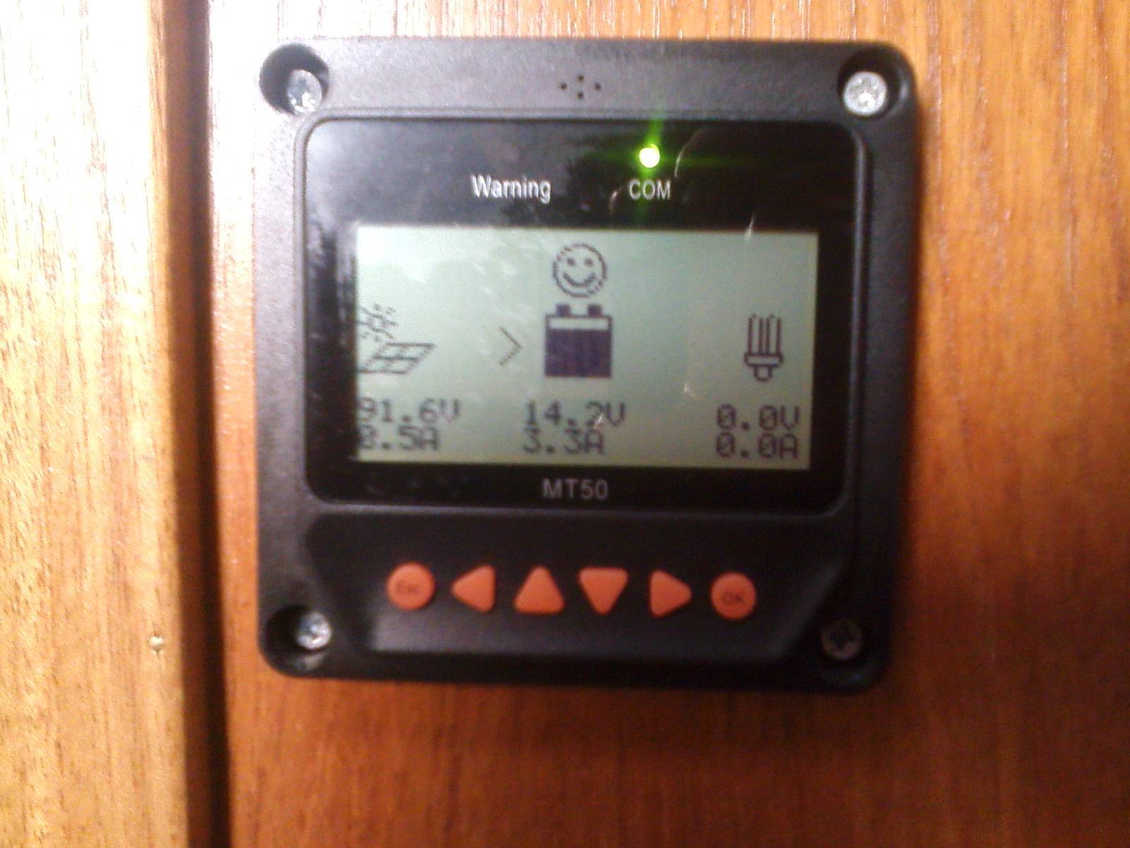

Alan de Enfield Posted July 1, 2024 Report Posted July 1, 2024 (edited) 40 minutes ago, blackrose said: Although there's some useful information in the Victron Connect app, I don't really like having to look at my phone and open an app every time I want to look at what the solar is doing. I know there's a plug in display you can buy for Victron MPPTs - does anyone have one and are they ok because the screen looks a bit small? Not sure what info you are wanting to look at but the MT50 shows solar panel voltage, output in amps, the MTTP output voltage and current - does me anyway. Edited July 1, 2024 by Alan de Enfield

Alan de Enfield Posted July 1, 2024 Report Posted July 1, 2024 3 minutes ago, GUMPY said: I didn't know the MT50 works with Victron kit. That's good news if it does I'm not on Victron, so no direct experience of the interconnection, but, was told it did.
blackrose Posted July 1, 2024 Author Report Posted July 1, 2024 9 minutes ago, Alan de Enfield said: Not sure what info you are wanting to look at but the MT50 shows solar panel voltage, output in amps, the MTTP output voltage and current - does me anyway. I'm talking about a Victron MPPT. They connect to other devices via Bluetooth and can't be connected to a MT50 3 minutes ago, Alan de Enfield said: I'm not on Victron, so no direct experience of the interconnection, but, was told it did. No it doesn't as far as I know. I don't think the Victron has a RJ45 socket for the cable. Anyway I'd still like to see all the other info the Victron supports which can't be displayed by the MT50. 19 minutes ago, GUMPY said: It is connected to the load output of the controller (set to be on 24hrs) through a 12v-usb adapter that I shortened and tidied up. So it's permanently powered even when I switch off the master switch. https://www.ebay.co.uk/itm/355095946664? But why don't you just connect wirelessly over Bluetooth? Isn't that one of the benefits of state of the art victrons?

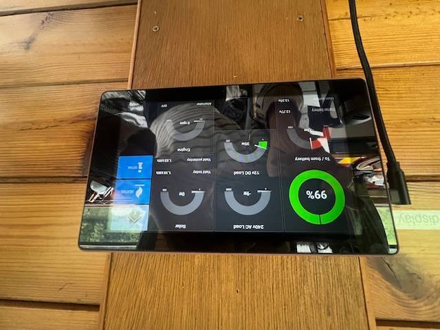

Torblimey Posted July 1, 2024 Report Posted July 1, 2024 12 minutes ago, cheesegas said: The Touch 50 is about £200 RRP, which is about right compared to other manufacturers for a 5" IP rated, outdoor viewable touchscreen. Beetronics and Lilliput do similar non-IP rated screens which are the same price. Do you have a Cerbo? With a bit of Node Red programming, you can have a cheap Amazon Fire display almost anything. I have one on the cabin wall running a kiosk browser which I've got to look like this. All it does is view a web page served by the Cerbo, gives me info on the boat and via a slightly crude relay arrangement, also controls the diesel heater. (yes, it's upside down, yes I've given up trying to make the forum not show it upside down!) Great looking display, I like it 🤔

blackrose Posted July 1, 2024 Author Report Posted July 1, 2024 (edited) 2 hours ago, cheesegas said: Do you have a Cerbo? With a bit of Node Red programming, you can have a cheap Amazon Fire display almost anything. I have one on the cabin wall running a kiosk browser which I've got to look like this. All it does is view a web page served by the Cerbo, gives me info on the boat and via a slightly crude relay arrangement, also controls the diesel heater. I don't even know what a Cerbo is! To be honest I'm just trying to keep things simple and easy. The MPPT has bluetooth and it displays everything on my phone via the app. All I'm trying to do is have that display on the wall rather than (as well as) on my phone. That should be very simple and I'd like to keep it that way, so I don't really want to get involved in any programming. 38 minutes ago, GUMPY said: Make me an offer, https://www.ebay.co.uk/itm/305649685327? I can even configure and set it up for free.😎 Will be up your way after Wednesday I ordered a 10" Android tablet from Amazon a couple of hours ago. I thought I may as well go bigger as I find it difficult to see everything on that app on my 6.7" phone screen. It's also running Android 14 so hopefully it will be futureproofed for a while. If I don't like the look of it or it doesn't fit the space, or the charging cable isn't long enough, etc, I can just send it back for free and get an instant refund. Edited July 1, 2024 by blackrose

cheesegas Posted July 2, 2024 Report Posted July 2, 2024 16 hours ago, blackrose said: I don't even know what a Cerbo is! It's Victron's system controller - basically a little computer running a modified Linux distribution which connects to your Victron MPPTs/inverter etc (and some non-Victron kit too) to aggregate and share data amongst them. There's an active DIY modification scene on the official Victron forums too as it's quite powerful and and can be made to do a lot of interesting things.
