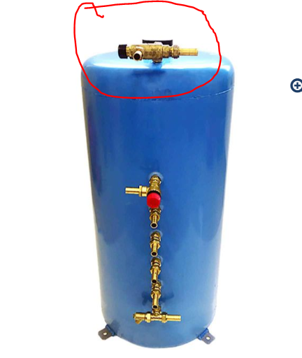

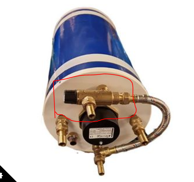

ditchcrawler Posted June 29, 2024 Report Posted June 29, 2024 Mixer valve marked in red, if the bit connected to the tank is hot but the water coming from it cold that's your problem. I have never changed an immersion heater on a boat but done hundreds in houses and often a lot of scale falls off them into the calorifier
