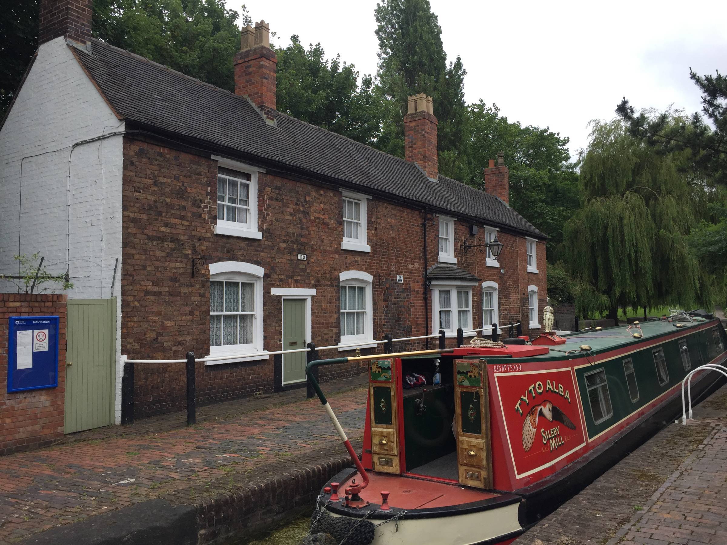

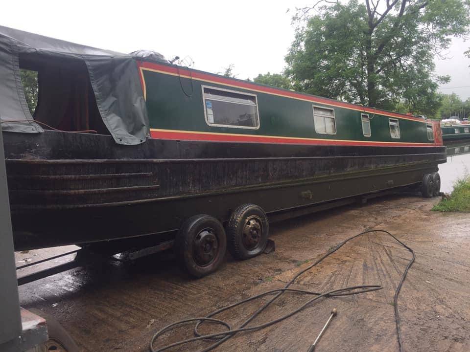

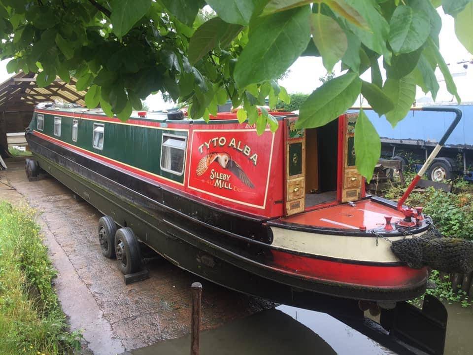

Hi. Here's some photos of the boat in question (also my boat - am @SFen's lesser half). Nice to know where Rugby Boats were (we were in Hillmorton not so long ago), but what we're not clear on is what Rugby Boat Builders were. A hire company? A boat fitter? A number of people have told us that Colecraft built hulls for them, and have suggested that ours might be built by Colecraft. But that just makes the name 'Rugby Boat Builders' a little mysterious, as it seems the one thing they didn't do was build boats! We're also not sure how to identify one. Although lots of people have asked if we're a Colecraft, I can't see a lot of similarities with other Colecraft that have been identified to us, and some Colecraft owners we've spoken to swear blind that ours isn't a Colecraft. We did meet one boat that was the spitting image of ours, and were told that it was built by 'Stephen Goldsborough'. I can only assume that there is a connection between this boat builder and Colecraft/Rugby Boats. Any more details on the history and identifying features would be greatly appreciated 🙂

Doesn't look one bit like a Colecraft shell to me.
Unless they built them differently specifically for Rugby Boats.

Here's a '95 Colecraft boat advertised on the Duck:
Notice the subtle cabin rise at the front, and the less pronounced upsweep at the deck beam and the prow?

I think I recognise that unusually accentuated deck beam and the steep upsweep to it. I just can't think who it was used the build in that style!
Yes, the upsweep at the front is very distinctive. The most similar boats we're seeing a lot at the moment of are Liverpool Boats, but that may just be a function of where we are in the world at present! The very narrow rear deck seems unlike most boats we see around too.
