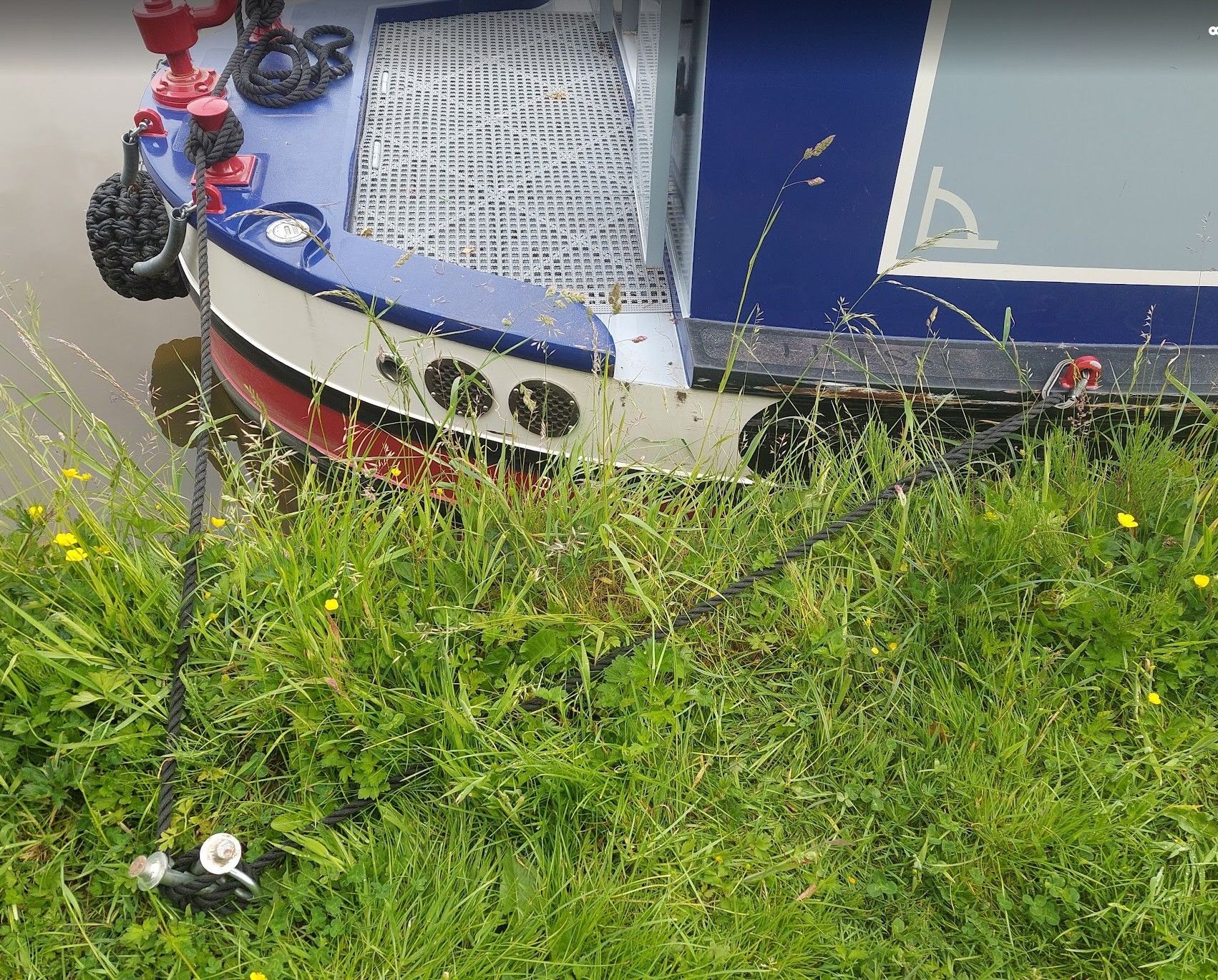

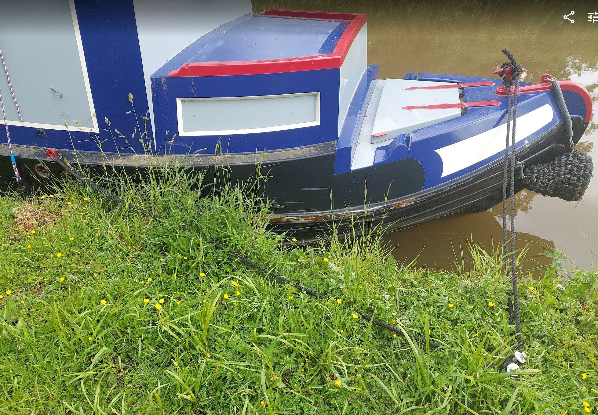

19 hours ago, 5239 said:
here’s a spring line,
the boat don’t match the mooring bollards as I’d like and I don’t want to create a trip hazard at front
simply the black rope is the springer. (And a trip hazard in my case 😃)
normally as you know you tie with a rope going out from the front and back.
but in this case the back rope is longer than I’d like so the springer helps keep the back in as the trip boats pass.

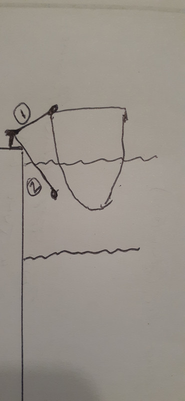

No - just a quick sketch. Hopefully you get the meaning.
If your breast rope is (say) 6 feet long, then the water level can drop , probably about 4 or 5 feet (right angle triangle - hypotenuse again) without  tightening. It will initially get 'looser' as the water level drops.
