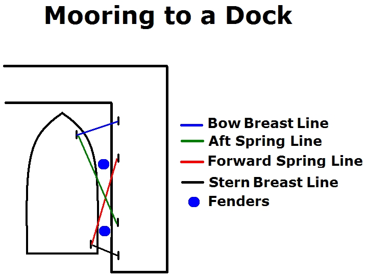

Sorry folks theres been a few references to the word 'springs'. I am not familiar with this term. Can someone enlighten me?
They are longer diagonal lines in addition to the two typical mooing lines - probably called breast lines. The mooring lines run at 90 degrees to the bank, and the spring lines run at a fairly shallow angle from the mounting points on the boat to the fixings on the bank. The spring lines stop the boat surging backwards and forwards when boats go past, and the normal mooring lines hold it against the bank.
Many narrow boaters try to make the mooring lines do both be setting them at opposing angles to the bank, but that only works to   certain extent.

The springs are diagonal mooring  lines which help to hold the boat steady,  for example a boat goes past creating a wash,  or if the wind is gusty.

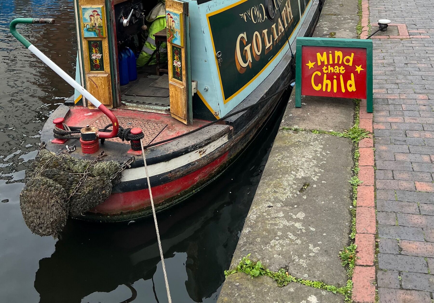

here’s a spring line,
the boat don’t match the mooring bollards as I’d like and I don’t want to create a trip hazard at front
simply the black rope is the springer. (And a trip hazard in my case 😃)
normally as you know you tie with a rope going out from the front and back.
but in this case the back rope is longer than I’d like so the springer helps keep the back in as the trip boats pass.
That's a lovely looking springer you got there. Very shapely.

Breast lines are what many call 'mooring lines' and are used to stop the boat drifting away from the bank
Spring lines are used to stop the boat moving forwards and backwards.
