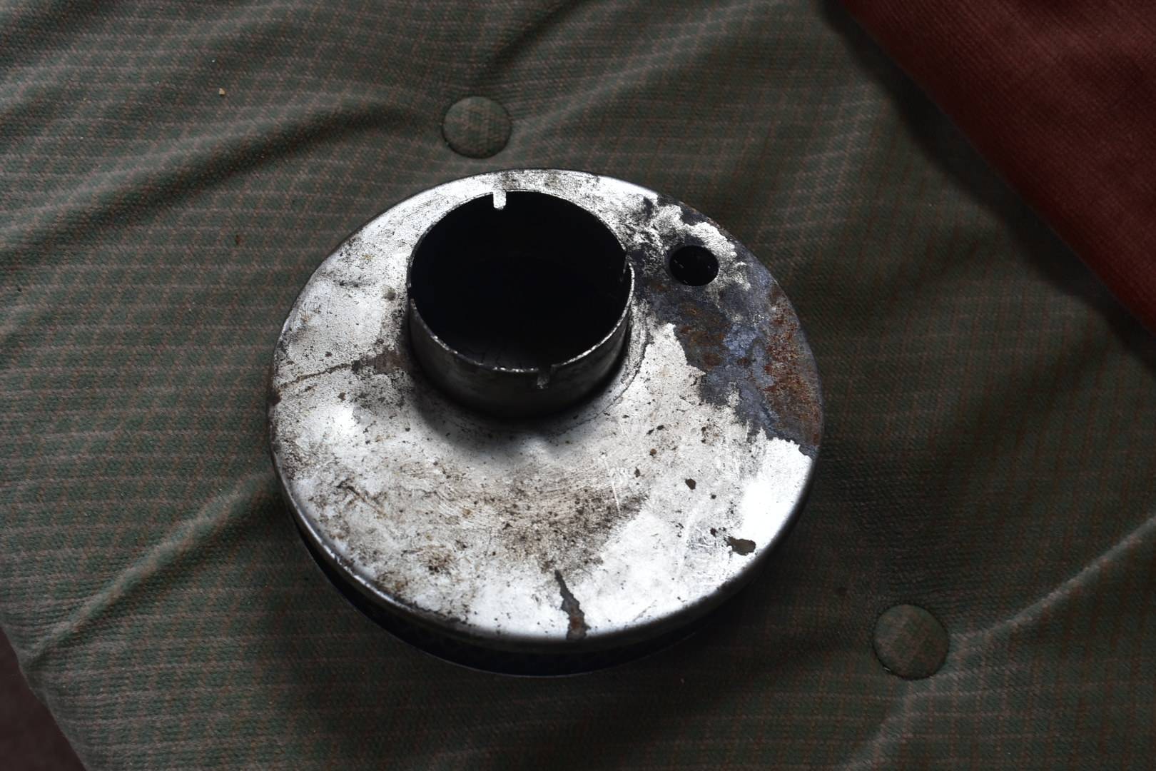

Scholar Gypsy Posted April 20, 2024 Report Posted April 20, 2024 I am trying to find a new air filter housing for my 4 cylinder diesel engine. An old fitment is below. It fits on a 2 inch diameter pipe. (I don't have a pipe that connects to the rocker cover /crankcase). I would prefer one with a replaceable filter, rather than a washable one. This seems a ridiculous question to ask here, but online has not really worked for me yet, and a good chandlery I visited recently said they were having problems sourcing them too, Many thanks!
Tonka Posted April 20, 2024 Report Posted April 20, 2024 Have you tried looking at one for a tractor or similar https://agrilineproducts.com/ Might do one similar 1
Tracy D'arth Posted April 20, 2024 Report Posted April 20, 2024 Something like this K&N air filter. https://www.demon-tweeks.com/uk/k-n-filters-universal-round-tapered-air-filter-244169/ 1

Jen-in-Wellies Posted April 21, 2024 Report Posted April 21, 2024 13 hours ago, Tracy D'arth said: Something like this K&N air filter. https://www.demon-tweeks.com/uk/k-n-filters-universal-round-tapered-air-filter-244169/ Those are washable filters, not replaceable, which the OP is looking for.

Scholar Gypsy Posted April 21, 2024 Author Report Posted April 21, 2024 2 hours ago, Tony Brooks said: The size of the inlet manifold connection will be determined by the engine manufacturer in relation to the air flow required, so there will be a relationship between connection size and required air flow. Another point s that K&N main market is petrol engines, that when tuned, have peak revs of over 6000 rpm. Few, if any, boat type diesels will rev at much over 4000 rpm, so the maximum air volume required will be less on our types of diesels. I suspect the OP may have a BMC 1.5 engine, so there is a good chance he could fit anything from a BMC B series engine, the MG specialists may be able to help, but the exhaust manifold cum header tank may get on the way. Thank you, it's a Mitsubishi K4, so a bit bigger. To be honest the main reason I want an air filter is to stop screws dropping into the inlet manifold, which I believe doesn't improve performance. I do have a K&N at the moment, my main issue is that it can come off a bit too easily, as the rubber flange is not very high.
Guest Posted April 21, 2024 Report Posted April 21, 2024 41 minutes ago, Scholar Gypsy said: To be honest the main reason I want an air filter is to stop screws dropping into the inlet manifold, which I believe doesn't improve performance. If that's all you are after, then buy a silicone hose elbow and point it downwards. Trim it if needed.
StephenA Posted April 21, 2024 Report Posted April 21, 2024 (edited) We have one just like that on Mintball. The iron wool style filling fell apart. We now use strips of green scouring pads fitted round the inside of the casing and just throw them away at regular intervals. If you don't have a crank breather pipe then just block the hole off Edited April 21, 2024 by StephenA 1

David Mack Posted April 21, 2024 Report Posted April 21, 2024 2 hours ago, Scholar Gypsy said: I do have a K&N at the moment, my main issue is that it can come off a bit too easily, as the rubber flange is not very high. Could you fit some sort of adapter between the manifold and the filter housing?
