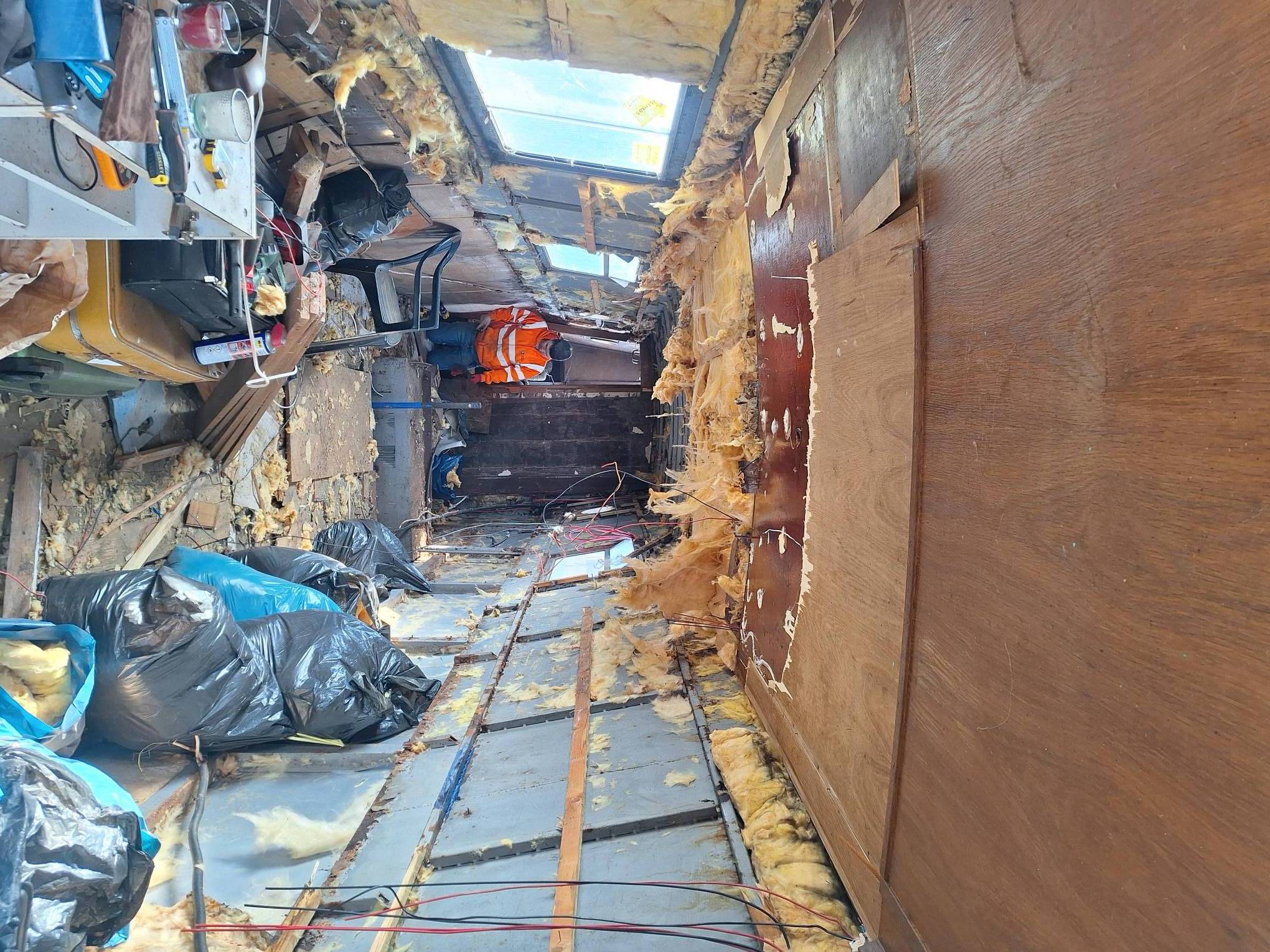

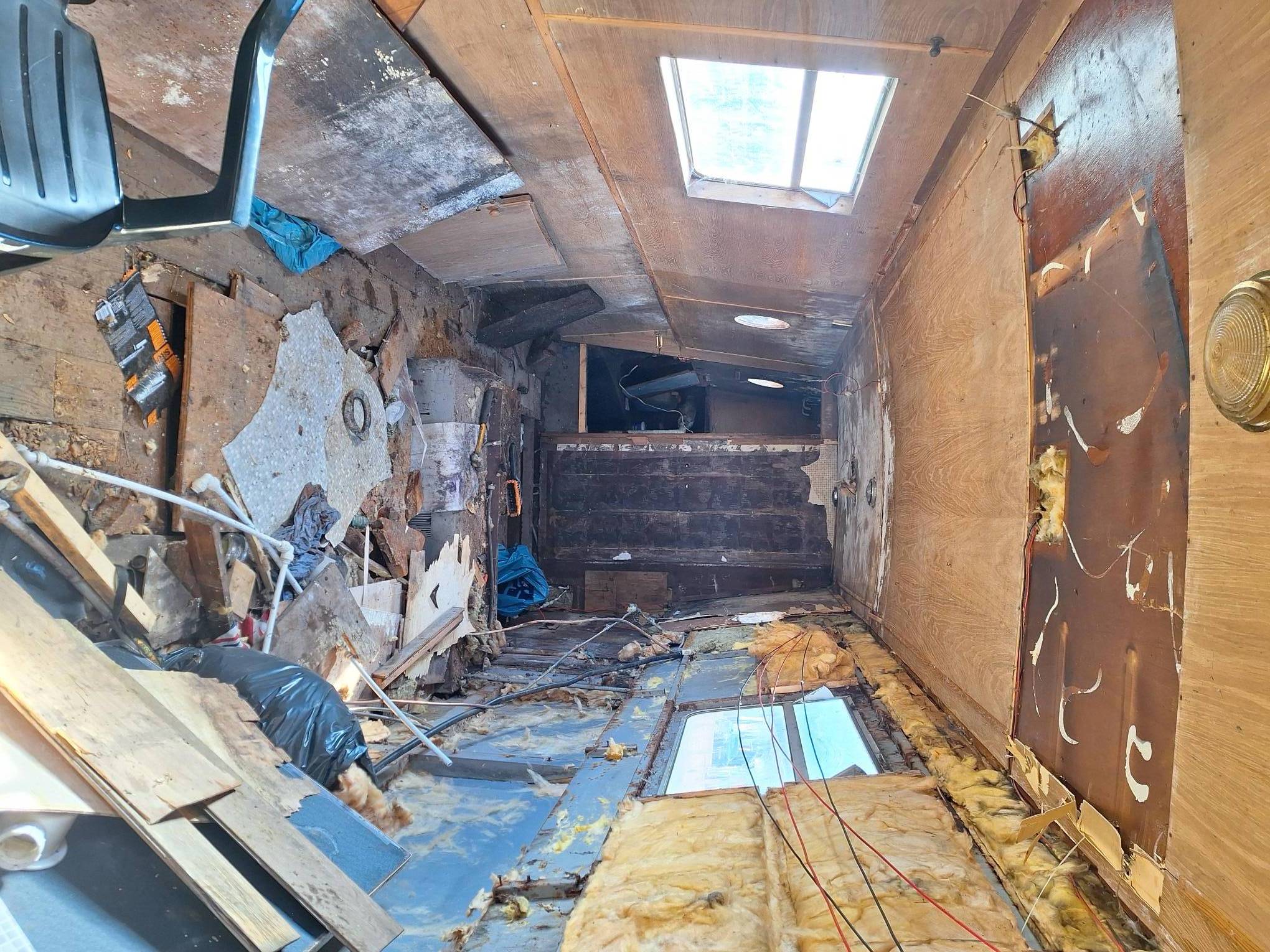

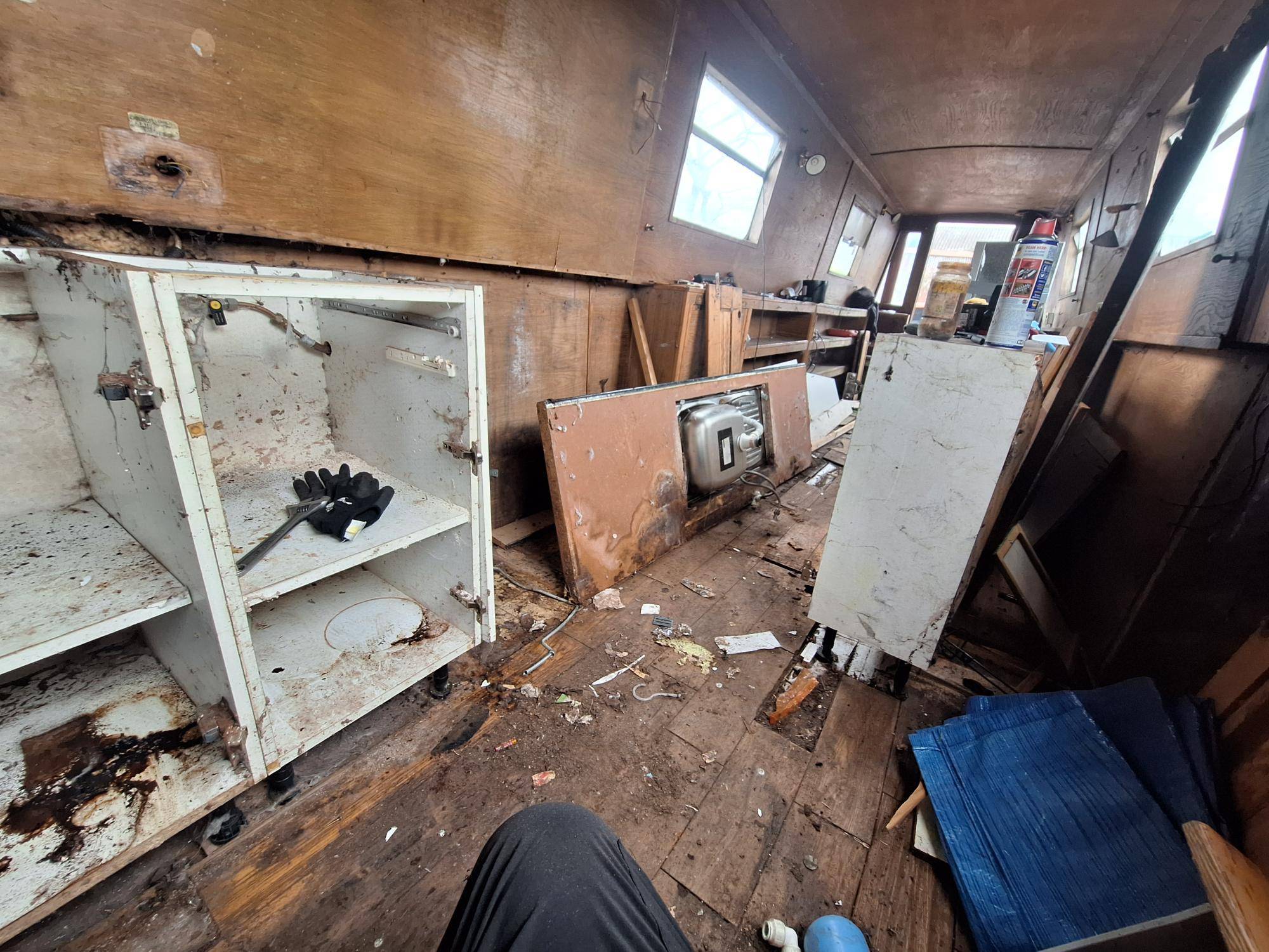

Popular Post Manxcat54 Posted February 24, 2024 Popular Post Report Posted February 24, 2024 (edited) Hi This is the narrowboat which I acquired at a decently cheap price, knowing that it was in need of a hell of a lot of work, I had it brought to our Farm only last Friday, and I have been doing a few hours on it after work, and whenever, it's difficult because I have some spinal stenosis, and can only stand up for short spells. However I am doing quite well, the boat is a 1979 build, we think a Teddesley, it has a Peugeot 504 diesel engine with skin tanks to cool it. I have discovered that the wooden interior had been refreshed at some point by adding a nice decorative pine ply, this was both glued and screwed using very small cross head screws, which were rotten and could not be removed, the ply on the sides is 1/2 inch stuff, held onto the steel with brass screws (flat head type 1979) it's been heavy work. I vomited when I opened the U bend in the sink! anyway that's all history, I have virtually cleared the starboard side back until the engine. I found the easiest way to remove the ply was to locate the securing screw, then using a 30mm hole saw, drill/saw just to one side, thus the panel is released and it leaves a circular piece held by the rotten old screw, which I can just grind off. I had the toilet pumped out by a waste /cess tank guy, it is virtually empty, but I up to now not seen a way of moving it? but some t&g flooring is still trapping it, I was more concerned to find a hell of a lot of rust nearby on the base plate, I removed 3 big sacks of rust and I was worried, however I have cleaned quite a few areas back to solid steel and using my ultra sound tester, it all comes up as being 9.7mm, 9.4mm and the worst one was 9.3mm amazing, but I did see a video on YouTube I think it's narrowboat Precious, and he had similar rust, I have found my rust to be caused by a water leak beneath the shower, which is all now on the bonfire, I hope this makes some interesting reading for someone on the forum, and as you can see from the photo's I have a long way to go. Sorry but 3 of my pics turned sideways, I presume they correct themselves? Edited February 24, 2024 by Manxcat54 6
Alan de Enfield Posted February 24, 2024 Report Posted February 24, 2024 Yes - a lot of work ahead of you but it should be worth it in the end. Don't worry about the sideways pictures, it should right itself when you put it back in the water. Whilst you have it in bits - check the engine. I think the Peugeot 2.3D (as used in the 504) has a cam belt. Cam belts are really a no-no on inland waterways boats due to the limited access they almost never get changed, or even checked. (At 70hp its a pretty big engine for a narrowboat - it is never going to be running efficiently) Replace the cam belt, irrespective of its condition, it could save you having to replace the whole engine in the future (loads of cost and hassle). 1 1 1

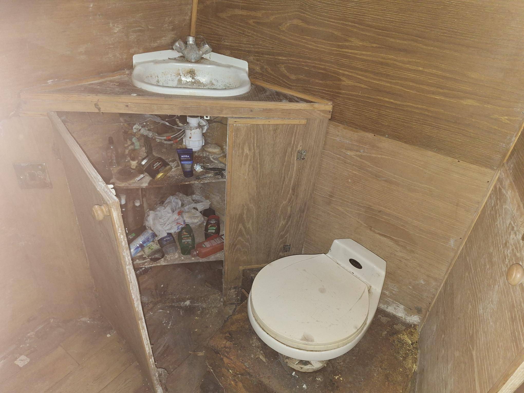

David Mack Posted February 24, 2024 Report Posted February 24, 2024 2 hours ago, Manxcat54 said: I had the toilet pumped out by a waste /cess tank guy, it is virtually empty, but I up to now not seen a way of moving it? but some t&g flooring is still trapping it, If you have a steel toilet tank that is as old as the boat the top will probably be paper thin. I cut mine up in situ with an angle grinder to remove them.
Manxcat54 Posted February 24, 2024 Author Report Posted February 24, 2024 I think I will do that, then see what's left

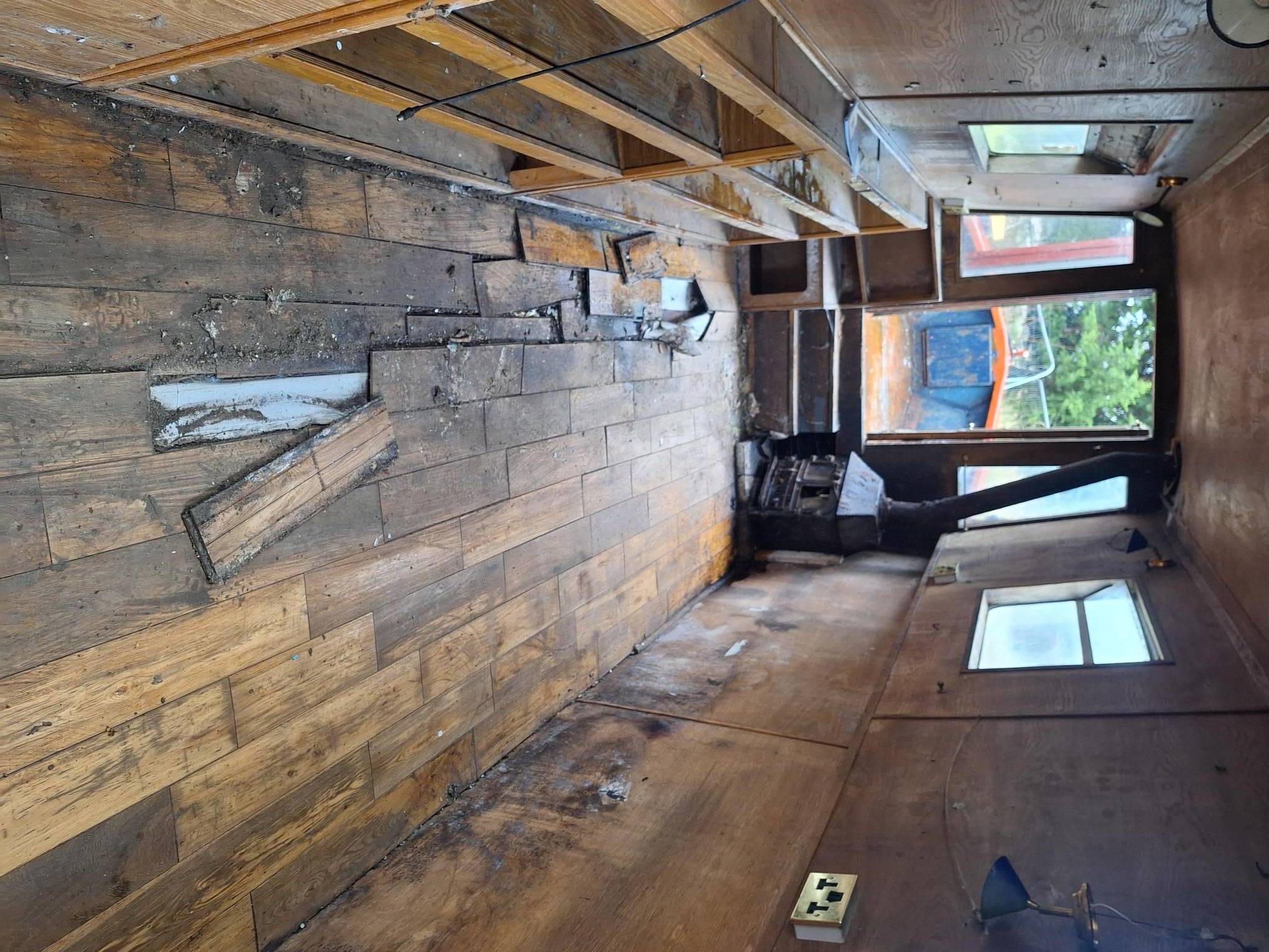

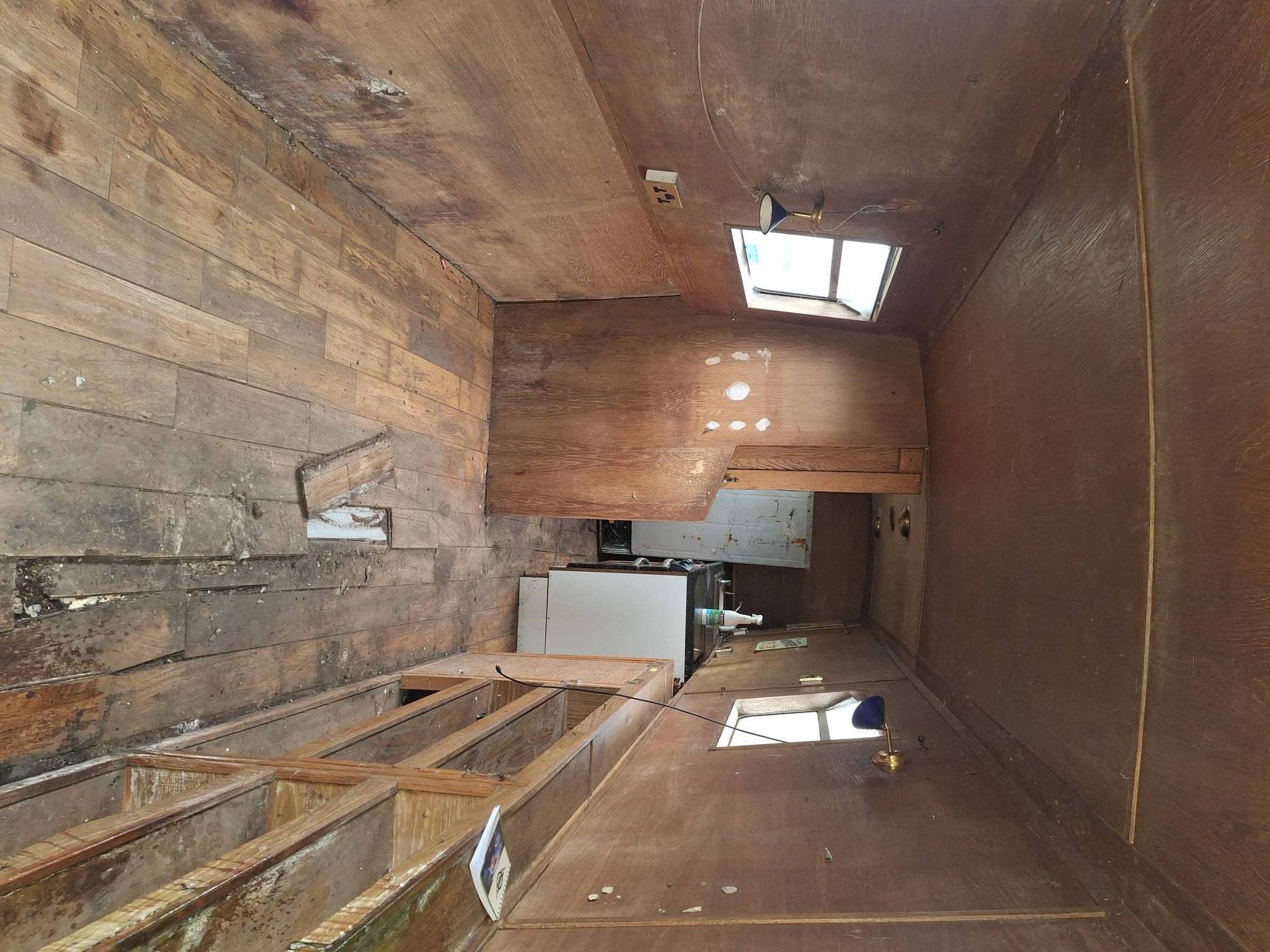

jonathanA Posted February 28, 2024 Report Posted February 28, 2024 just noticed the flooring in your pictures. - that might be worth keeping because it looks like expensive decent solid wood flooring - German I think - can't remember the name. might only be fit for the stove, but if its the stuff I'm thinking of, you could sand that and oil or varnish it and it could be lovely. it looked like there was a fair bit in reasonable condition - just a thought. Good luck and keep posting !
Manxcat54 Posted February 29, 2024 Author Report Posted February 29, 2024 Oh eck too late for most of it, gone to the bonfire, yes it was decent wood, but most of it was rotten. They say a 57 ft boat with ballast should weigh around 13.5 tons, this one was 18tons, probably due to the flooring and 1/2 inch solid 1970s ply on the walls, I think I have now lightened the boat by at least 3 tons. 1

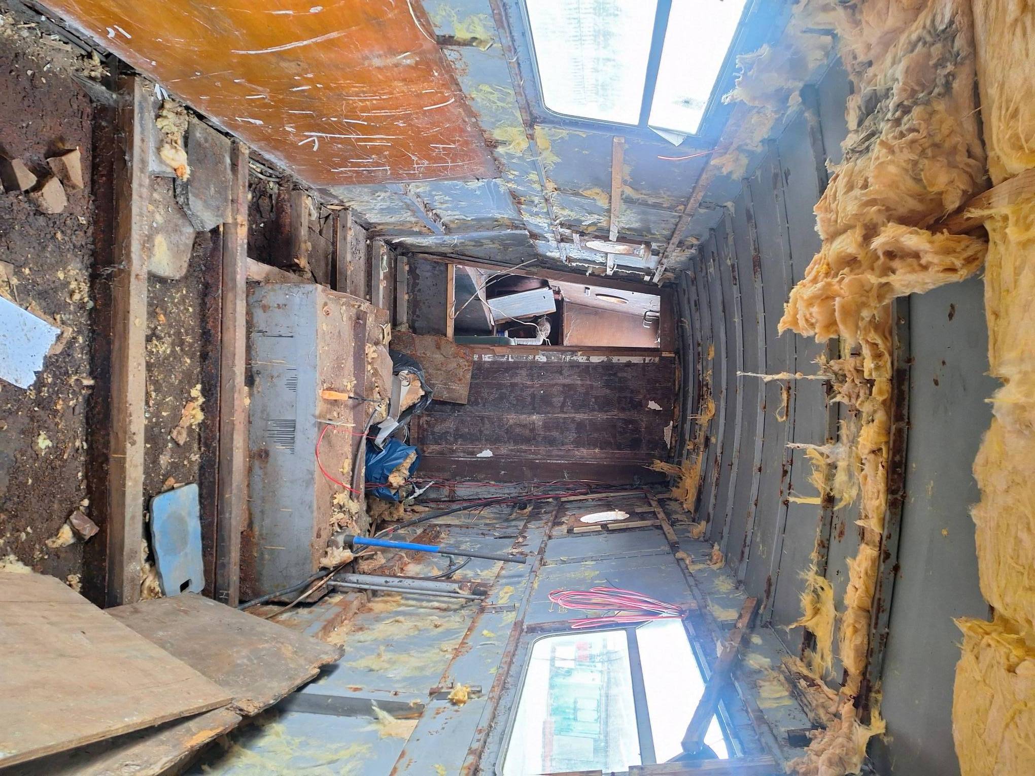

Manxcat54 Posted March 3, 2024 Author Report Posted March 3, 2024 On 24/02/2024 at 22:03, truckcab79 said: Lovely. Keep posting. Love to see a build project. 👍 Sorry but I am so tired and I cannot make my images spin correctly, been on the boat all day, very hard graft and that insulation is the pits, but we are moving on slowly, nearly half the boat stripped, all the wiring is ripped out and a few bits and bobs corrected, I am hoping by this time next weekend we will be ready for some paint on the inside.
Alan de Enfield Posted March 3, 2024 Report Posted March 3, 2024 Just in case you are not aware - there appears to be some grey 'flat twin & earth' domestic wiring cable - this is not allowed to be used on boats. Ensure when you rewire you use multi-strand flexible cables / wires ONLY.
David Mack Posted March 3, 2024 Report Posted March 3, 2024 (edited) 15 minutes ago, Alan de Enfield said: Just in case you are not aware - there appears to be some grey 'flat twin & earth' domestic wiring cable - this is not allowed to be used on boats. Ensure when you rewire you use multi-strand flexible cables / wires ONLY. Not on new boats as I understand it, and not advised on any boat. But it is technically permitted and would not be a BSS failure. Edited March 3, 2024 by David Mack 1
Alan de Enfield Posted March 3, 2024 Report Posted March 3, 2024 2 minutes ago, David Mack said: Not on new boats as I understand it, and not advised on any boat. Not to be used on any post 1998 boat, and advised not to be used on any boat. When you are going back to a bare metal rebuild surely it is best to use current 'best practice'.

truckcab79 Posted March 4, 2024 Report Posted March 4, 2024 (edited) 4 hours ago, Manxcat54 said: Sorry but I am so tired and I cannot make my images spin correctly, been on the boat all day, very hard graft and that insulation is the pits, but we are moving on slowly, nearly half the boat stripped, all the wiring is ripped out and a few bits and bobs corrected, I am hoping by this time next weekend we will be ready for some paint on the inside. Very satisfying. Nothing like ending the day physically exhausted from your hard work. 👍. Looks great. That insulation is horrible stuff. Makes me glad that the only insulation I’ve had to deal with on our ripout is some ridiculously thin polystyrene. Fibreglass / rockwool just seems like a recipe for disaster in terms of holding moisture (if it gets in), though yours seems fine. With regard to the following posts get yourself a copy of the regs and work to it yourself to make sure that you’re happy that your build is compliant for your next safety cert. Far more sensible than trusting some random on a forum to tell you how it should or shouldn’t be done. Edited March 4, 2024 by truckcab79
jonathanA Posted March 4, 2024 Report Posted March 4, 2024 It's got to get worse before it gets better ... . In terms of 'Regs' it's the BSS boat safety scheme that you need to meet. Make sure you look at the private boat version. Using domestic T&E isn't a fail but not recommended. Its awful stuff to use on a boat anyway.
