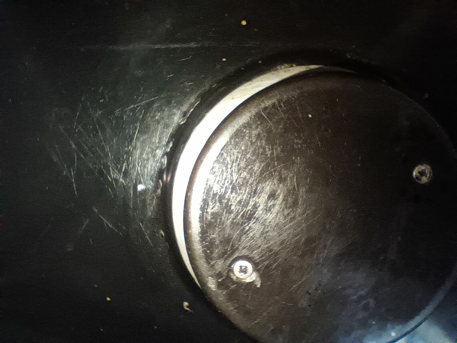

PS of someone can tell me how to get the s/s threaded bolts off the burners, I can just service the burners , buy a new chrome grid and live with this cooker.
It's about a year since  they were inserted, so it's not going to be corrosion.
I have tried all my cross screwdriver things, but I think they are getting knurled., and only the original brass one retracts.

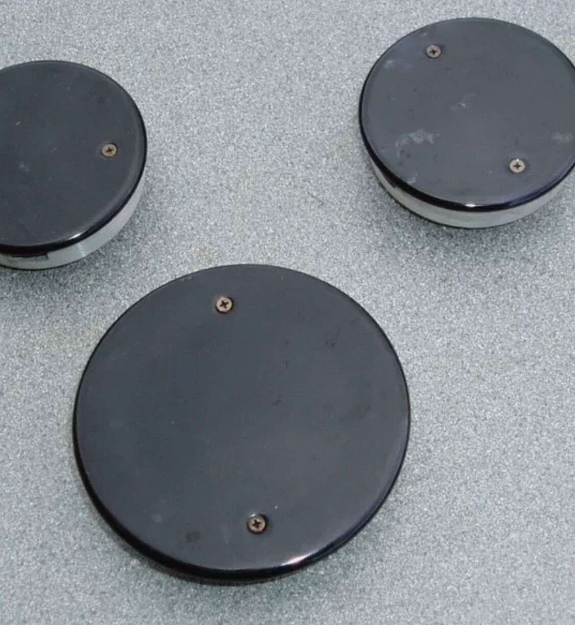

Which bolts - do you have a picture?
They are the two tiny threaded bolt things that hold the flame spreader on to burner, tiny. Machine screws with cross heads.
The originals were brass, one is still there, l can get it out.
I am afraid to attempt any more with the s\s as they are too small to drill out,

20 minutes ago, BoatinglifeupNorth said:
I think they are these ones:
That's the ones I assume LadyG is referring to, same as on my Caprice 2020. I can only say there was no trick to getting mine undone (reduced flame from the rings turned out to be due to a load of rust flakes from the black top blocking the gas), except that quite a few have worn to the point that no screwdriver can gain purchase on the head now. WD40 might help if they're not too far gone...

I am sure that those are the ones. I think one of the problems may be a lack of practical ability. I am sure that I used a hammer on the screwdriver (or a flat punch) to shock the screws downwards a few times and also put as much of my wight onto the driver with a pair of grips around the thin part of the handle and worried some out. I also wonder if LadyG knows the difference between a Philips and Pozidrive cross heads. If you don't match them, the driver is likely to twist out of the slots and damage the head.
The one s/s threaded  machine screw that came out is dry, but though the head is intact I still can't tell which screwdriver I should be using , all candidates turn that machine screw, sigh.

I have about two dozen screwdriver heads, including sets of tiny ones ,  somewhere there will be the correct one, certainly managed to get the brass one out easy
but I don't know what I am dealing with.
I have tried all my small ones that are actual screwdrivers, that look pointy.... about three of them, but none of the screws stuck in the burners have turned.
I'll just try some thin oil, but I doubt if anything will penetrate . I dont even have three in one .
It's impossible to tell what they are from my screw drivers, all three candidates will turn the screw which does turn.

I think they might be Phillips I just can't be sure, they have been in place for a while, and of course cleaned most days
I've tried a torch and magnification, none of the heads are perfect,, they are all chewed to a degree.
Most of my screwdrivers are rusty Phillips, chewed up and used for paint stirring by the look of it, I do have some unused small sets,
Looking at the online images, I can not see the fur little lines that form a start between the Pozidrive slots so that suggest that you are correct, they are Philips.
I doubt thin oil will help much and that goes for Plusgas penetrating oil if applied to the top of the burner cap, it needs to be around where the screw goes into the aluminium burner housing.
You need to try to shock the threads a bit, I would use an old screwdriver and hammer to strike downwards onto the screw a few times, but be gentle because the burner assembly is only fixed to some thinnish pressed metal.
If you can find a bit or screwdriver that seems to fit the slots in the screw, you may find it helps to put something around the base of the handle to act as a lever and bear down with as much force as you can muster. Start to try doing it UP a little, then undo a little, do up, undo and repeat. I try to put my chest on top of the screwdriver, steadying it with one hand while using the other had on whatever you have put on the handle.

Ok, ty, I'll wait for a while, might try pipe cleaners if those are available, not urgent, thanks all.

Those images are not mine, I have not managed to get my photos  uploaded.20230919_183427.jpg.1fd96a62a8628445ea9ecfe210110bca.jpg
It's not urgent, and I suspect someone with more strength could manage better than I.
