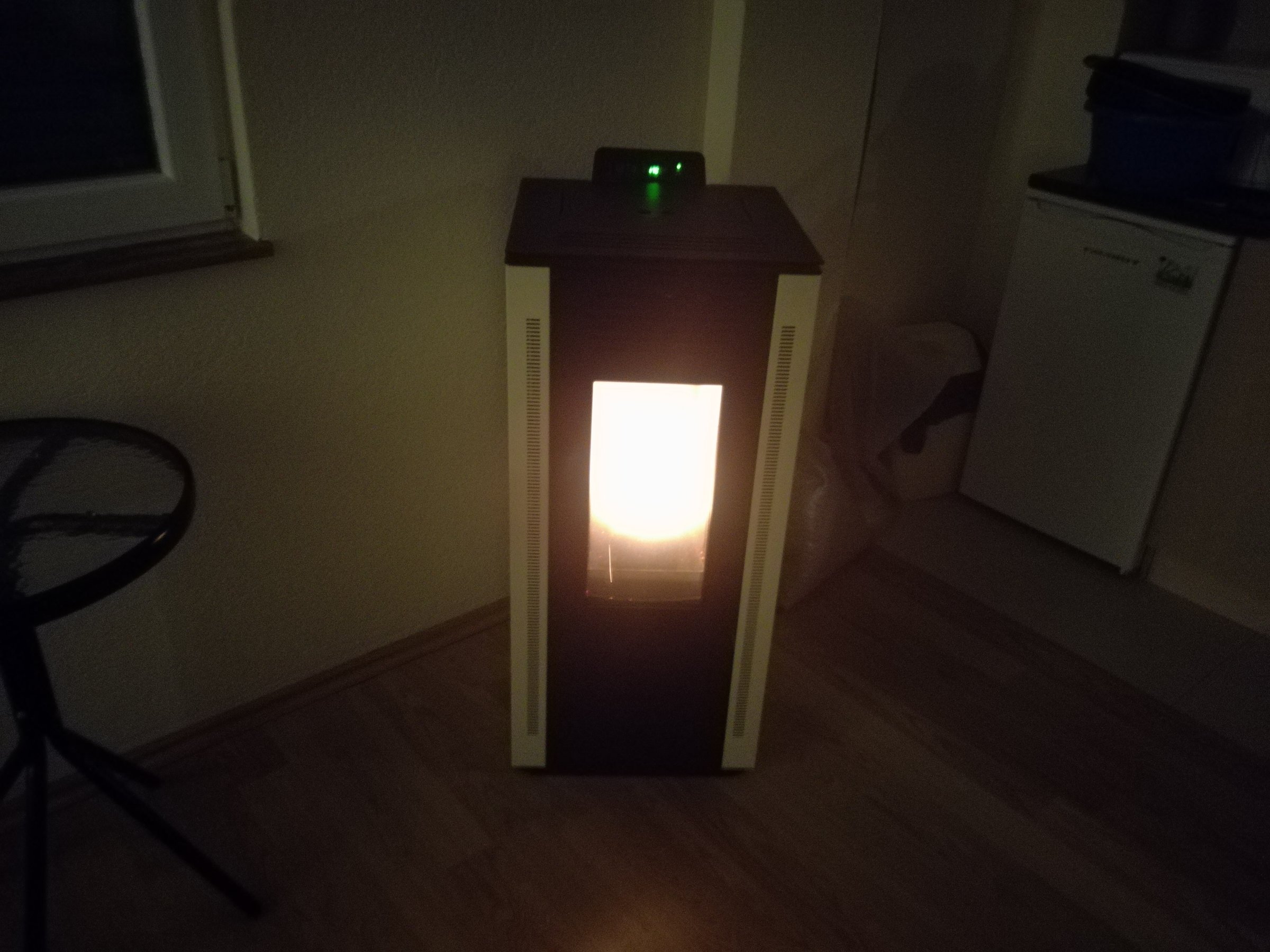

IMG_20170117_214154.jpg.3566d64c17d6fa6dfafb165566b97a54.jpgI have one in one of my apartments, 12kw rating, eats a 15kg bag of pellets a day easy, still get dust when filling the hopper and emptying ashes, looks nice and smells nice too. If you get a power outage the boat will get smokey in an instant.
