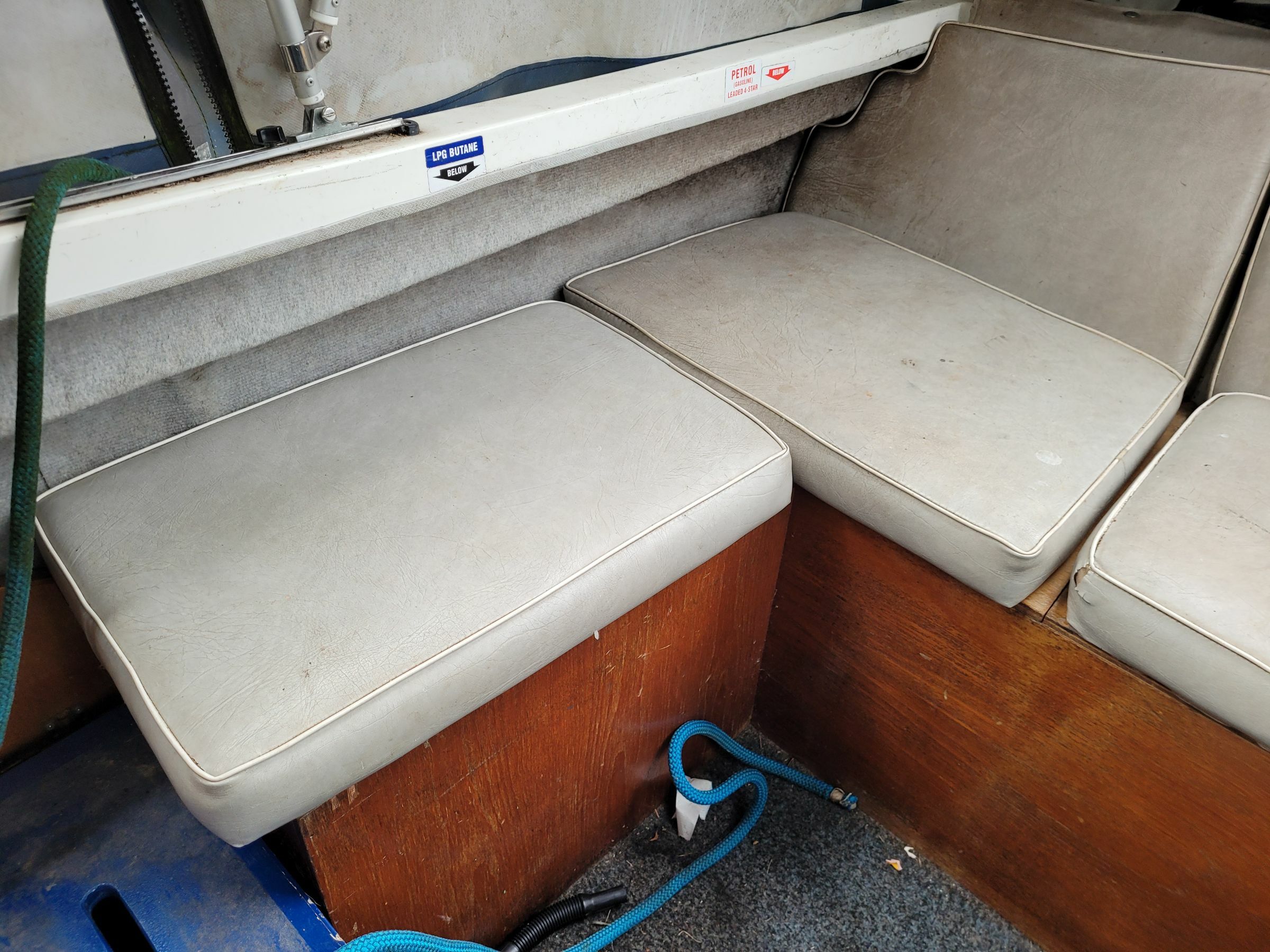

Just thinking aloud really - you all know the problem, Juno's gas locker was built for small dumpy cylinders that Calor are now declining to replace.

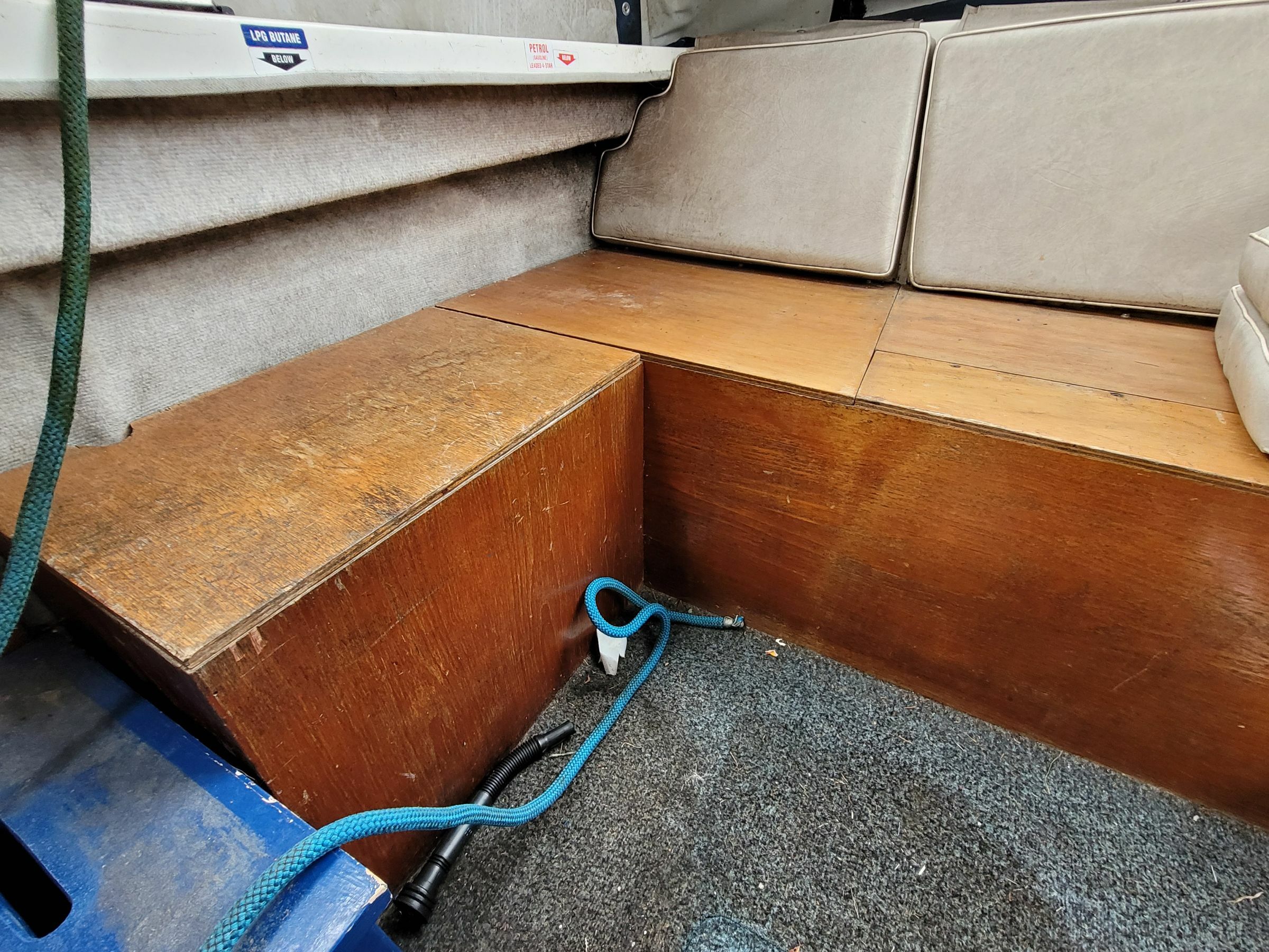

the gas locker is the left-hand end of the bench seat20230901_174608.thumb.jpg.ebf592089d24d7ae9d34512300b05db7.jpg

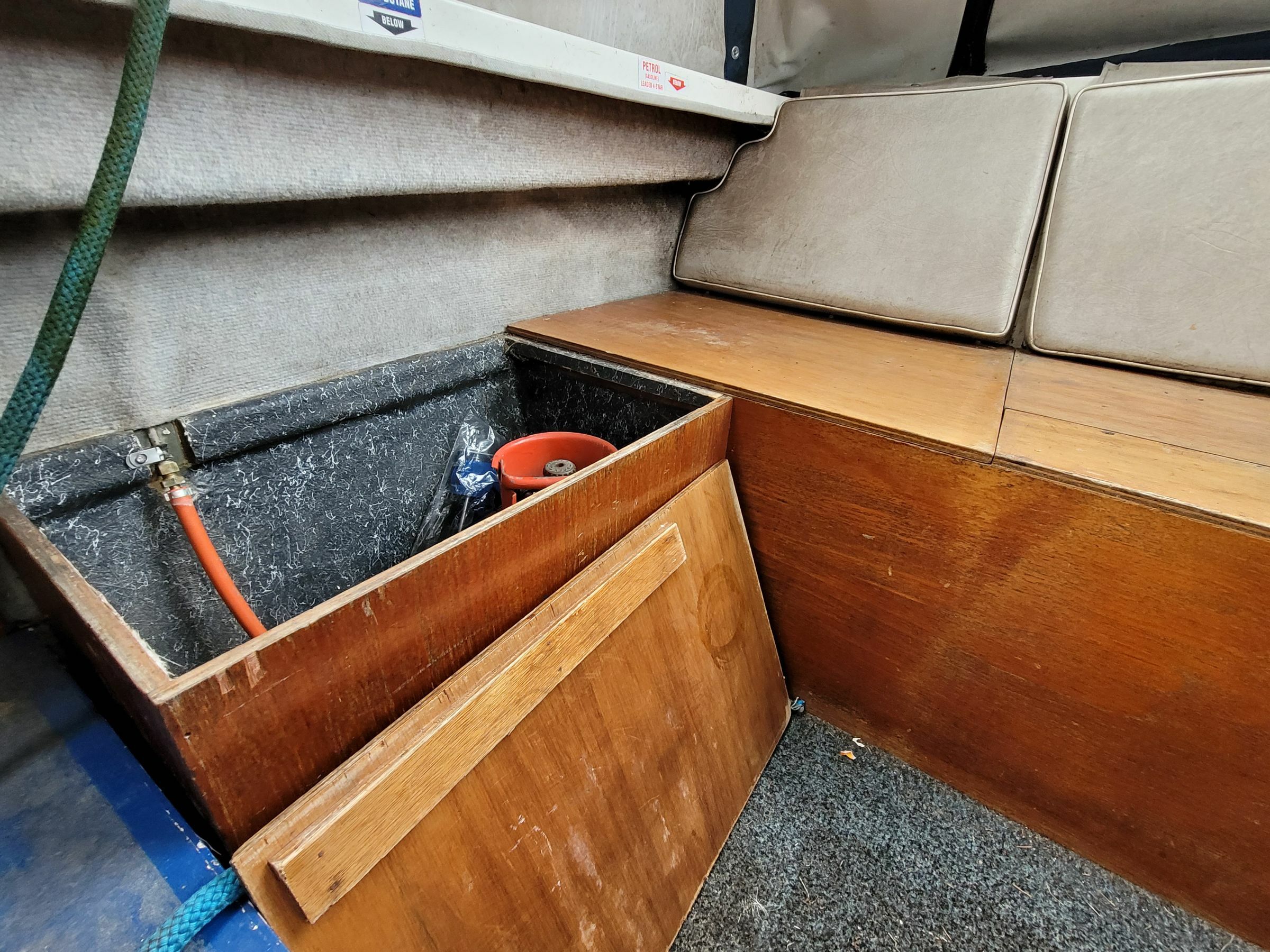

As shown here. That's the top of a 3.9kg Calor propane cylinder. A 6kg is too tall, and a 5kg patio gas cylinder is too wide although it would fit height wise.
So the question is whether to increase the height of the locker or whether to make it wider.
the increase in height would be about the height of the cushion over the next bit of the bench. Not drastic but not ideal - there would be a step in the bench which could be addressed visually by leaving the cushion off the gas locker but practically you couldn't sit in the corner.

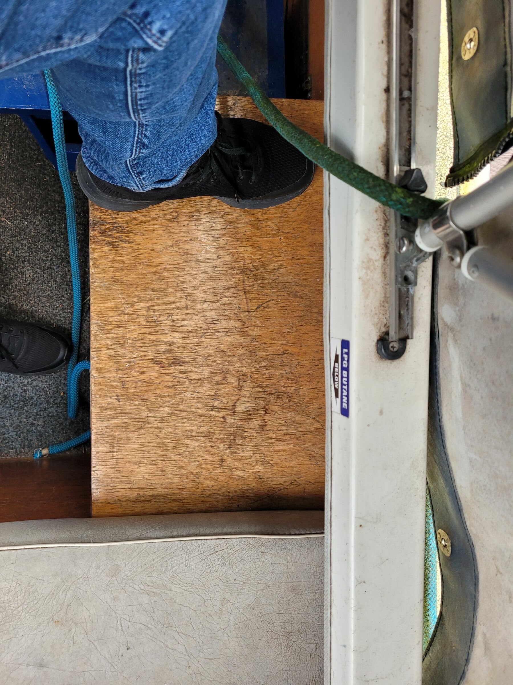

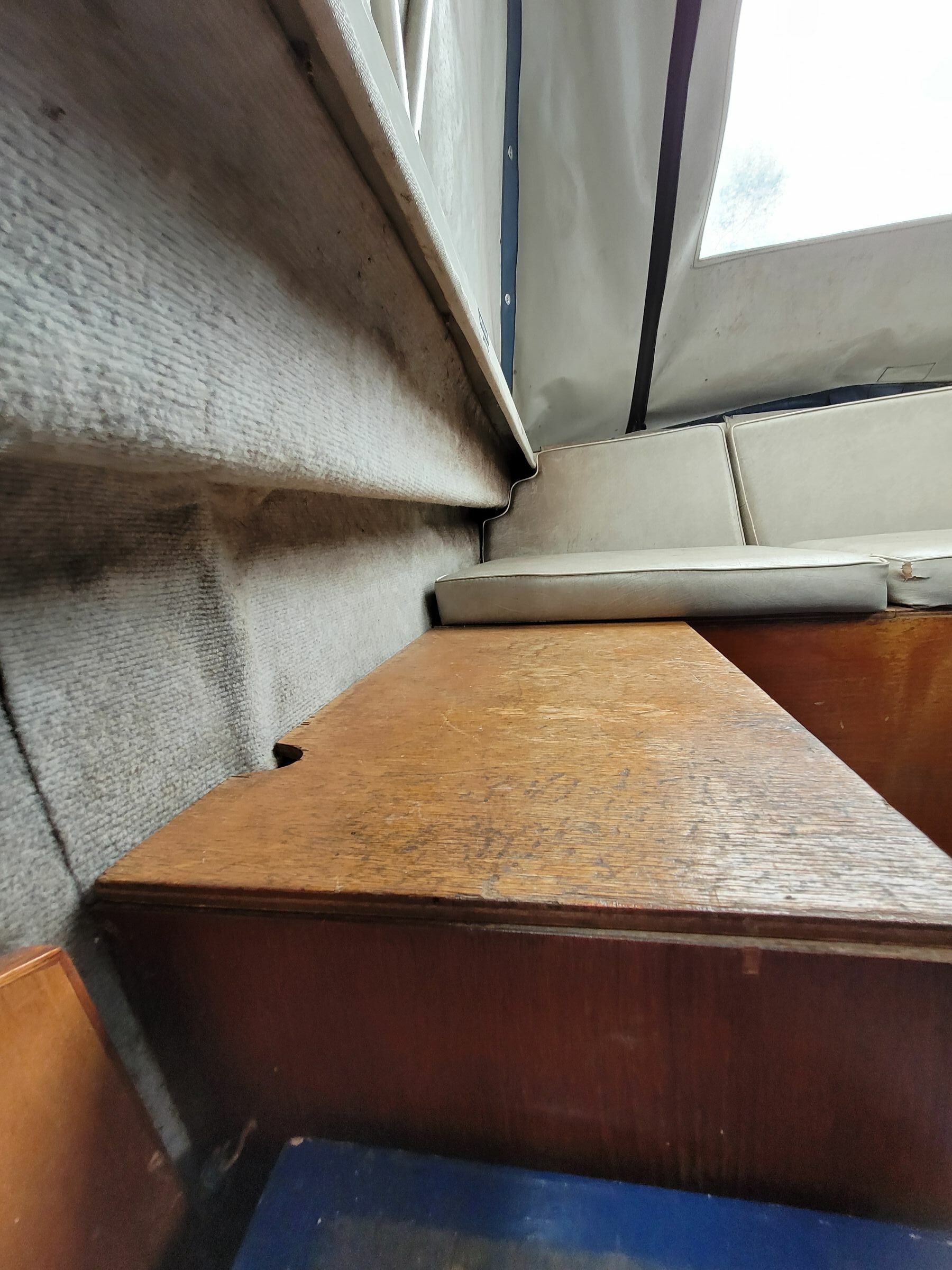

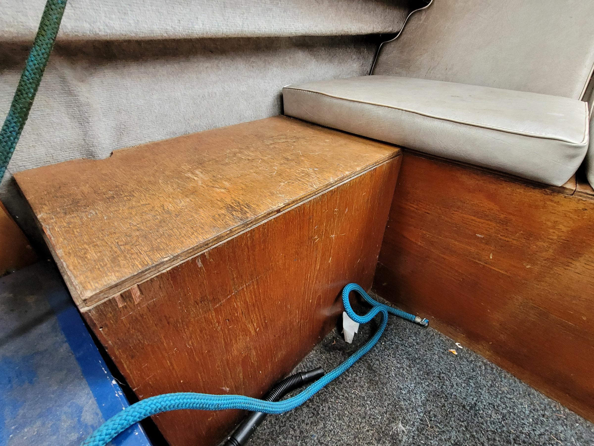

The gas locker gets more use as a step than a seat - It's quite narrow as it is partially under the gunnel as the photos below show 20230901_174715.thumb.jpg.9825adfb0893be586133f9050359f894.jpg20230901_174657.thumb.jpg.3b04c57a41eeb360ce9b1e733268b137.jpg20230901_174731.thumb.jpg.e4024bb385c70ff2dcd458d226b596cd.jpg

What about extending the locker out widthways at an angle? You'd only need to make one new locker side and a new lid. I think that's less work than extending it up higher on all sides.
Edited by blackrose
I'd modify it to fit the Calor 6s. They are the same diameter as the 3.9s.
Thanks all - I like the lateral thinking of @blackrose which runs well ahead of increasing the height of the locker. It's that or a cage on the transom.
