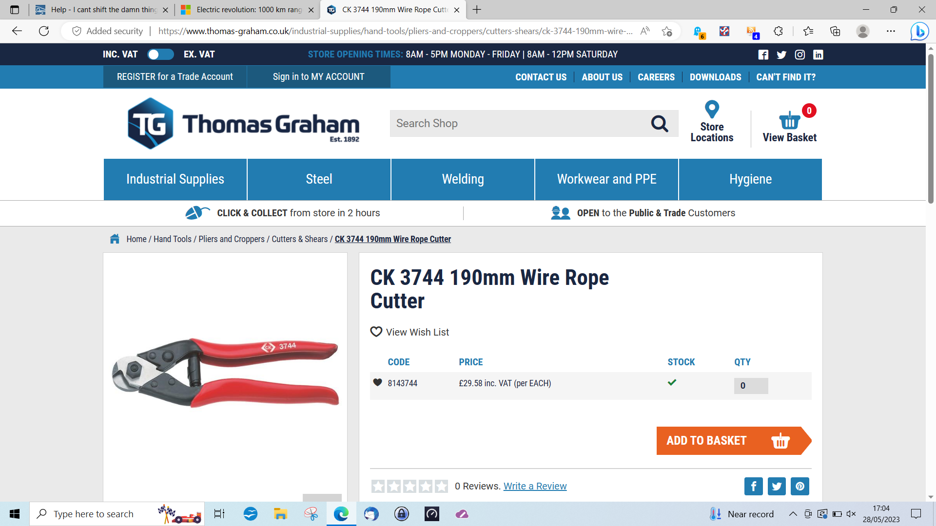

The trouble with bolt croppers is the wide ness of the handles when the cropper opens make it difficult to make some of the cuts needed as weed hatches are usually narrow bow to stern So except for a side cut 90 degrees from the propshaft access is usually hard. The  spring wires are at different angles. Also each cut takes a while to get to find with hefty croppers  and you need to ideally guide the croppers in to get at each  wire you’ve  found.
 The ones @ditchcrawler has posted are brilliant, maybe tie a piece of elastic round the handle and a loop round your wrist to stop them being dropped whilst cutting.
Mattresses often have a thick surround wire top and bottom that seem to  need hacksawing off first. Try to clear fabric off where possible, breadknife can be handy for that. We found pulling the mattress by hand away from the stern with a rope round  a part not wrapped round the prop puts tension on areas to concentrate on cutting and as each important wire comes off the next one needing cutting becomes apparent . Try tension from different angles as that seems to make a difference. Aim for the most tense smaller wire from the springs as that’s usually the ones most likely to be twisted round. Don’t despair and keep cutting. Many cuts  will make no difference. Try also to pull the wires over the prop blades and concentrate cutting ones that won’t go over
