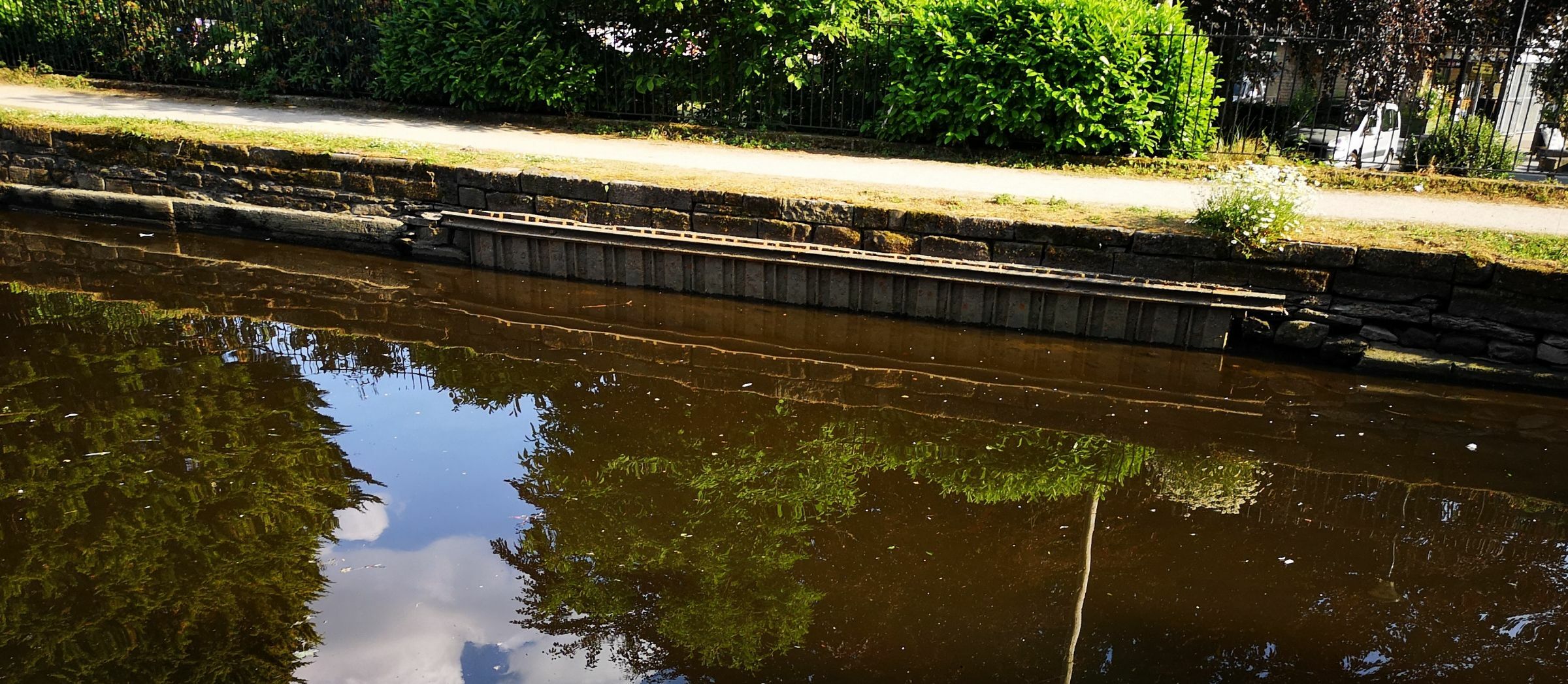

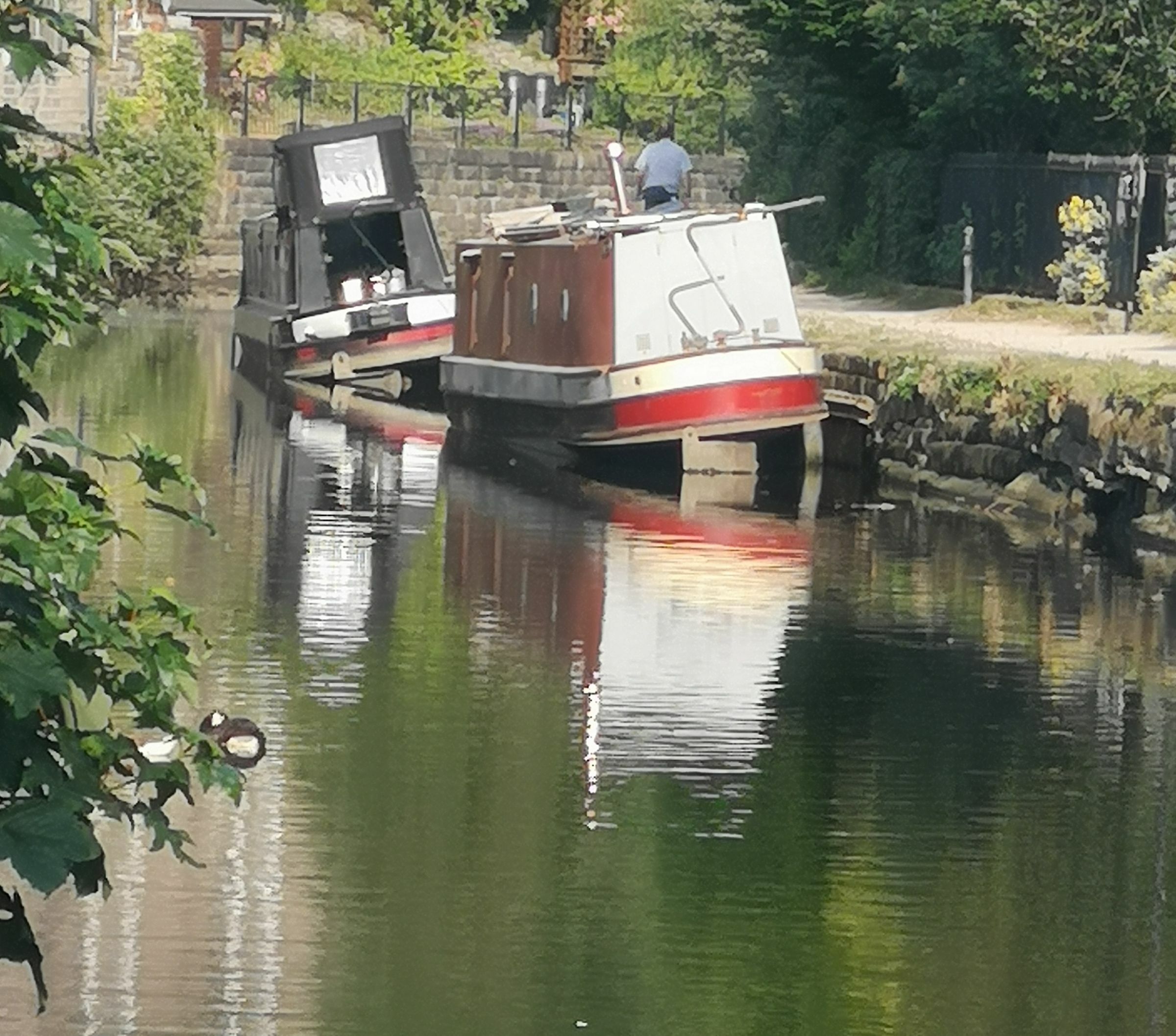

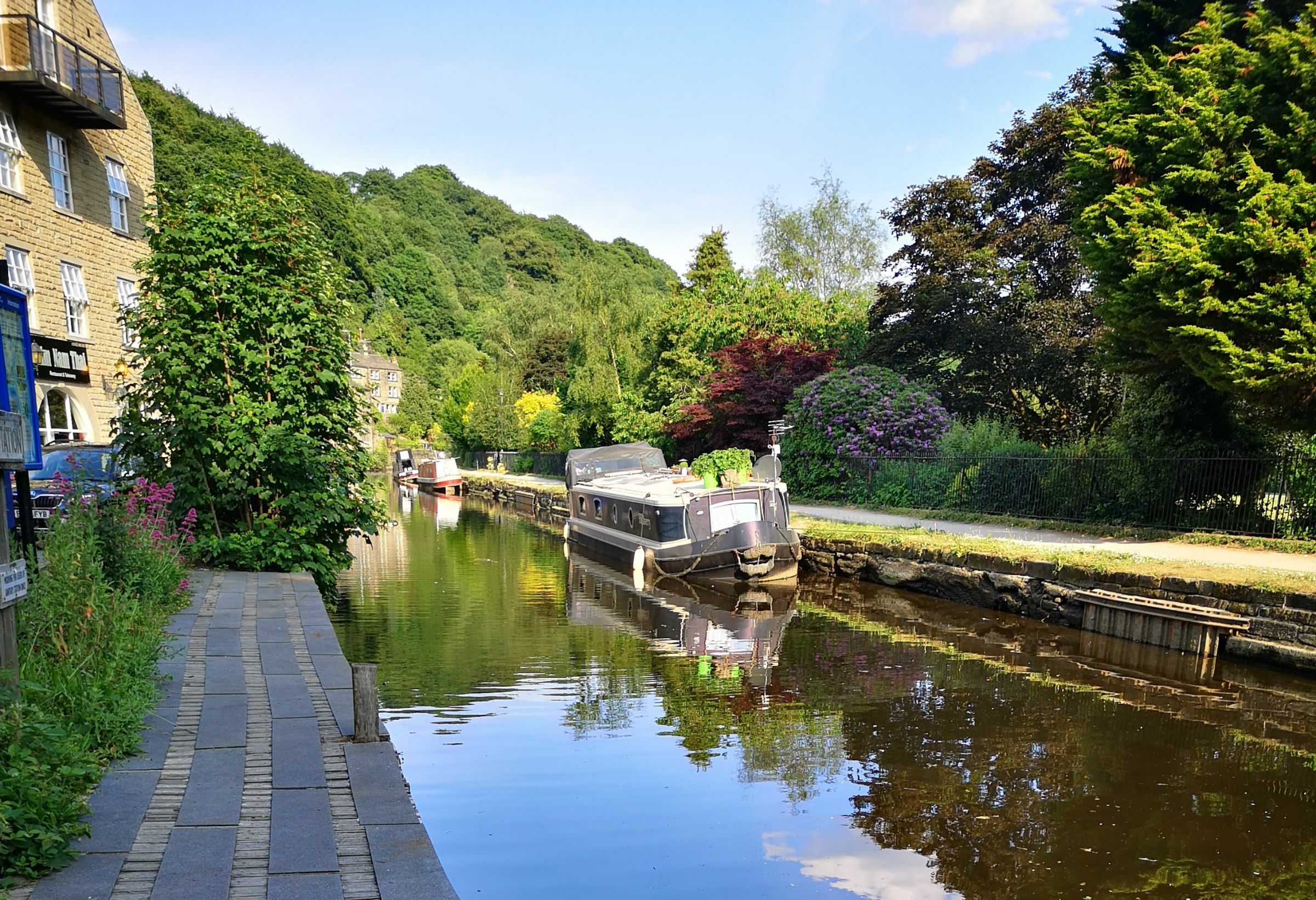

We came up from Hebden just over a week ago and there was mostly plenty of water, just some local issues. The Hebden pound is often tempremental but has got really bad  lately. A CRT sign on lock 9 blames vandalism but I suspect the huge leak at the bottom cill on lock 8 is the problem, its letting water go only marginally slower than its coming in. I heard it was on the stoppage list last year but cancelled due to lack of funds and noted that its not on the provisional list for this year. Things are only going to get worse, but just a few repairs to the a few troublesome locks could make a huge improvement.
Dropped off some bins tonight and the pound was lower than usual.
Not fun for those boaters I'd imagine...
Edit: this is Hebden Bridge basin.
Edited by Unicorn Stampede
It was, believe it or not, actually lower than that in the morning...

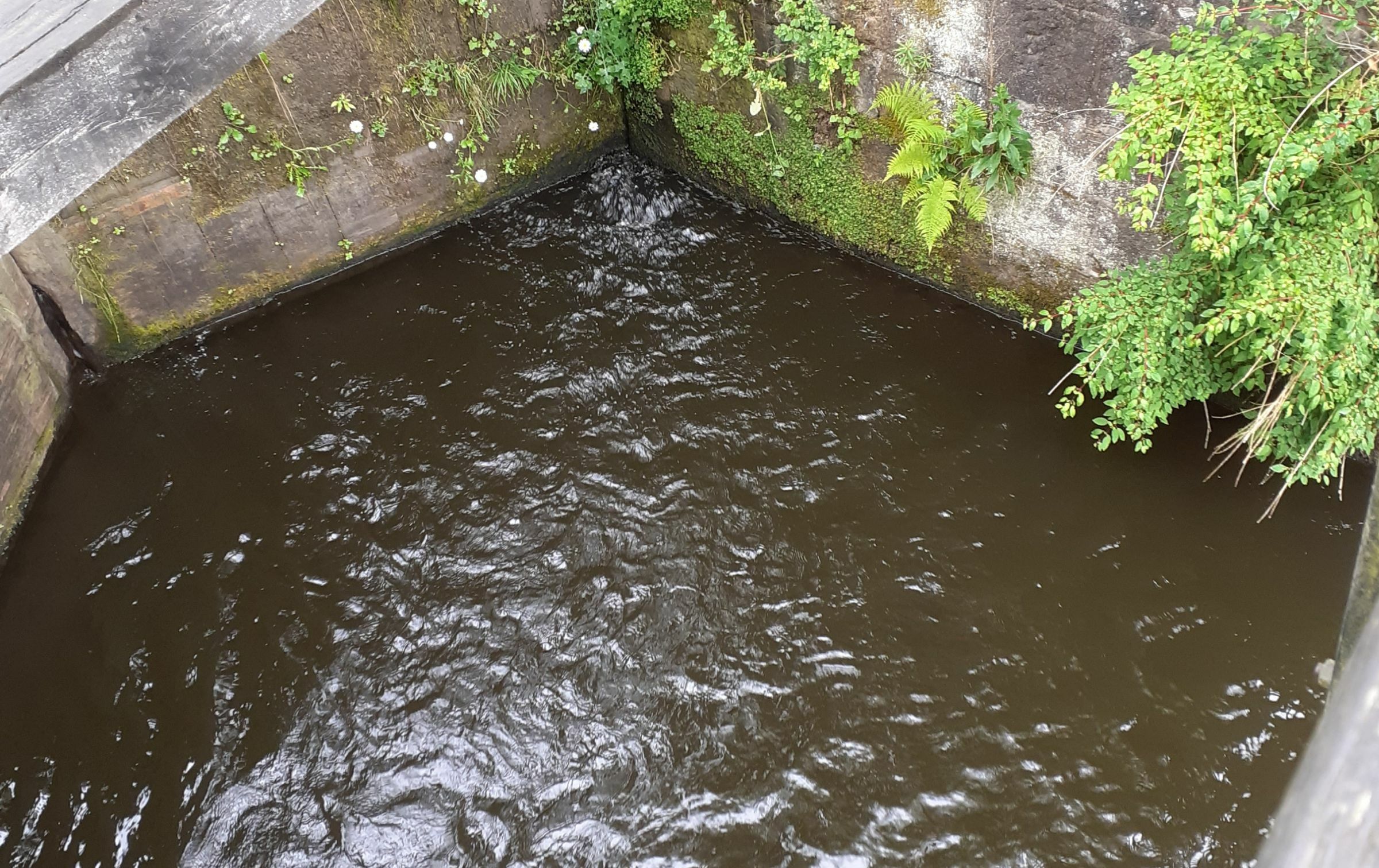

Yup. This is the water leaking out this morning, with the lock about 1/3 full. I can't see a corresponding leak at the top gates, but you can hear water running through the towpath side top paddle, so that must be leaking as well. The water level in the lock is stable.
Edited by David Mack
When I looked the lock was sitting almost full so water must be getting in at the top end somehow. Interesting that your pic shows a leak at the mitre but I saw a bigger leak right in the corner (far side gate) so I suspect the leak depends on which gate is closed first etc which happens a lot on the Rochdale locks.
Hebden is a proper "honey spot" (sorry for the Newspeak). If you type Hebden Bridge into Google and select images then about 25% of the photos feature the canal, even though the town itself is very pretty. An empty pound and grounded boats does not reflect well upon CRT.
Look again! My leak is between the offside gate and offside wall.
