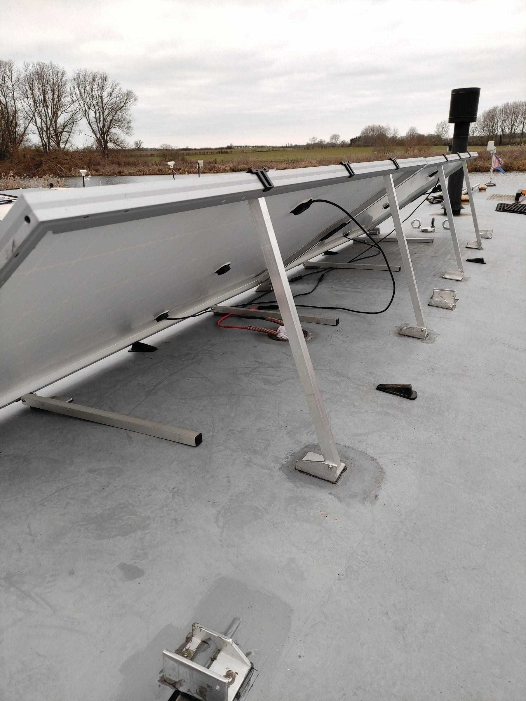

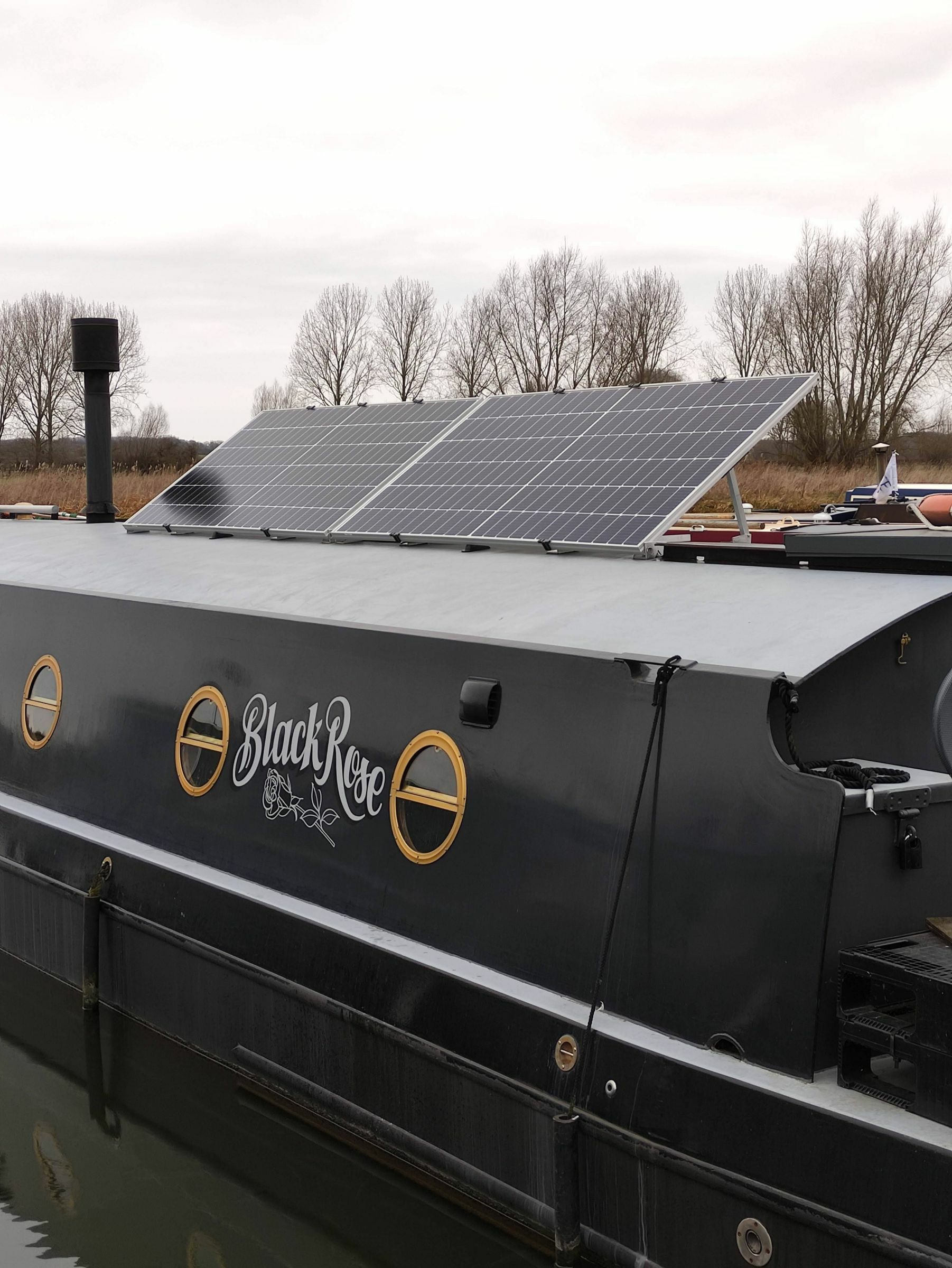

blackrose Posted April 10, 2023 Report Posted April 10, 2023 (edited) I was looking for a flat/tilting panel system when I installed mine last November but didn't find the Midsummer system. It looks good, but I'm not sure if it would have been big enough for my panels (about 2.1m x 1m each). I ended up making my own tilting system. They can be tilted either way. I found that around the time the clocks went forward the sun was high enough in the sky to leave them flat all day. I agree with the others about only using mag mounts for flat panels. I don't tilt mind if it's too windy. They're like sails! Edited April 10, 2023 by blackrose
David Floyd Posted April 10, 2023 Author Report Posted April 10, 2023 7 minutes ago, blackrose said: I was looking for a flat/tilting panel system when I installed mine last November but didn't find the Midsummer system. It looks good, but I'm not sure if it would have been big enough for my panels (about 2.1m x 1m each). I ended up making my own tilting system. They can be tilted either way. I found that around the time the clocks went forward the sun was high enough in the sky to leave them flat all day. That looks like a very cool tilting system, very impressive, Midsummer will make them to the size I need but I will make sure they do what I need before hand. Thanks David

blackrose Posted April 10, 2023 Report Posted April 10, 2023 (edited) I think it's worth paying for that midsummer mounting system. It looks good. I'd have bought it if I'd seen it but I'm happy with what I came up with. The panels are secured by/hinge on stainless quick release pins with ball bearings in the ends. Since I took those photos I've fitted a locks to the centre of each panel on both sides for use when the panels are flat, so that some scrote can't simply pull the quick release pins out and walk away with the panels! 13 minutes ago, matty40s said: Having installed those mounts, they are over engineered, a pain to install, and you will receive no more benefit than normal tilting mounts unless permanently moored on an East-West mooring in the months of Nov, Dec and Jan. What are normal tilting mounts Matty? Edit: If you mean those triangular mounts then surely one benefit of the Midsummer system is that the panels and mounts can go flat. One of my neighbours fitted those triangular mounts on his boat and now it won't go under Barnwell bridge! If it was a bridge 50 miles away it wouldn't be such an issue but it's the next bridge downstream! 🤣 Edited April 10, 2023 by blackrose

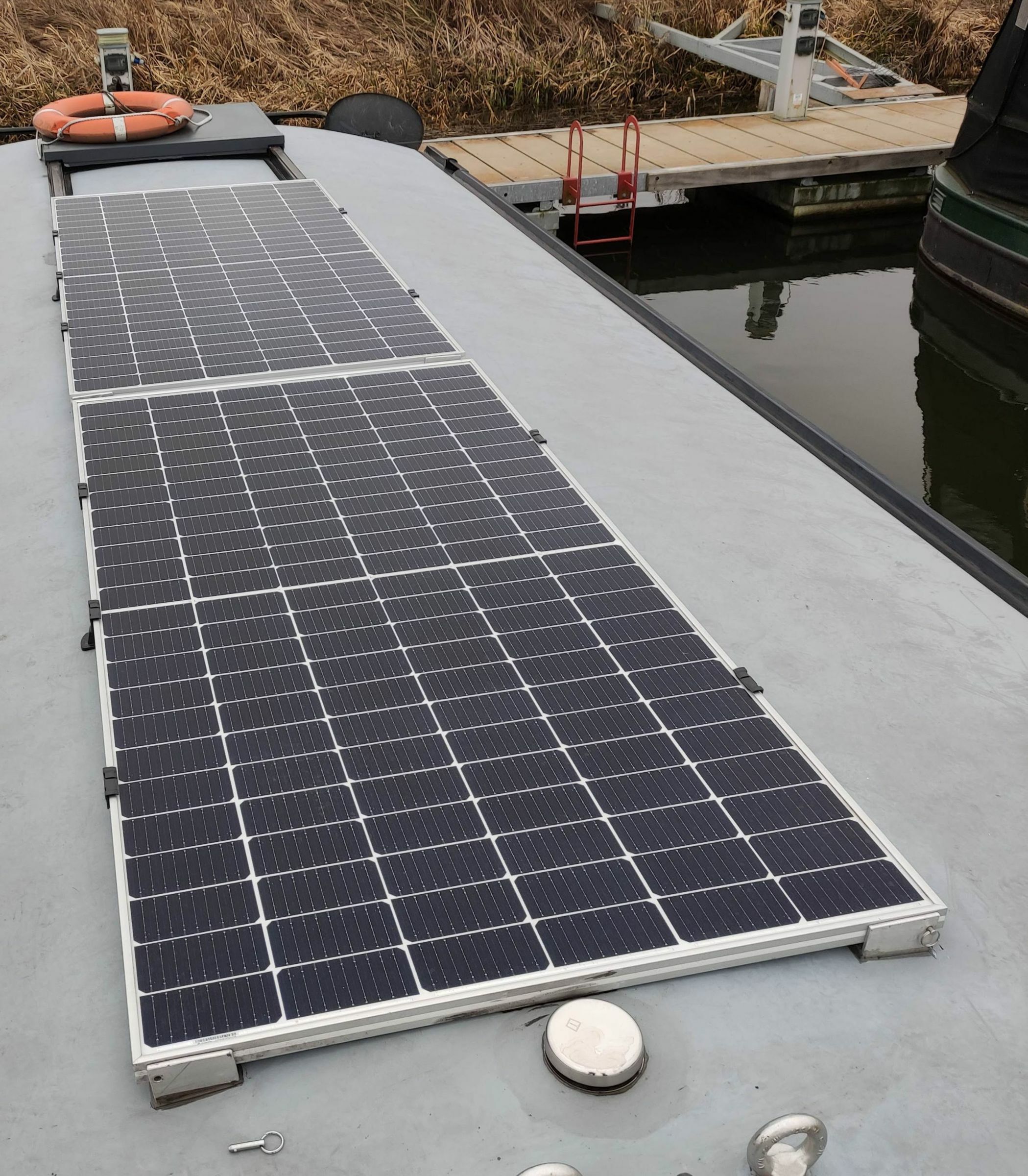

Baralacha Posted April 10, 2023 Report Posted April 10, 2023 I'm really only adding to what others have said, but the headline here is to get as much solar as you can on first install. I went for 885W (3 x 295) wired in series and don't regret it. In fact I reckon it's the best £850 investment yet made on my boat. Fitted in July last year, it's kept my batteries charged right through the winter. I don't run a fridge but for lights and batteries in phone, tablet, laptop etc. the flat-mounted panels have proved themselves capable. Running my 200W Makita sander from the inverter for half an hour needed about 5 minutes to recover the charge in October using solar. Never needed the generator or engine to charge once, and I don't move every day in winter. The Midsummer mounts are a clever design, but when I examined them it appeared that each has at least a 25mm protrusion on each side, which would have meant the space between my mushroom vents wouldn't have accommodated the three panels I chose. So I went for simple neodymium magnets on Screwfix angle brackets. 2 hours ago, blackrose said: I think it's worth paying for that midsummer mounting system. It looks good. I'd have bought it if I'd seen it but I'm happy with what I came up with. The panels are secured by/hinge on stainless quick release pins with ball bearings in the ends. Since I took those photos I've fitted a locks to the centre of each panel on both sides for use when the panels are flat, so that some scrote can't simply pull the quick release pins out and walk away with the panels! ! 🤣 I like your mounts more than the Midsummer ones for reasons given above by others. 1
