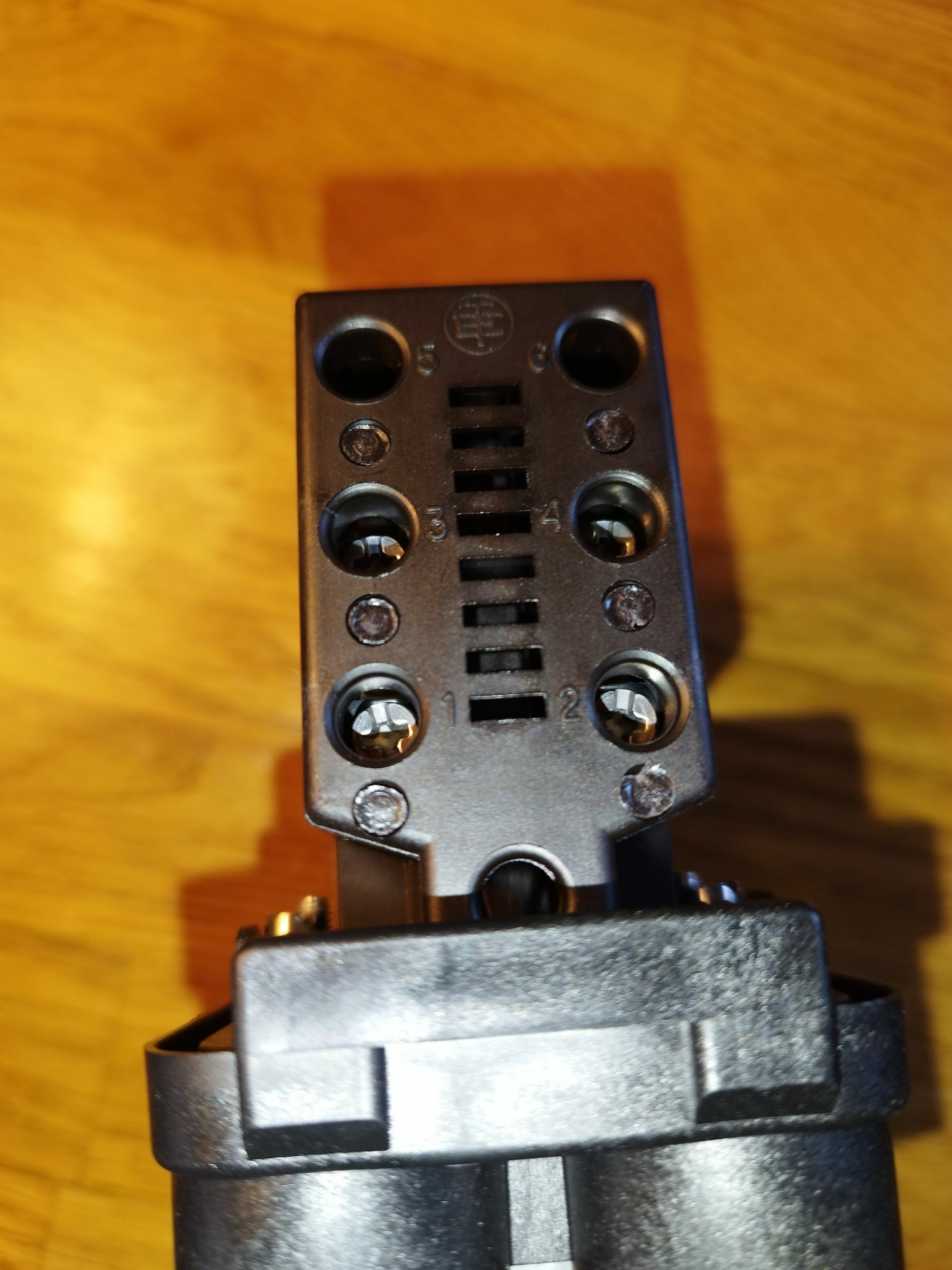

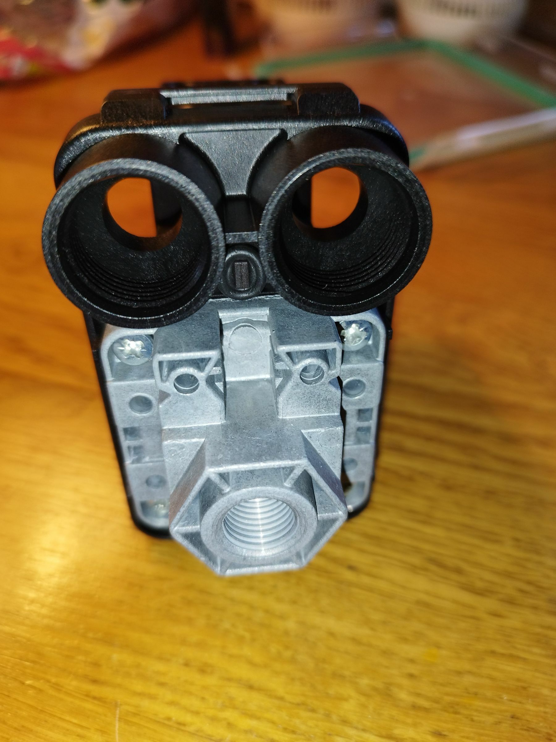

On 02/04/2023 at 17:41, Tony Brooks said:
1. As Tracy says, you have to bypass the pump's own switch. There are two wires coming out of the cylindrical body. One is negative and goes straight to the boat's wiring and the other, the positive, goes to the pressure switch. I cut that wire at the pressure switch and connect a wire from the D Square to it. Others simply set the pump's pressure switch to a higher value than the Square D, but that still leaves the tiny switch contacts carrying the pump current.
Looking at this switch I'm not really sure which terminal connections I should be using?
Also I assume the two holes at the top in my second picture are for cable glands which I won't bother with, but what's the threaded female connector at the bottom for? It looks like a connection for the water supply?
The instructions supplied with the switch are far from clear.
As for setting the thing.... Some instructions in plain English would have helped. I thought these pressure switches were supposed to be easy to fit?
