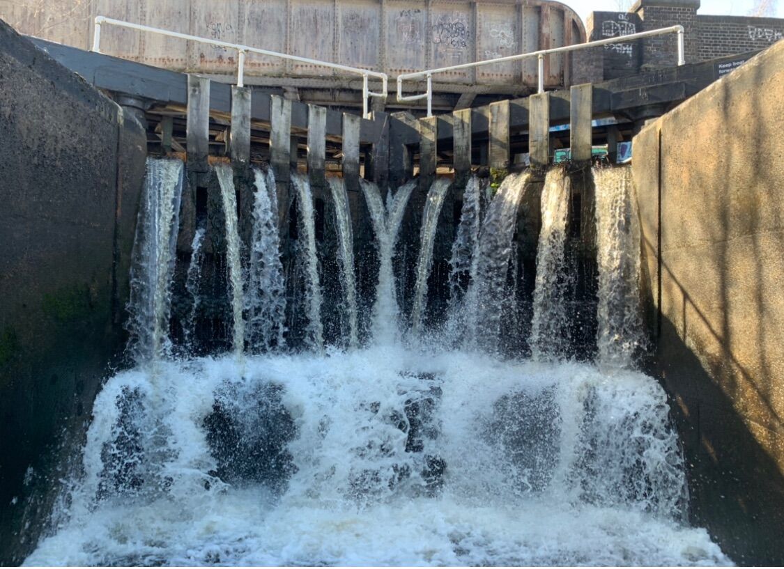

Going by last time I went through Salterhebble, the other reason for going down backwards is to stop the steerer getting a free cold shower from the top gate leaks -- I got my shoes filled up and the stern rope washed off into the lock (yes I know...) 😞
 You’ll be getting your shoes wet long before you get there💦💦
 The reason why you should let some water through from the above pound before you go into the lock, so no water is going over, if you don’t you get wet, as you’ll need to be up to the Cill to get out.
That's not why I got wet, water wasn't coming over the top, it was leaking through and around the gates, in particular there was a fountain coming from under one gate and landing right on the stern. And that photo looks like the Rochdale 9 to me...

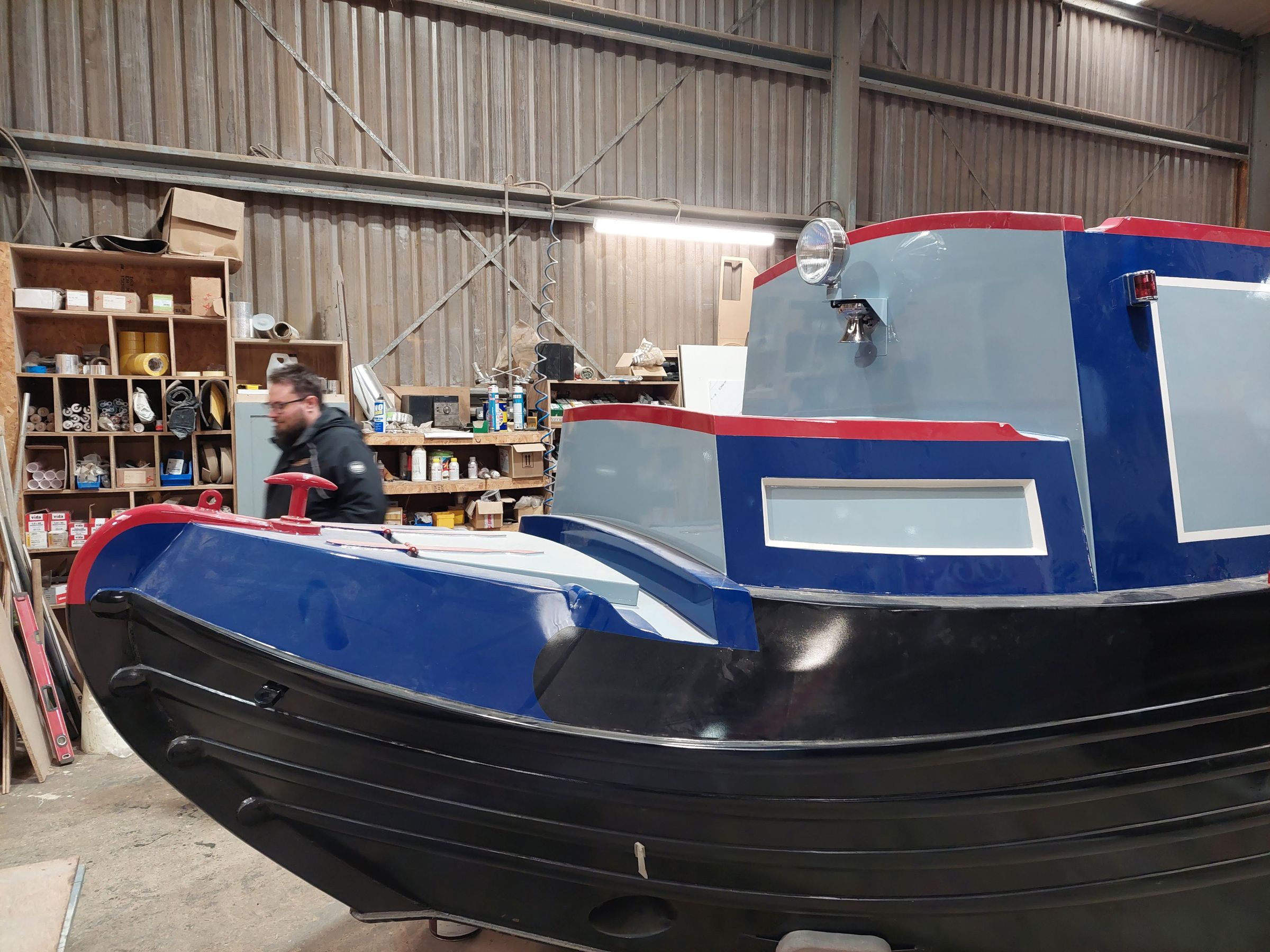

Anyway if I go through (either direction) with the bows next to the top gates this won't be a problem, the bows are watertight ("potter's cabin" and no well deck) -- one reason for doing this with a 60' boat... 😉

Many people have been through with 60' boats and reported that it's tight and needs care but is doable -- and it's now what the advice says too.
But it does help a lot if you don't have a well deck or any way for water to get in at the bows -- see above comment and photo below...

Thanks for the advice. I'll steer from inside the closed rear (semi-trad) doors then, that should keep most of the water out -- the stern outside them is watertight, and the doors have a small upstand underneath... 🙂
