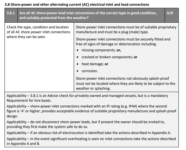

Alan de Enfield Posted March 20 Report Share Posted March 20 (edited) 12 minutes ago, Chewbacka said: This may help https://www.boatsafetyscheme.org/requirements-examinations-certification/hire-boats-requirements-2017/additional-hire-boat-requirements/ Superceded. The new 2022 BSS now covers both 'leisure' and 'commercial' BSS requirements in one standard For each section (in the top right hand corner of the section) there are one or two 'letters' (either an R or a A) The 1st letter is for the 'leisure BSS' and the 2nd letter is for the 'commercial BSS' If there is only one letter that means it applies to both leisure and commercial vessels An R means it is a Requirement (and not doing it is a BSS Fail) An A means it is an advisory and is strongly suggested that you do whatever it is, but, if you do not it is not a BSS fail. I was going to attach the new BSS requirements in a Pdf but it is 4.5Mb and the forum limit is only 2.9Mb You will need to go onto the BSS website and download it. This is what you are looking for BSS Examination Checking Procedures Core Checks for privately owned and managed vessels And, Parts 2-9 of Hire Boat Requirements examination. Non-controlled Review Version 28 Sept 21 – 31 March 22 Edition 4 Version 0.2 – 28 September 2022 Example : Edited March 20 by Alan de Enfield Link to comment Share on other sites More sharing options...
