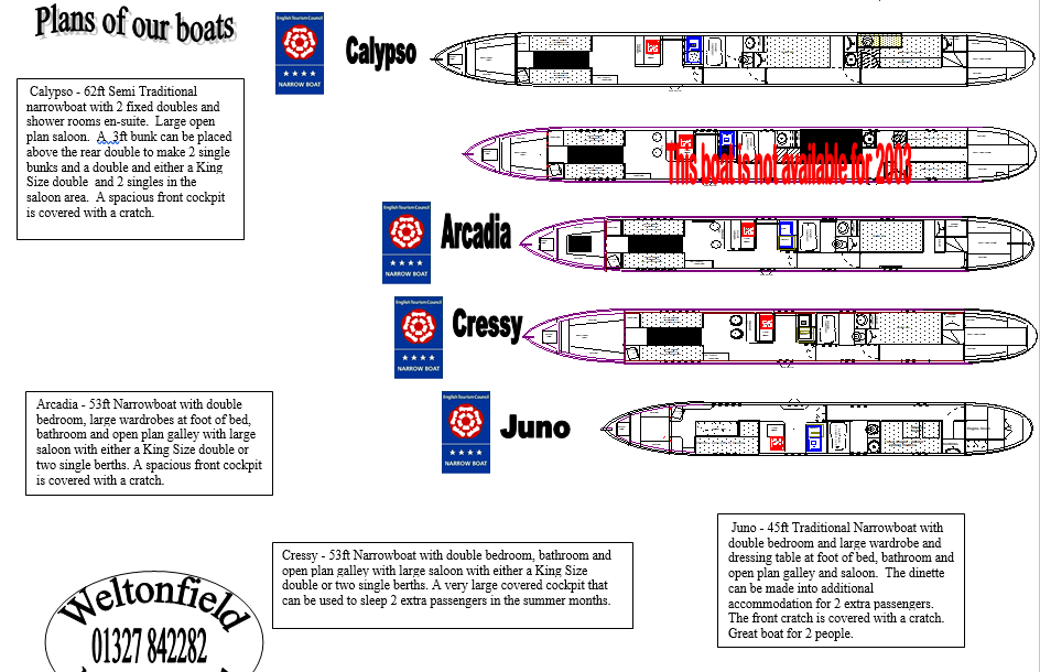

My 1998 (Juno) was built for a hire fleet so whilst it would probably have been 10mm as the 'norm' the 1/2" could, again' have been a hire fleet requirement.
She was sold out of the fleet at the age of 5 years, which seems to be very young for the sell-off of a hire boat.
