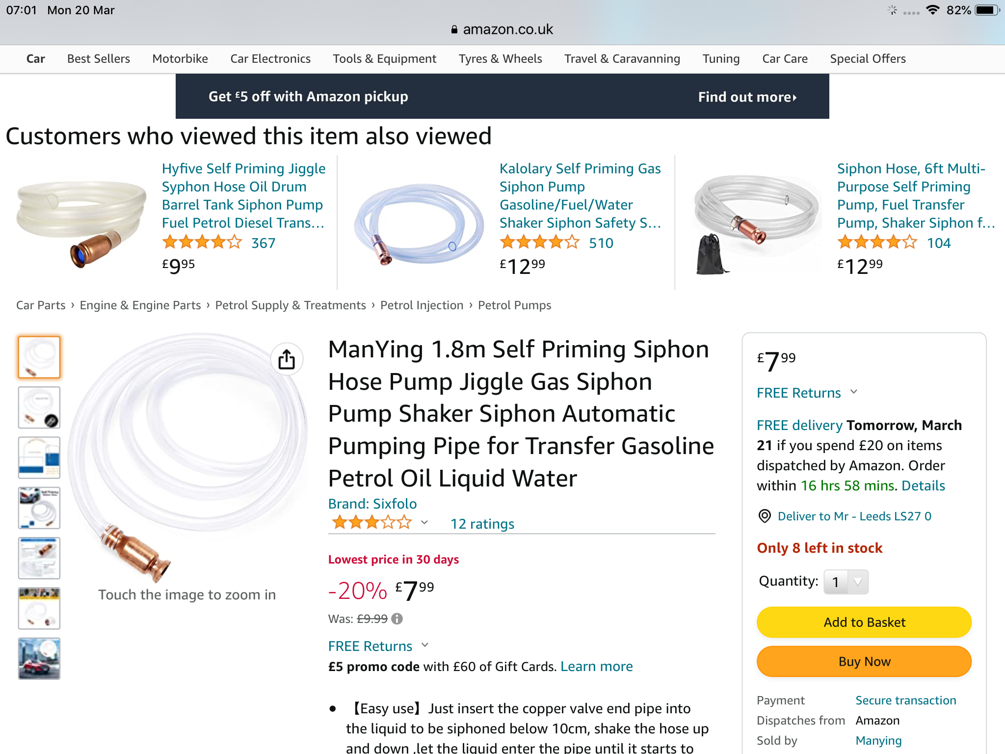

The local chandlers are doing a special in universal fuel lines, Looks like standard outboard fuel line minus the dry break couplings at each end.
What are the collective thoughts of using these as water sampling kits, perhaps with a length of copper tubing to provide a probe to get to the bottom of things?
Been advising it on UK narrowboats for years.
Check Amazon/Ebay. In the UK those are listed at less than £5, and they seem to use a clear hose, so the operator can see what they are pumping. They are listed under "Syphon pumps" although I doubt you can use them as syphons.
I use one of those for refuelling from Jerry cans at sea.
Pump away until the fuel starts to flow and then it syphons perfectly - It does work.
Jerry can sits on top of the engine hatch (below the 'gang plank') and syphons into the fuel tank via the filler (yellow rimg)
I use one of these for refuelling from a jerry can, as our fuel filler makes it very difficult to pour without spillage.
They do work, the pump starts the syphon then it does its own thing, but even with the jerry can about 3 foot above the tank level its very slow.

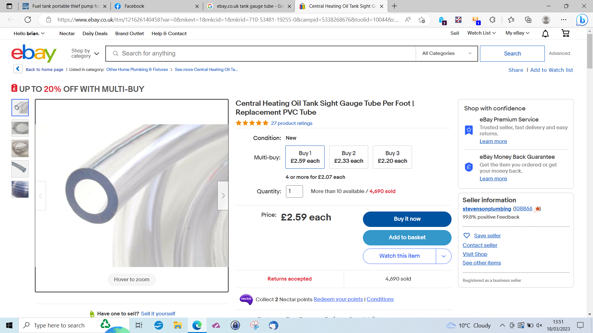

Clear hose is really good for seeing what is going on, but bog standard plastic hose goes very hard quite quickly when exposed to diesel.

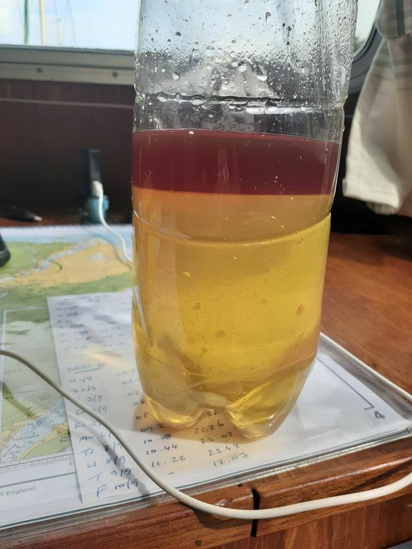

I think I prefer the little bulb pump, with its tubes, and a clear PET lemonade bottle all for about £8.
Let the fuel settle, decant the "clear and bright" back into the tank with the biggest problem then being discarding the skunge.
The first time I did it on our then 8 year old narrowboat, and on the similarity aged fuel tank on the yacht I needed more then one 1.5 litre bottles to get to "clear and bright" There was free water with skunge, sloshing round in the bottom of the tank waiting to be gulped into the fuel line.
After a couple of six monthly repeats, it came down to about 5mm of grubby water, some rust particles, and suprisingly sometimes sand particles, with about 100mm to 200mm of cloudy sometimes grey diesel.
