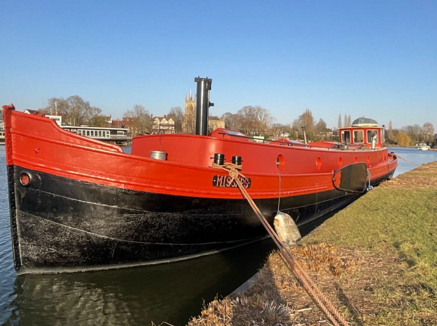

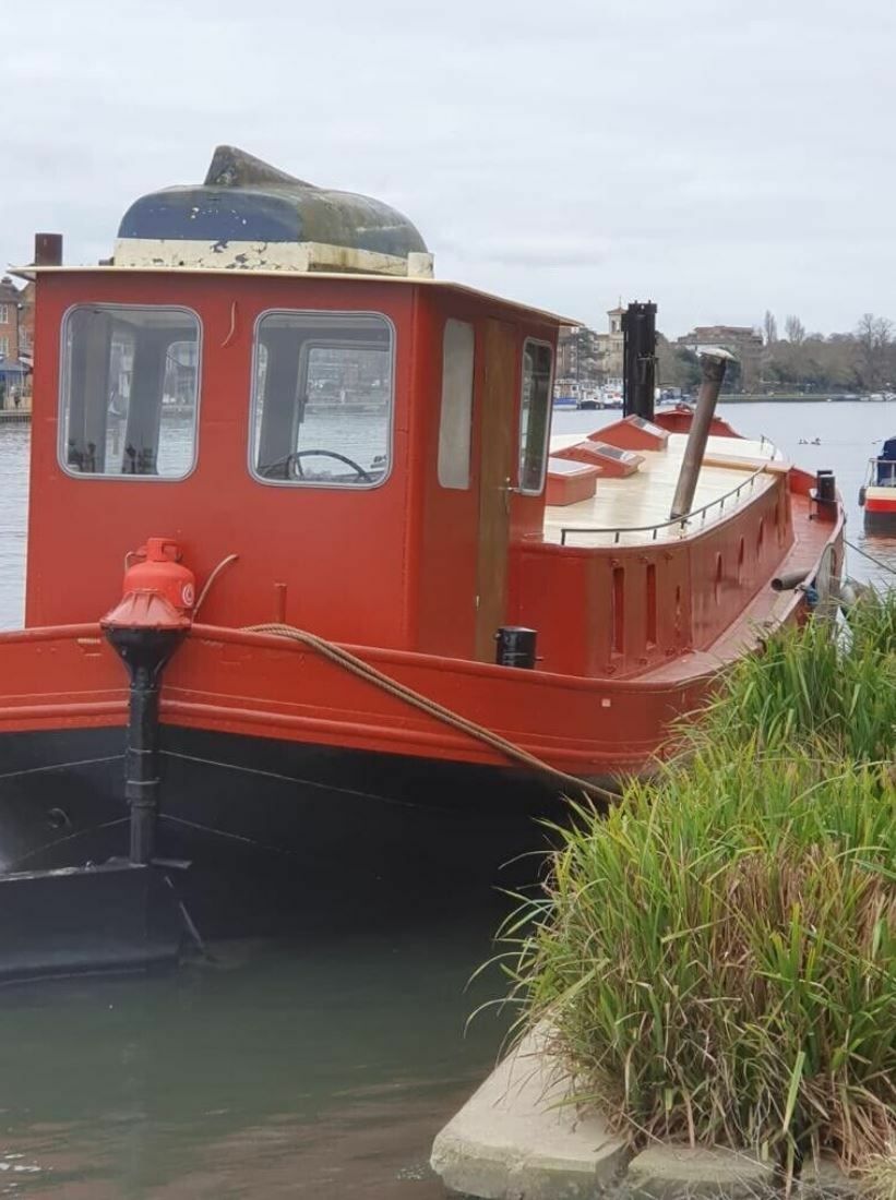

That black thing on the front deck.
Is it a spud leg  / pin anchor? That is not going to fit under low bridges if it is fixed.
Looks too large to be a chimney.
Maybe it is something else.
For use on smaller canals that would definitely need to go. I suppose it would be ok on larger northern waterways.

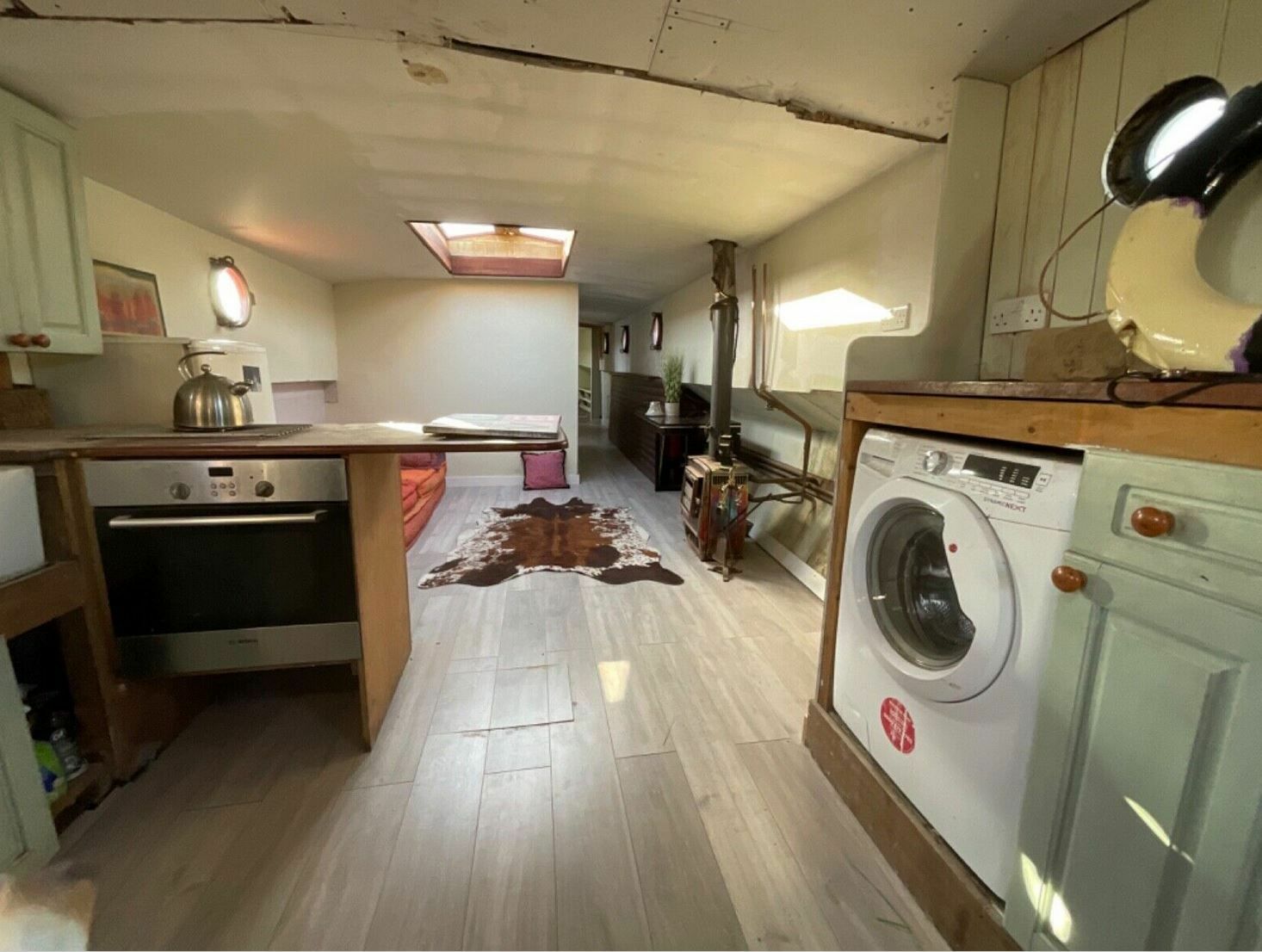

The other immediate concern I have with this boat is it seems to have been drywalled and plastered both on the ceilings and the walls.. surely, you would not do this on any kind of boat, whether it be sea or inland going? no?

Looks like the wheelhouse is  well elevated and the side deck draining forward which is good. I don't see much drainage off the side decks but there may be some.
Looks like a good boat for he Humber, Trent, Ouse and Aire and  Calder .
It is a nice enough boat but trouble on the smaller wide canals. If one were based up there I think it would be a good plan to get a boat which would do the Leeds to Liverpool canal.
There are some side deck drains but not especially large.
What type is this ? I'll guess Steilsteven but not sure if this is a general term or a sub type

Nice boat but too tall, too wide, too long probably too deep and not seagoing either in any real sense of the word. UK canals are best tackled in something no more than 72` x 7 and not drawing more than 2`6" Even the wide canals would be such hard work that you would wish you hadn't bothered. I sometimes look at adverts for the smallest Dutch boats just for something different than narrowboat clones and even the smallest, Westlanders and Kagenaars which started life as punts are very rarely below 8` wide and our own boat at 11` 4" wide by a bit over 32`  drawing about 2` 6" with a collapsible wheelhouse was hard work up the GU and only just possible to get to Guildford on the Wey and above Oxford on the Thames because of headroom
Its probably fitted out to spend its life moored up and used as a house.

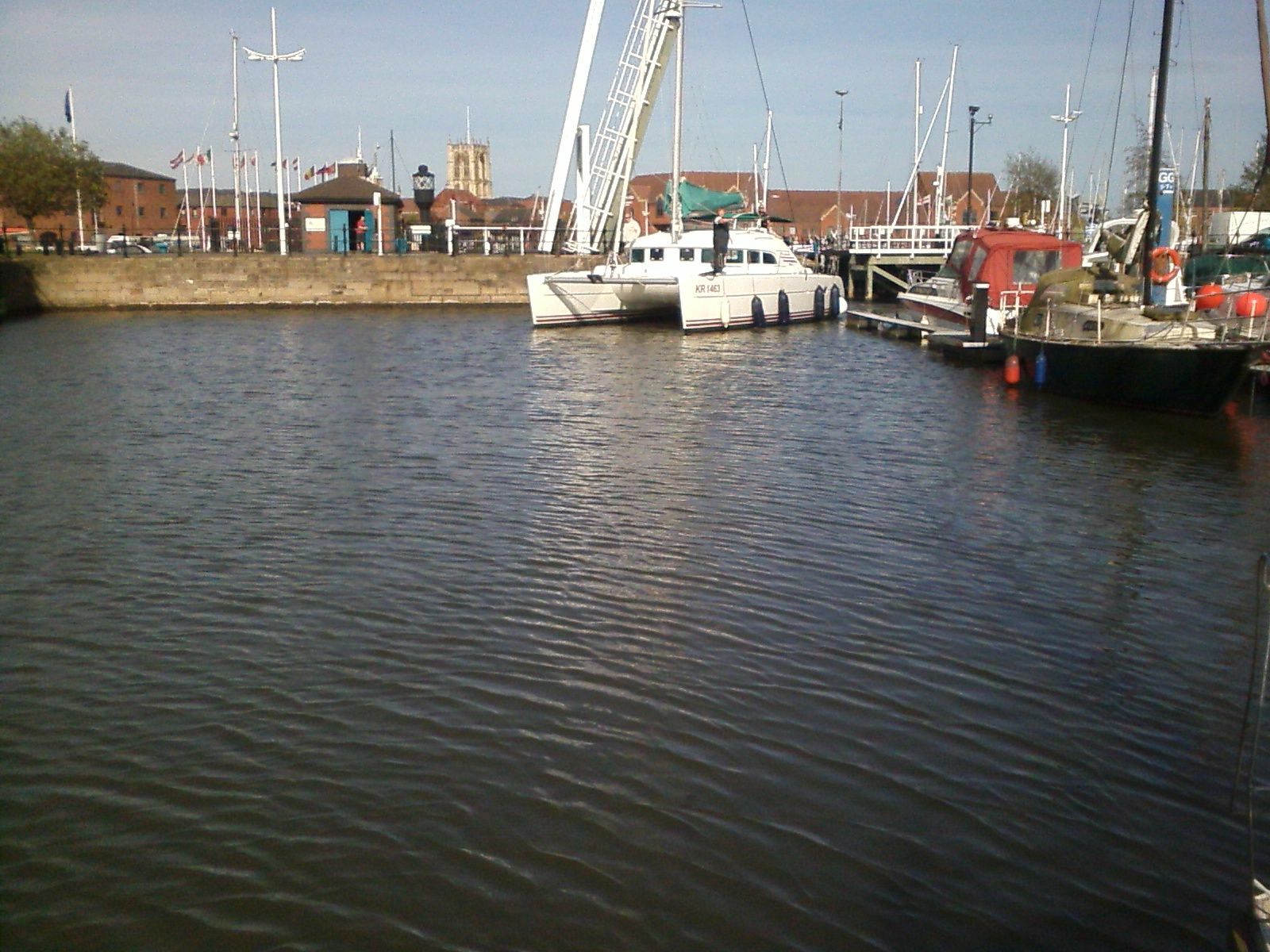

We had our Category A (Ocean rated) boat based in Hull Marina for several years.

"The other immediate concern I have with this boat is it seems to have been drywalled and plastered both on the ceilings and the walls.. surely, you would not do this on any kind of boat, whether it be sea or inland going? no?"
No.  I would not expect any sort of drywall and plaster arrangement to last well in any sort of seaway, especially if pounding,  or whilst taking the sorts of knocks and bumps  that are an inevitable part of canal and river boating.  The fit out is clearly intended for an immobile usage.  IF that is the case for things internal, what might the real state of the engine be?
