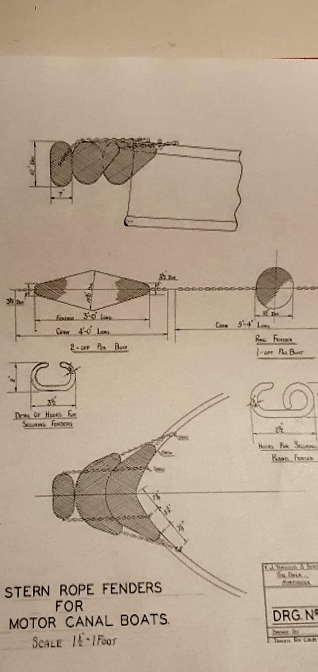

Jen-in-Wellies Posted January 20 Report Share Posted January 20 2 hours ago, Ray T said: Is this "traditional?" One of the issues is that "traditional" tends to vary! If you will excuse the pun, I feel at times we can get too "hung up" on what is "traditional." Taken at Alvecote Aug 2022. Also this: That bottom drawing is clearly for a model canal boat, not a real one. 1.5" per foot, so one eighth full size. Not good evidence for traditional practice. 😀 Link to comment Share on other sites More sharing options...

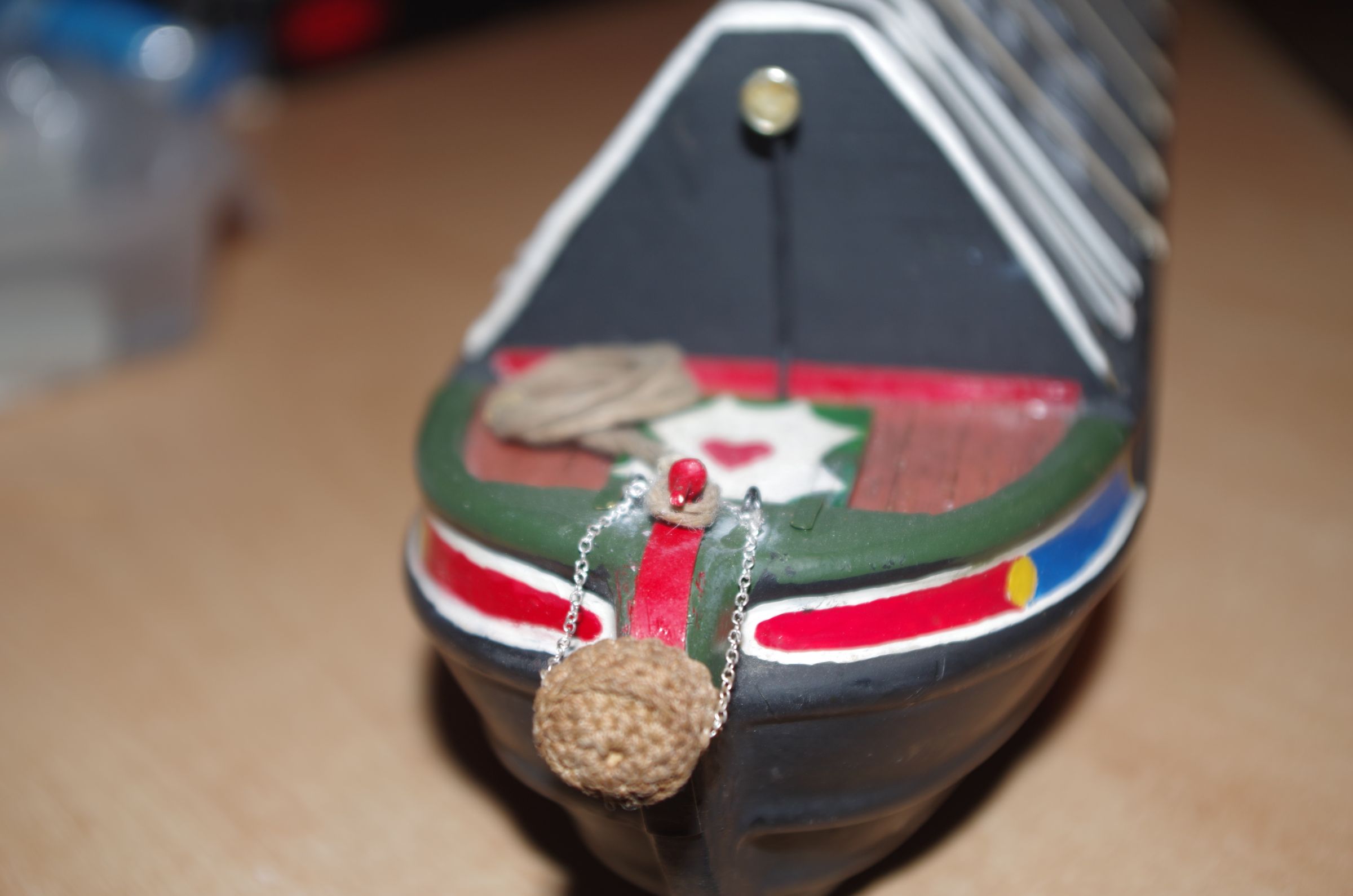

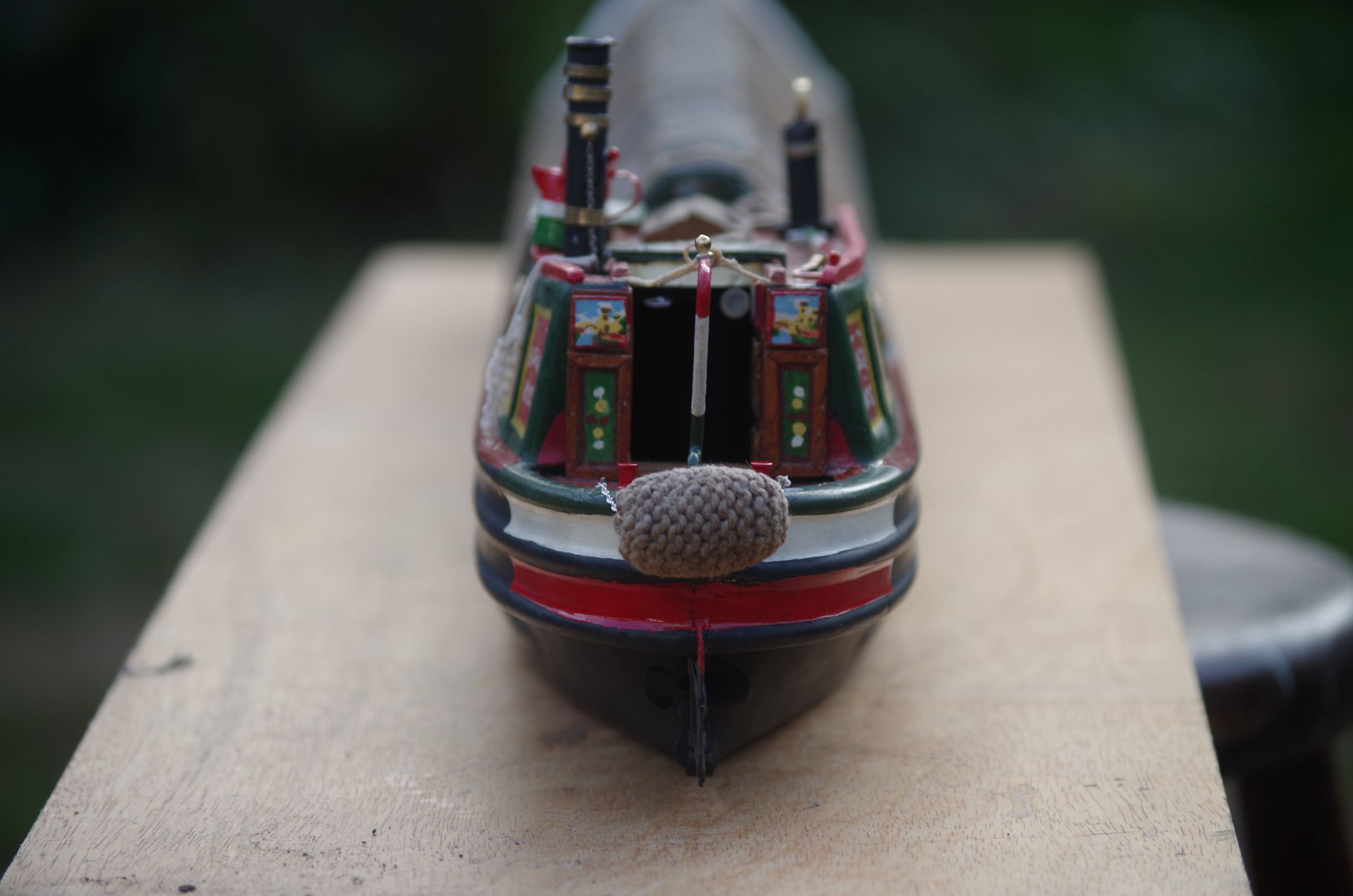

Ray T Posted January 20 Report Share Posted January 20 (edited) 1 hour ago, Jen-in-Wellies said: That bottom drawing is clearly for a model canal boat, not a real one. 1.5" per foot, so one eighth full size. Not good evidence for traditional practice. 😀 Here is the bow and stern fenders on one of my model narrowboats, I haven't had a hang up yet. 😁 Edited January 20 by Ray T 1 1 Link to comment Share on other sites More sharing options...
magnetman Posted January 20 Report Share Posted January 20 Nice boat. Unusual T stud. Link to comment Share on other sites More sharing options...

Ray T Posted January 20 Report Share Posted January 20 (edited) 5 minutes ago, magnetman said: Nice boat. Unusual T stud. Yes, as conventional ones are unavailable in model form to the scale 1:25 I had to fabricate one from copper wire. Put "T stud" in a search engine and you get things for earoles and other places! 😲 Edited January 20 by Ray T Link to comment Share on other sites More sharing options...
magnetman Posted January 20 Report Share Posted January 20 Did you make the model? Link to comment Share on other sites More sharing options...
Ray T Posted January 20 Report Share Posted January 20 7 minutes ago, magnetman said: Did you make the model? You have a pm. Link to comment Share on other sites More sharing options...
Derek R. Posted January 21 Report Share Posted January 21 10 hours ago, Jen-in-Wellies said: That bottom drawing is clearly for a model canal boat, not a real one. 1.5" per foot, so one eighth full size. Not good evidence for traditional practice. 😀 The drawing would be 71' 6" long if it were drawn to scale. It is not a drawing for a model boat, but the scale to which the DRAWING was drawn. As mentioned before, 'tradition' comes from safe best practice, but in real life, that can be interpretated in several ways depending on the boat, the waterway, the crew, and sometimes what you can get away with. Link to comment Share on other sites More sharing options...

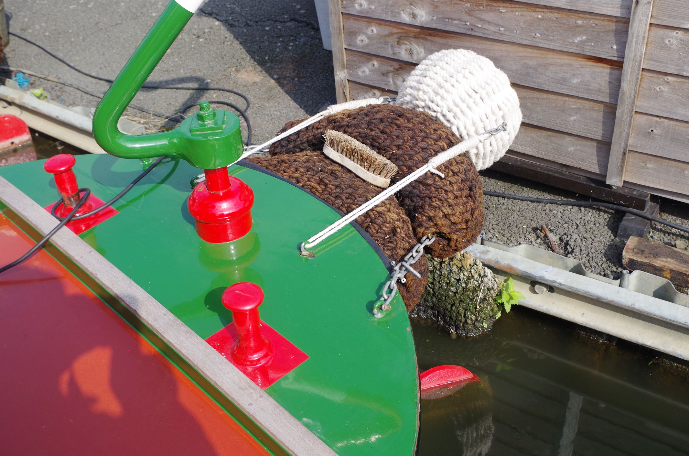

Rob-M Posted January 21 Report Share Posted January 21 Fenders at Alvecote last year Link to comment Share on other sites More sharing options...
Jen-in-Wellies Posted January 21 Report Share Posted January 21 (edited) 10 hours ago, Ray T said: Here is the bow and stern fenders on one of my model narrowboats, I haven't had a hang up yet. 😁 Nope, they are obviously photographs of a real boat, taken with a tilt-shift lens to make it look like a model. I'm not fooled. They are far to realistic to be a model, despite the trick camera work. If it were a model, you would be an excellent model maker and I would be in awe of your skill. 😀 57 minutes ago, Derek R. said: The drawing would be 71' 6" long if it were drawn to scale. It is not a drawing for a model boat, but the scale to which the DRAWING was drawn. As mentioned before, 'tradition' comes from safe best practice, but in real life, that can be interpretated in several ways depending on the boat, the waterway, the crew, and sometimes what you can get away with. https://en.wikipedia.org/wiki/Joke Edited January 21 by Jen-in-Wellies 1 Link to comment Share on other sites More sharing options...
