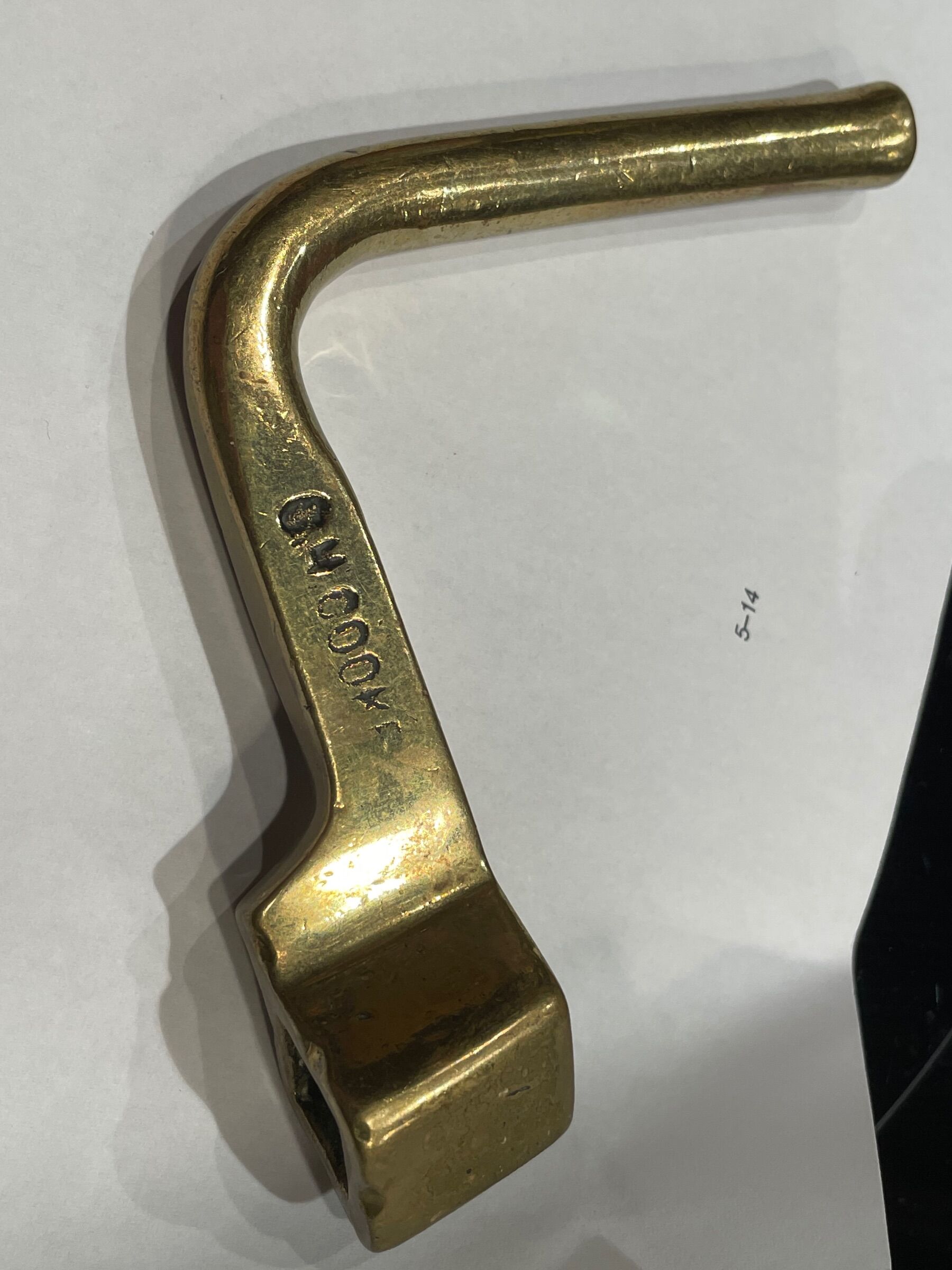

Thanks to the poster recently one mystery I had  has I think been solved. The pattern on one side I always thought was a badly stamped old IWA logo. So I had thought it was made for an IWA Rally and given to a Mr Cooke 🤣.
However it seems GH Cooke was an older maker and sometimes they were chrome plated . Their windlasses were stamped with a clay pipe.
I picked this up off eBay years ago advertised in the toy steam section for a couple of pound.
I hope I’m right ?
But the final mysterious thing is it’s very small, around 1/2 AF for the windlass to fit into It doesn’t look worn either so not much use in action. It’s only  3 1/2 inches each way.
Does anyone know what it’s function was or maybe it was a piece made by an apprentice.

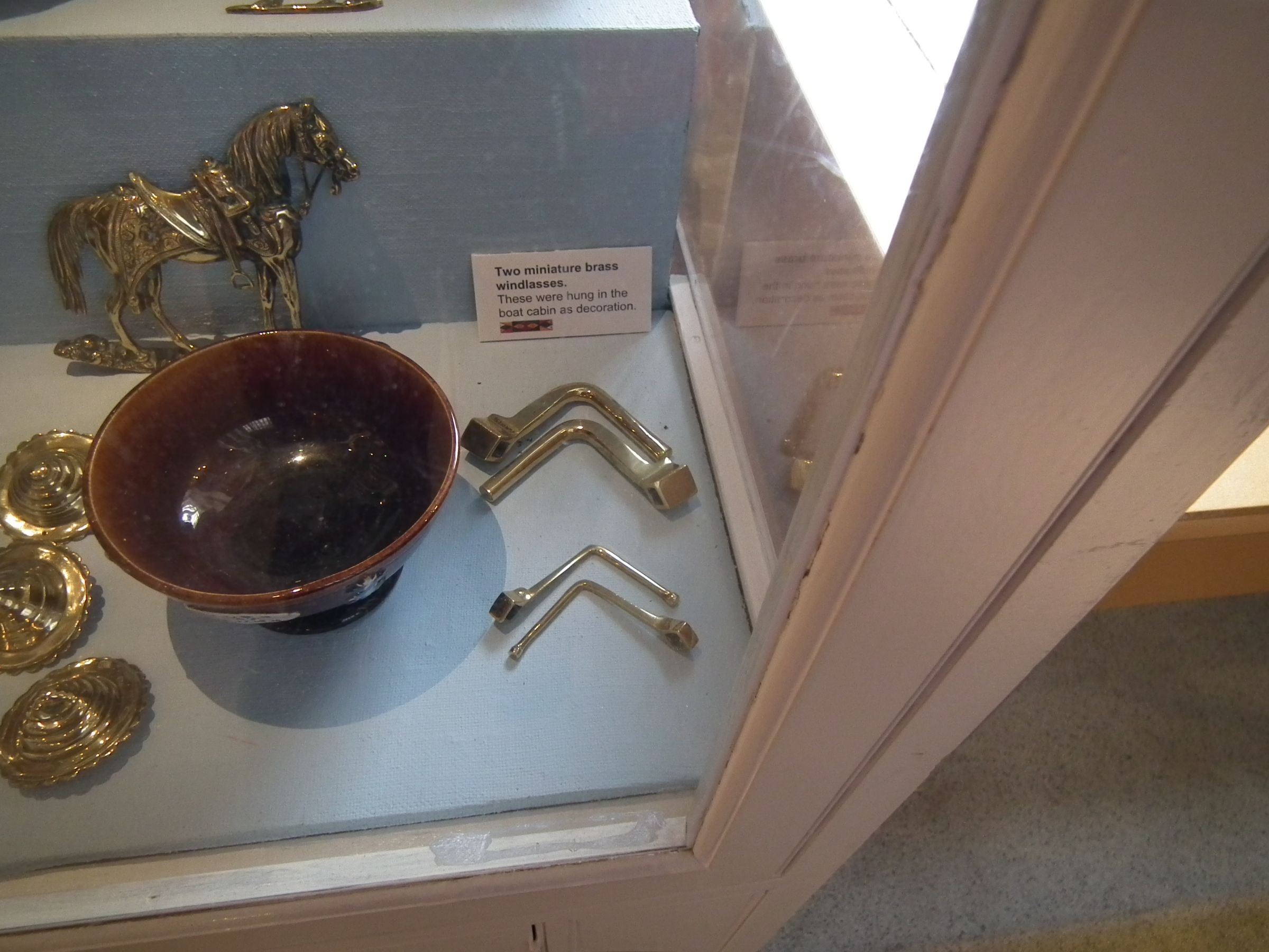

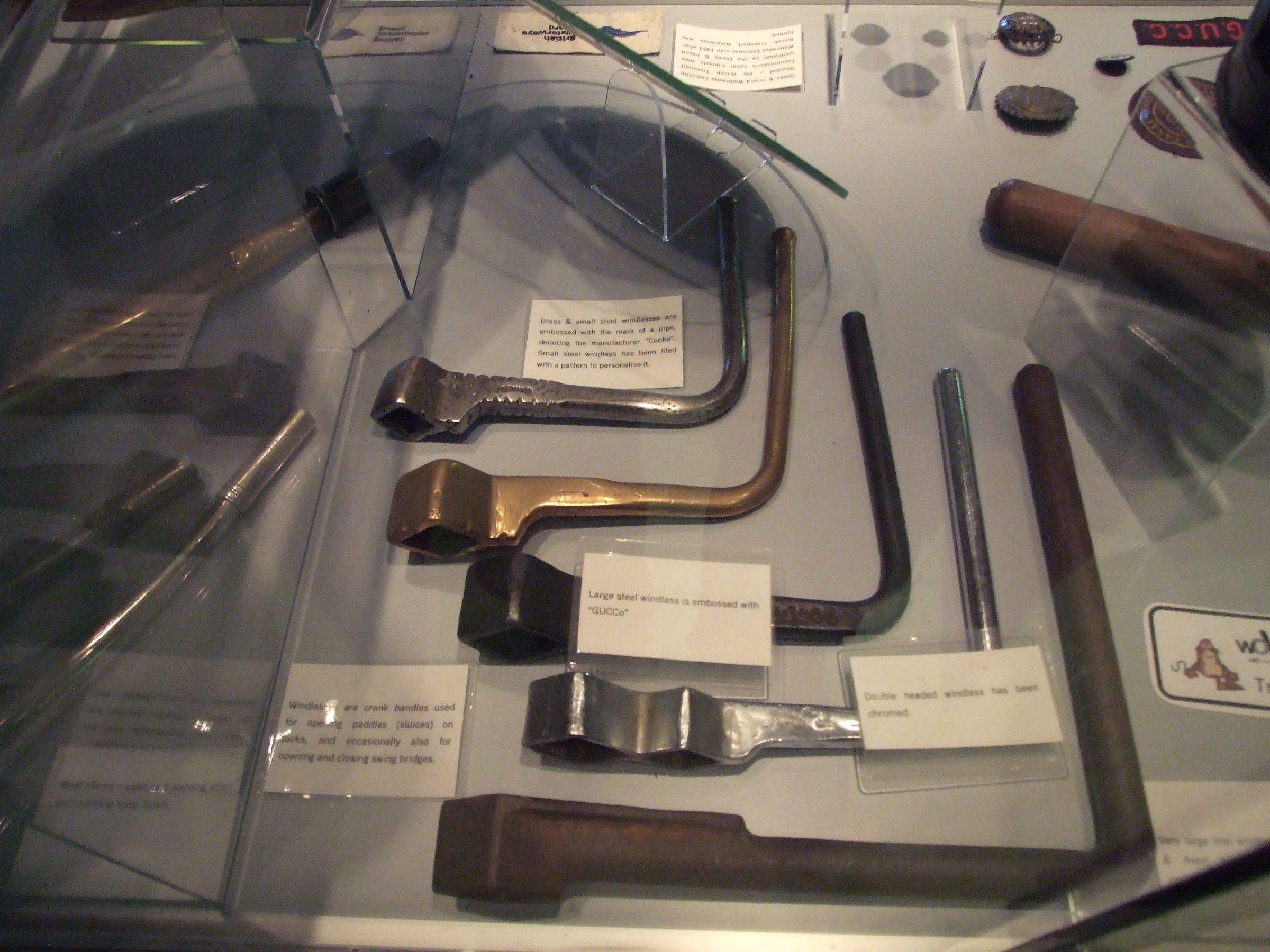

The museum at Stoke Bruerne has a couple of these. Some boaters hung them up in the cabin along with their ribbon / lace plates.
l believe the Cooke windlass were made at Wheelock Cheshire. They were known as a “welluck.”
The full-size ones were much prized by boaters as they still are today.

Thanks David for your assessment. I’m curious though why anyone would go to the lengths of casting one from brass at a later date?  I hope it wasn’t as a forgery but surely until recently it’s a very niche market? We’re any brass windlasses then made by GH Cooke?
Would the stamping of the name and pipe come after casting? The name is a reasonably crisp stamping and would seem to have been done with the whole name stamped rather than individual characters stamped one at a time.  The pipe bit isn’t and seems to possibly have been done when cast? (hence my IWA thought 😞
Somewhere I have the original invoice and image from the time I bought it which would have been around 2006-12 . It wasn’t sold in the canal section nor advertised as such, so the seller wouldn’t have cast it. It was sold as a spanner for steam engine IIRC 🤣

No need to search. Here are a couple of pictures of both the GH COOKE and Pipeclay marks. These are, by far, the best examples I have seen, most are usually far less clear.:-

It is extreemly unlikely that Cooke ever made any items in anything other than wrought iron, he was a Village Blacksmith, working either on his own or with a son as an apprentice. If he did work in brass, he would have, almost certainly, described himself as a Brass Founder as well as a Blacksmith in the census returns. There was an Iron Foundry in Wheelock, associated with the Salt Works, but there is no evidence of there ever being a Brass Foundry in the village
With regard the the marks on the OP'S brass windlass, they certainly appear to have been cast rather than stamped, which would involve having two (expensive) stamps being made. This raises more questions, was a wrought iron windlass bearing both the GH COOKE and pipeclay marks used as a pattern, in which case , where is it? or did the caster butcher a full size cooke windlass to achive the two marks? The one person who might have been able to throw a light on this would have been Laurence Hogg, who is sadly no longer with us.

This thread has rejuvinated my interest in Cooke windlasses, causing me to delve a bit more into my records. Below is a photo of the "Keays Dock" windlass which Laurence Hogg owned, followed by a copy of the brass windlass in the OP. As can be seen, they have a number of subtle differences, not least of which is a different mark on the presented side. Interestestingly the positioning of the Pipeclay and GH COOKE are on the same sides on all the examples known to me, but the pipeclay only mark can appear on either side when not accompanied by the GH COOKE mark.  I have a theory as to why, but am reserving judgement at the moment.
