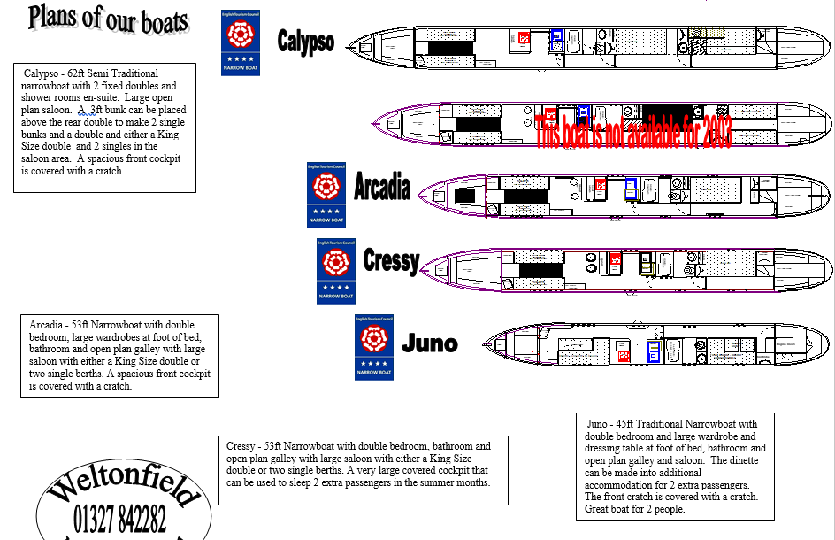

We had a 45 foot steel NB and it was fitted out perfectly for a couple - but if anyone wanted to stay then it was convert the setee to a bed which then needed making and putting away every day. No late night TV if someone was sleeping on the 'put you up' .
This was our 45 footer - you can see the layout (Juno) from when she was a hire boat - she was sold out of the fleet at 6 years old - First job was to remove the pump-out tank and have a cassette sytem fitted, then reorganise the bedroom and bathroom.
