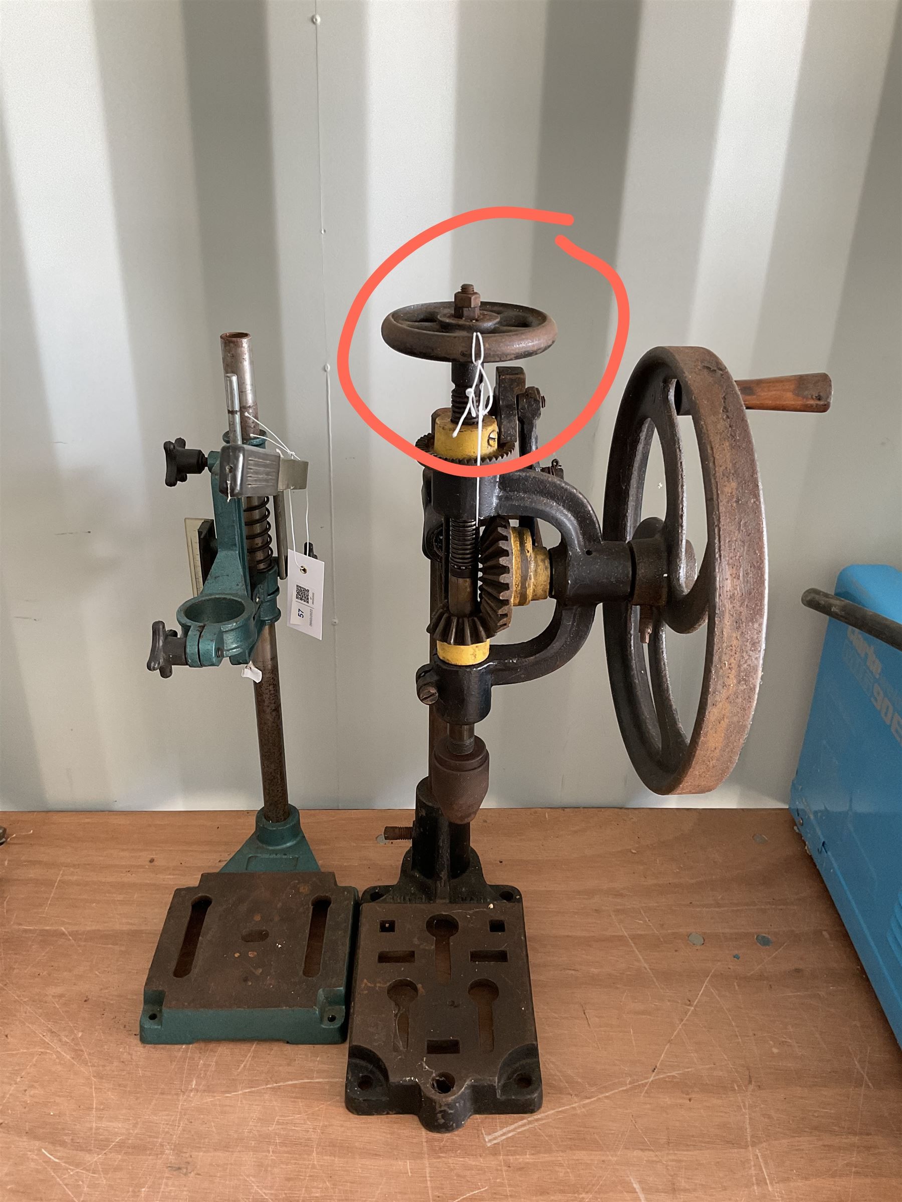

magnetman Posted January 1 Report Share Posted January 1 (edited) I have used the top wheel from a pillar drill for this in the past. Old fashioned type pillar drill like this Obviously you need to find a knackered pillar drill not a really nice one someone might pay good money for. Lathe control wheels are another option. That is for speed. If you are doing gear change with a wheel it is probably going to want to be a bigger wheel and some sort of reduction gearbox. Depends what engine/box it is. If it is a hydraulic box then doesn't need any effort. Edited January 1 by magnetman Link to comment Share on other sites More sharing options...

alan_fincher Posted January 1 Report Share Posted January 1 8 minutes ago, magnetman said: I have used the top wheel from a pillar drill for this in the past. Old fashioned type pillar drill like this Obviously you need to find a knackered pillar drill not a really nice one someone might pay good money for. Lathe control wheels are another option. That is for speed. If you are doing gear change with a wheel it is probably going to want to be a bigger wheel and some sort of reduction gearbox. Depends what engine/box it is. If it is a hydraulic box then doesn't need any effort. I reckon that would form the basis for the gear changing mechanism for a Grand Union boat that is short of a mechanism for a gear wheel. It bears more than a passing resemblance to what was there originally. I'd happily pay a fair price for that - but wouldn't need that wheel you have circled, so that could be passed on to a good home! 1 Link to comment Share on other sites More sharing options...
magnetman Posted January 1 Report Share Posted January 1 (edited) 5 minutes ago, alan_fincher said: I reckon that would form the basis for the gear changing mechanism for a Grand Union boat that is short of a mechanism for a gear wheel. It bears more than a passing resemblance to what was there originally. I'd happily pay a fair price for that - but wouldn't need that wheel you have circled, so that could be passed on to a good home! To clarify. It isn't mine. I just did an image search for "hand pillar drill". There are some similar ones on eBay but they don't all look as good. The one I pictured seems to be an unusually nice example ! I think some people were using the enclosed gearbox type for the Grand Unions. This one https://www.ebay.co.uk/itm/265280141214 Not as pretty. Edited January 1 by magnetman Link to comment Share on other sites More sharing options...
