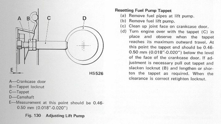

 Tappet should be 0.46-0.50 mm below the level of the face of the crank case  door.
if in doubt eer on the under rather than over. Fuel starvation is better than forcing the cam against the tappet. Took me three goes and I was only lengthening tappet half a turn at a time.
