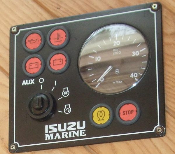

aristorias Posted August 4 Report Share Posted August 4 I have a 2009 Isuzu control panel, the one with the red plastic circles over the warning lights. Someone said that you can obtain the red plastic inserts to replace the existing ones which are worn or broken. The lights work and it is only the tops which are damaged. Does anybody know where I can find the inserts? This would be a much better option than replacing the light's themselves as they are about £28 quid each! Thanks for your help Ian Link to comment Share on other sites More sharing options...
blackrose Posted August 4 Report Share Posted August 4 Could you post a picture of the panel? Link to comment Share on other sites More sharing options...

aristorias Posted August 5 Author Report Share Posted August 5 Here is one like it..... Link to comment Share on other sites More sharing options...
Tracy D'arth Posted August 5 Report Share Posted August 5 I have never found a source for those lamp lens or who made them. It could be VDO as they made the tachos but I have no way of confirming that. Link to comment Share on other sites More sharing options...
Tony Brooks Posted August 5 Report Share Posted August 5 1 hour ago, aristorias said: Here is one like it..... I think it is the logos that will be the problem, but I would hope that you could find some without logos. Say red for charge green for oil, blue for overheat and yellow for heaters. Link to comment Share on other sites More sharing options...

aristorias Posted Saturday at 08:36 Author Report Share Posted Saturday at 08:36 Thanks to everyone who replied. I have found some clear film intended for car taillights repair in red and amber and intend to try that. The logos are actually printed underneath the coloured bit so should show through after I insert the film. Might not work but worth a try! Link to comment Share on other sites More sharing options...
Ronaldo47 Posted Saturday at 12:09 Report Share Posted Saturday at 12:09 (edited) You can buy small (14ml) pots of transparent coloured paint (by Humbrol, Revell, Tamiya for example) from shops that sell plastic model kits. I use them for reviving the colours of my vintage christmas tree lights, as well as colouring plain glass bulbs . They adhere well to glass and plastics. Edited Saturday at 12:16 by Ronaldo47 typos Link to comment Share on other sites More sharing options...
