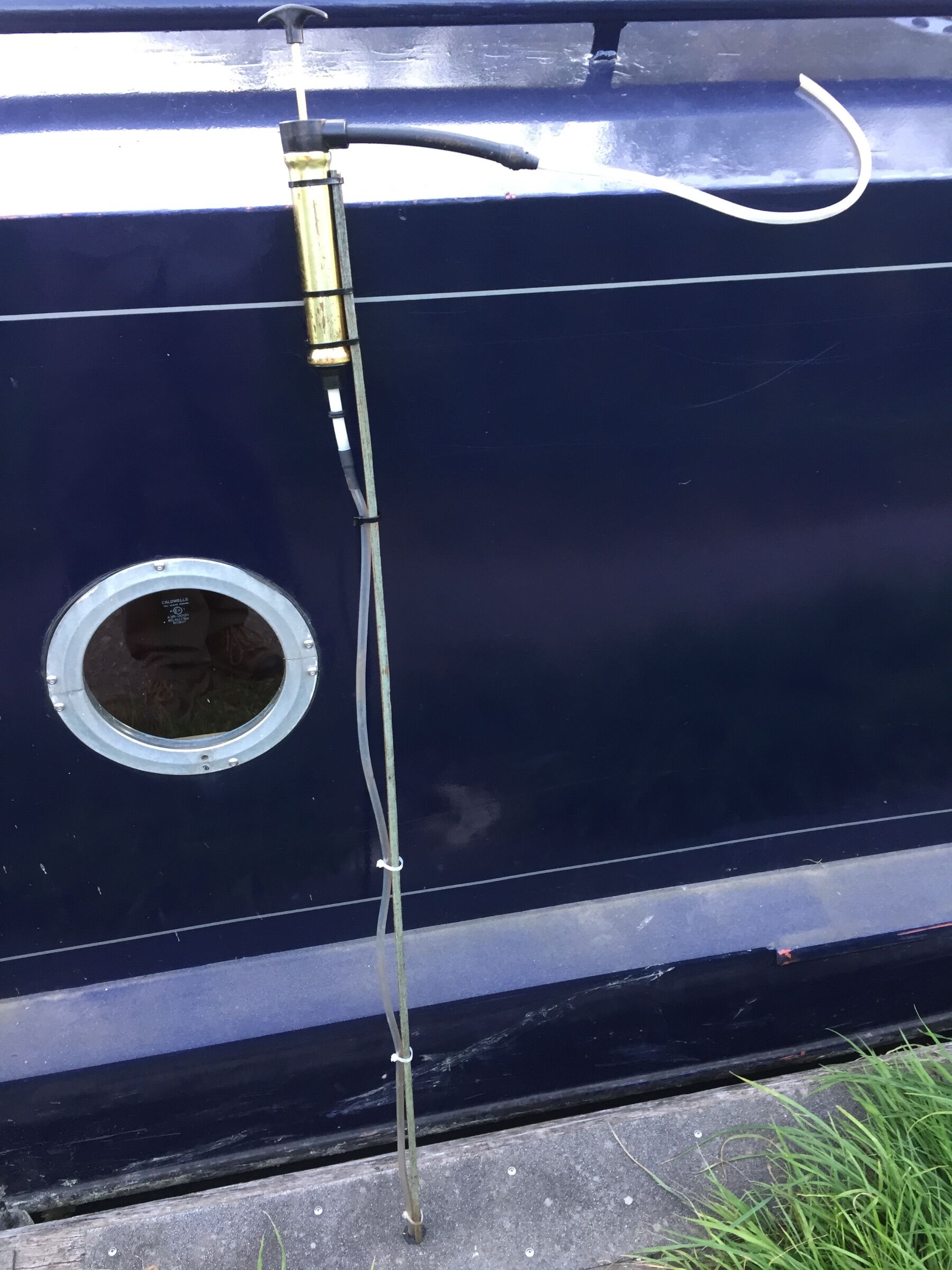

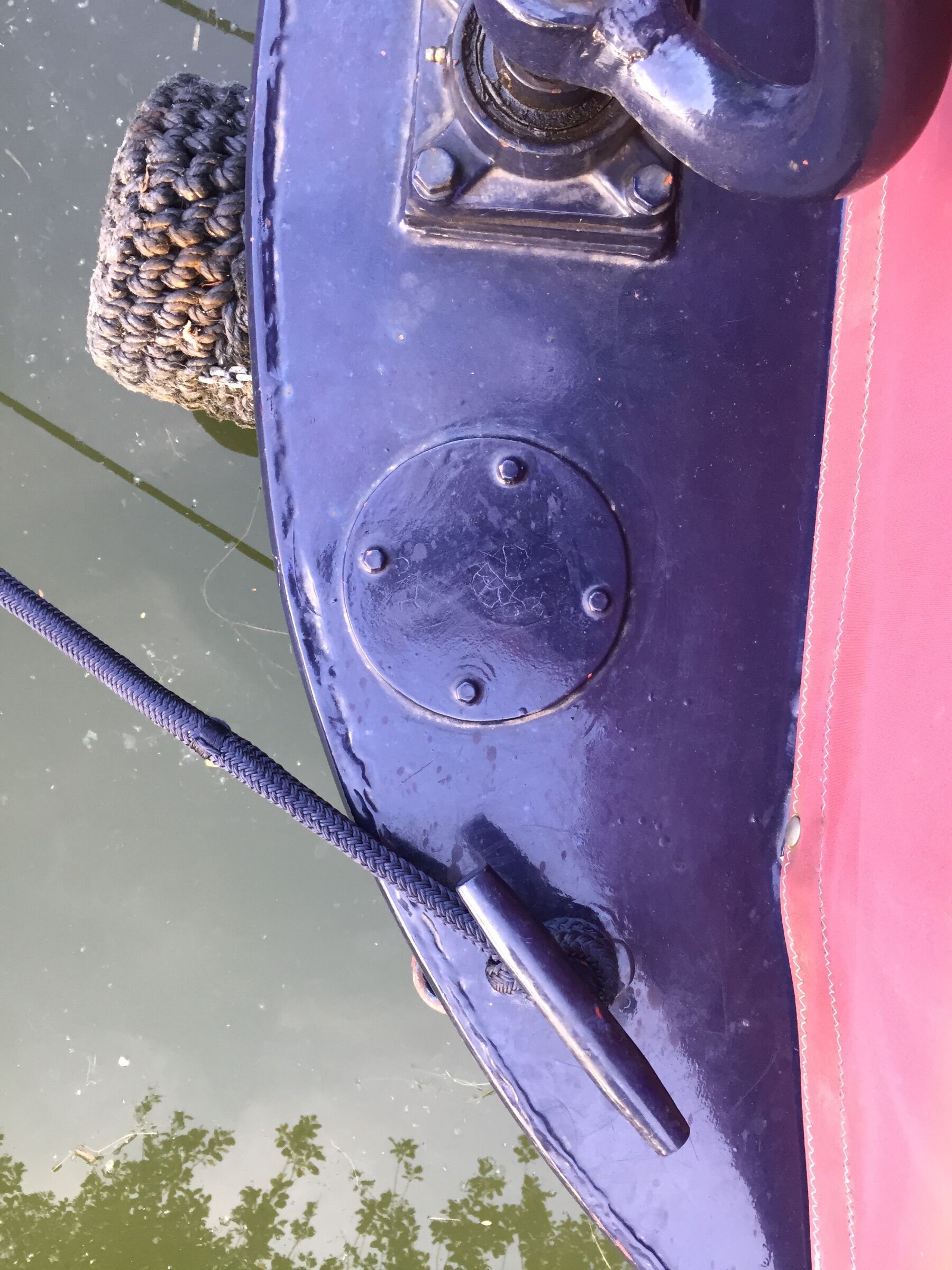

Tony Brooks Posted June 20, 2022 Report Posted June 20, 2022 30 minutes ago, LadyG said: I've yet to find a pump, I know the kind you mean, just never found one, I'll try Amazon, I'm on Temporary Prime, till I remember how to unPrime. I think we discussed how long a tube would be required to get below level of this Syphon. I had a cruiser stern so it was easy to stand the milk carton on the baseplate beside the engine. The copper pipe was pump depth plus about six inches. The plastic hose went from the top of the copper pipe down to the baseplate. The hose can be longer because it makes it easier to put your thumb over the end while you transfer to the next milk carton. 46 minutes ago, Tony1 said: Thanks Tony, I'm asking because I'm considering ways of getting rid of any water that might be starting to accumulate at the bottom of the tank, as a preventive step. I've got a siphon tube but its a straight length of fairly rigid plastic, and of course I'll need a bent tube to reach into all the corners of the tanks base. I'm surprised the chandleries dont sell a suitable tube with a simple hand pump attached, as it seems it would be something a lot of boaters might/should be interested in using, even as a periodic check. I think a pump just complicates things, I am all for KIS. The size of the copper tube is not that important but as long a sit is large enough to not block with crud. The clear plastic pipe, clear so you can see what you are syphoning up, needs to be a push fit on the copper, maybe with a hose clip. I can understand why some may not like the idea of starting the syphon with a suck but I rarely got a mouthful of diesel. Even if you do it is easy to spit out and the worst bit is the taste for a while and then the diesel smell/taste if you burp. As far as I know diesel is not poison but enough may give you the squitters - never has to me.
Mad Harold Posted June 20, 2022 Report Posted June 20, 2022 I used a fairly cheap hand suction pump. Think the make was Housman, but not sure,anyway it was a plastic container (held about 5ltr) with a pump on top. It worked by sucking the air out of the container and drawing the stuff out with the aid of a length of 15mm copper pipe to get in the corners of the tank. It never blocked because the pump itself was not in contact with the mucky fuel.The vacuum in the container drew the fuel up.
Peugeot 106 Posted June 20, 2022 Report Posted June 20, 2022 1 hour ago, Tony1 said: Do please forgive my ignorance on this, I may well be talking b****cks as usual, but if you are worried about there being water at the bottom of the fuel tank, couldn't you buy a fuel siphon tube (with a hand squeezed pump on it) for about £10? That will reach down and suck up whatever is lurking down there, so you can have a look yourself and see what's what. If there is any water under the fuel, its obviously been there for a while, so why not wait till you have a fairly calm day to avoid stirring things up, and then suck out what water and crud is in there, and then let the fuel run down a bit through normal use, and call in the fuel polishers when you are down to 30 litres or so? No point paying a daft amount of money per litre to polish 150 litres, when you can polish a much smaller volume? The main objective of the polishing is to get rid of the bacteria responsible, right? So it would seem easier to do that with only a 20% full tank, provided you firstly suck out most of the crap underneath with a siphon tube. Agreed. My tank 4 years ago was so full of crud and wet diesel that I cut a hole using a holesaw in the top of the tank. The diesel wasn’t worth saving so I took it to the tip and cleaned the tank out properly with tags on the end of a stick. I fitted a flange and gasket over the hole with bolts tapped into the tank. Now every year I suck a sample off the bottom of the tank with the pump shown. The end of the tube is cut at an angle and touches the base of the tank. Some people use a copper tube with their thumb over it but I don’t like this method. Any water could drop out as you lift the tube. Fuel polishing if your fuel is properly contaminated is going to cost a fortune. Better in my view to bite the bullit. Will polishing get the crud out of the corners? A rag certainly will. I fill my tank to the brim at winter -smug feeling this year it was 75 p/ litre - and have never found water it bug since
