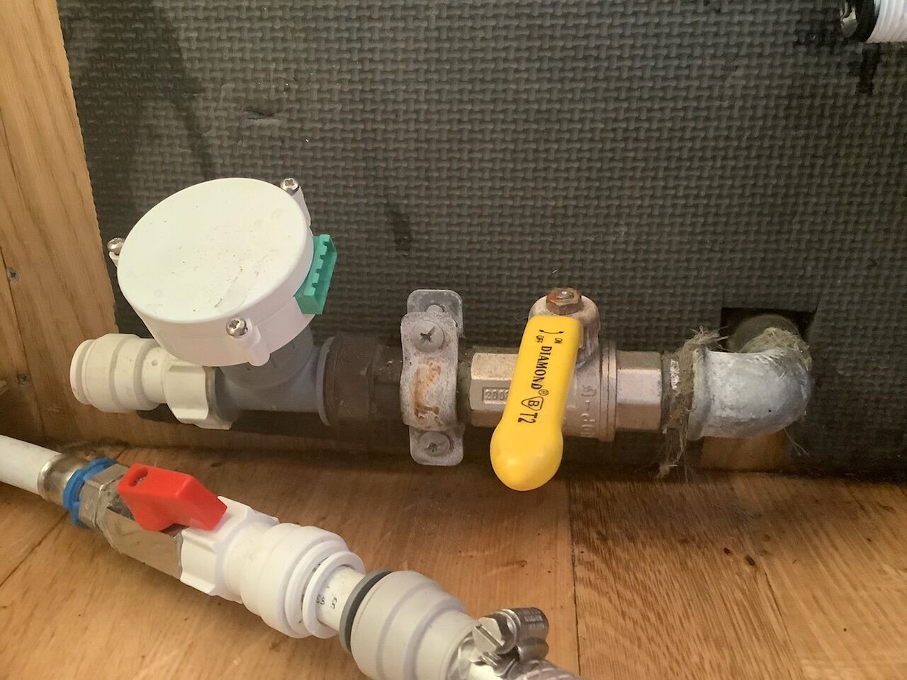

Lizzy Lou Posted March 30 Report Share Posted March 30 I see discussions have drifted a little from narrow boat plumbing, however this still seems like the obvious place to ask my question. I have tracked down my plumbing problem to a ‘restriction/blockage’ between my 800L fresh water tank under the well deck and the inlet to my water pump. (The inlet filter is clean!) That’s a run of pipe work approximately 12” long. As well as eliminating filter blockage, I also can only achieve a trickle of water out of the tank even with the tank cap off, so I imagine I don’t have a vent blockage? So my question is, do any of you chaps have any good ideas how I might clear such a blockage? I have thought about compressed air, but I guess that would only blow any blockage back into the tank? otherwise I wonder if I’ll be asking a boatyard to chop out my (allegedly stainless) fresh water tank? Many thanks for your kind assistance. Link to comment Share on other sites More sharing options...
jonathanA Posted March 30 Report Share Posted March 30 backflush with a hosepipe ? or even use the water pump 'in reverse' to pump water out of a container into the tank. is there an inspection /access hatch to the tank. - if so go in there. those ball valves can give issues if they are cheapies. the abundance of jointing paste makes me wonder if that could be causing a problem ? (if there is as much on the inside). I would remove the level sensor and then try poking a wire or one of those drain cleaner type springy things in to see if there is a blockage, but risk is it the blockage just gets stuck again. Ideally you want to empty the tank and remove everything up to the galvanised elbow and see the outlet is clear... Link to comment Share on other sites More sharing options...
Lizzy Lou Posted March 30 Report Share Posted March 30 Hi Jonathan, very much appreciated. I’ve no access to the tank other than through the filler neck. I’ve pushed a pencil past the level sensor and there’s no blockage as far as the stopcock/ball valve. I think what you are seeing as jointing paste may be just fluff, as this assembly usually sits inside a small cupboard which I have removed. Quote even use the water pump 'in reverse' to pump water out of a container into the tank. Genius! I will give that a try and report back. many thanks. LL Link to comment Share on other sites More sharing options...
MtB Posted March 30 Report Share Posted March 30 1 hour ago, Lizzy Lou said: I see discussions have drifted a little from narrow boat plumbing, however this still seems like the obvious place to ask my question. I have tracked down my plumbing problem to a ‘restriction/blockage’ between my 800L fresh water tank under the well deck and the inlet to my water pump. (The inlet filter is clean!) That’s a run of pipe work approximately 12” long. As well as eliminating filter blockage, I also can only achieve a trickle of water out of the tank even with the tank cap off, so I imagine I don’t have a vent blockage? So my question is, do any of you chaps have any good ideas how I might clear such a blockage? I have thought about compressed air, but I guess that would only blow any blockage back into the tank? otherwise I wonder if I’ll be asking a boatyard to chop out my (allegedly stainless) fresh water tank? Many thanks for your kind assistance. Your picture paints a 1,000 words... I'd say it will turn out to be that galvanised iron M&F elbow connecting directly into the tank. I've seen them turn into a horrible ball of rust inside where the thread has been cut so there is no protective zinc. I suggest you buy a new elbow and replace it. Either drain the tank first or 'snatch' it (as plumbers say), meaning change it live. The water pressure from the tank water will be tiny. Link to comment Share on other sites More sharing options...

David Mack Posted March 30 Report Share Posted March 30 8 minutes ago, MtB said: Your picture paints a 1,000 words... I'd say it will turn out to be that galvanised iron M&F elbow connecting directly into the tank. I've seen them turn into a horrible ball of rust inside where the thread has been cut so there is no protective zinc. I suggest you buy a new elbow and replace it. Either drain the tank first or 'snatch' it (as plumbers say), meaning change it live. The water pressure from the tank water will be tiny. Agreed. Blockage is most likely on the elbow or at the tank outlet into the elbow. Either way you have to remove the elbow fitting, which probably involves removing the other fittings one by one. Rather than trying this with the tank full, which will get water everywhere, I would look into draining the water tank first by poking a length of hose pipe down the filler tube to the bottom of the tank and pumping out the water with one of those pumps which can be driven by an electric drill. Link to comment Share on other sites More sharing options...
Lizzy Lou Posted March 30 Report Share Posted March 30 Some very interesting contributions which I really do appreciate. Funnily enough talking of horrible balls of rust, I have noticed that the white plastic elbow in the pipe run is stained a very nice rusty red on the inside! 😳 Whilst I am well aware that, all I have really achieved is to blow any blockage back into my water tank, what I can say is that Jonathan’s very clever idea worked a treat. My water flow is (currently) back to normal. For who knows quite how long is of course anyone’s guess!! 🥺 Very many thanks to all. For now! 😁 1 Link to comment Share on other sites More sharing options...
MtB Posted March 30 Report Share Posted March 30 (edited) 33 minutes ago, David Mack said: Rather than trying this with the tank full, which will get water everywhere Point of Order... Down skilfully, snatching a new elbow into that tank with it full, would spill no more than about an eggcup of water on each of the three snatches actually involved. Possibly a good deal less and easily contained with a towel. But it might be a different matter the first three or four times one tries it. No matter how many times one does it though, it always gets the ol' heart a-racing!! Edited March 30 by MtB Add a bit. Link to comment Share on other sites More sharing options...

Tacet Posted March 30 Report Share Posted March 30 (edited) 53 minutes ago, MtB said: Point of Order... Down skilfully, snatching a new elbow into that tank with it full, would spill no more than about an eggcup of water on each of the three snatches actually involved. Possibly a good deal less and easily contained with a towel. But it might be a different matter the first three or four times one tries it. No matter how many times one does it though, it always gets the ol' heart a-racing!! How is it done with only three wet occasions? It doesn't look as though the elbow can be swung with the valve attached. Edited March 30 by Tacet Link to comment Share on other sites More sharing options...
MtB Posted March 30 Report Share Posted March 30 4 minutes ago, Tacet said: How is it done with only three wet occasions? It doesn't look as though the elbow can be swung with the valve attached. Turn the valve OFF, remove the handle. Remove the valve and the nipple as one assembly from the elbow and snatch in a 1/2"BSP plug. That's wet operation 1. Prepare the new elbow by sealing another 1/2"BSP plug into it and applying your choice of thread sealant to the male thread. Unscrew the elbow from the tank and snatch the new elbow into the tank. Wet operation 2 completed. Clean up the valve nipple and apply new thread sealant. Remove the 1/2" plug from the new elbow and snatch in the valve nipple and valve. 3rd wet op done. Congratulate yourself on saving three hours emptying and refilling the tank! Link to comment Share on other sites More sharing options...
ditchcrawler Posted March 30 Report Share Posted March 30 1 hour ago, MtB said: Turn the valve OFF, remove the handle. Remove the valve and the nipple as one assembly from the elbow and snatch in a 1/2"BSP plug. That's wet operation 1. Prepare the new elbow by sealing another 1/2"BSP plug into it and applying your choice of thread sealant to the male thread. Unscrew the elbow from the tank and snatch the new elbow into the tank. Wet operation 2 completed. Clean up the valve nipple and apply new thread sealant. Remove the 1/2" plug from the new elbow and snatch in the valve nipple and valve. 3rd wet op done. Congratulate yourself on saving three hours emptying and refilling the tank! Or be like my brother in Law removing a radiator to decorate, sit on the floor with your thumb on the end until the other half comes home to pass the bit you dropped. Link to comment Share on other sites More sharing options...
