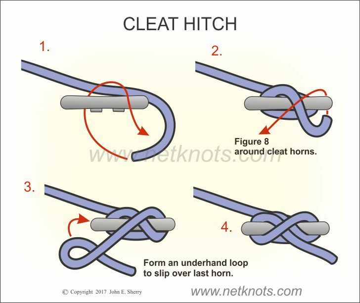

Prove me wrong - T studs at the bow, a centre post and stern dollies are all throwbacks.  Mostlt to horse powered boats and/or towed butties. There is nothing they do that a well designed and well placed marine cleat can't do better. Two cleats at the bow (although one centre cleat would do), two cleats one each side in the middle and one on each stern quarter. All lines secured by using the stronger, much simpler to tie, simpler to untie and less likely to jam cleat hitch.
Nothing wrong with tradition but also nothing wrong with accepting improvements.
A horn cleat is the traditional design, featuring two “horns” extending parallel to the deck or the axis of the spar, attached to a flat surface or a spar,

1 hour ago, TomIre said:
[snip]Two cleats at the bow (although one centre cleat would do), two cleats one each side in the middle and one on each stern quarter. All lines secured by using the stronger, much simpler to tie, simpler to untie and less likely to jam cleat hitch.[snip]
Isn’t a t-stud just one big centre cleat? The cleat hitch that you show is how I tie the rope to our t-stud anyway.

The cleat hitch shown is fine for tying off a line from elsewhere to a cleat or tee stud (such as when tying off the bow rope back on the boat), but it isn't much use for a rope you want secured to the boat, and which you might tie off elsewhere.

It's fine for tieing off back to the boat. But it isn't appropriate for the end of the rope which is permanently attached to the boat. For that an eye splice cow-hitched over tee stud, bollard or cleat is secure yet easy to remove when necessary.

I sometimes use the hitch as shown in the diagram on the T, it is OK if I have brought the mooring rope back to the bow from a bollard or ring, or pin but generally I moor in quiet places, so leave ropes on the verge.

I also find that a T-stud hitch (two round turns and a half hitch over the front horn) and a cleat hitch (which done correctly only has half a round turn at the back) are not really interchangeable. I wonder if folk who say they tie a cleat hitch on a T-stud are actually doing some form of hybrid.
The T-stud hitch is really simple and effective.
