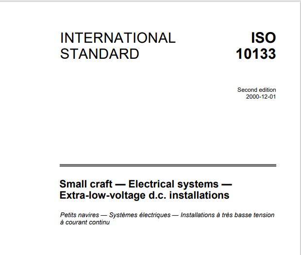

5 minutes ago, Jen-in-Wellies said:
Maximum of four connectors per post, if I remember correctly.
Correct'
Section :
10.8 No more than four conductors shall be secured to one terminal stud
