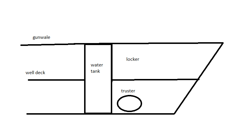

I did, I have a tug deck and the water tank sits behind the thruster tube, I still have room for a double bed on top of the tank under the well deck. I would suggest sitting down and chattind with the builder. Maybe a base plate to gunwale  height  right across the boat directly behind the bow locker
Works with a tug deck, but if you have a well deck like the OP it pushes it back a couple of feet ("thickness" of tank) and shortens the cabin by the same amount. Since you only gain the volume above well deck level, anything less than a couple of feet isn't really worth it...
