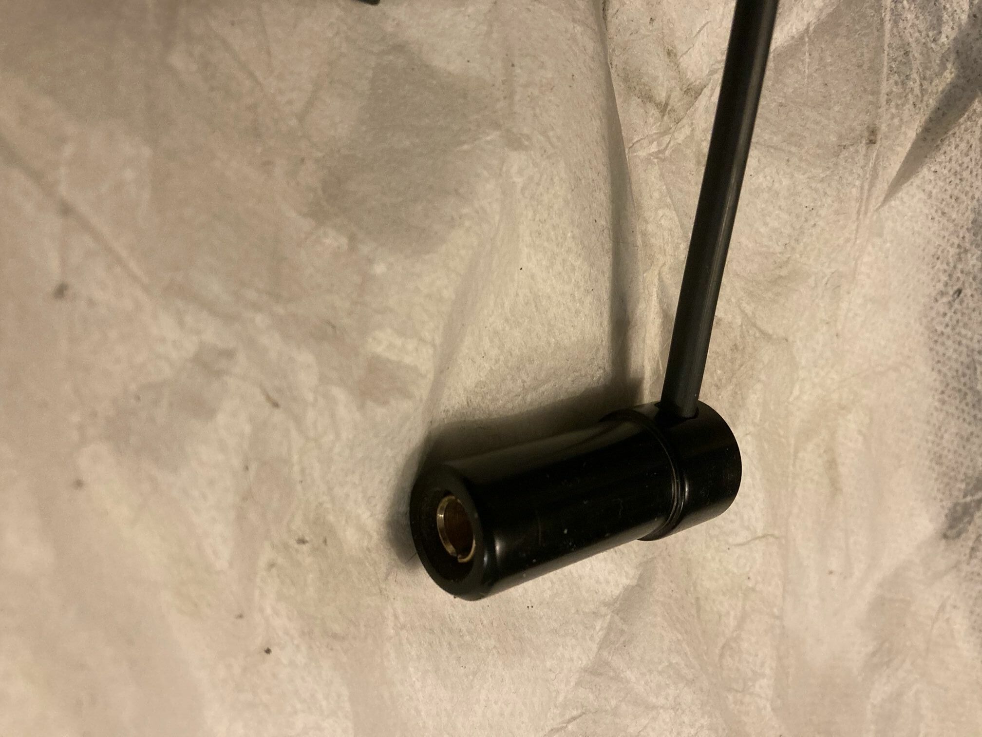

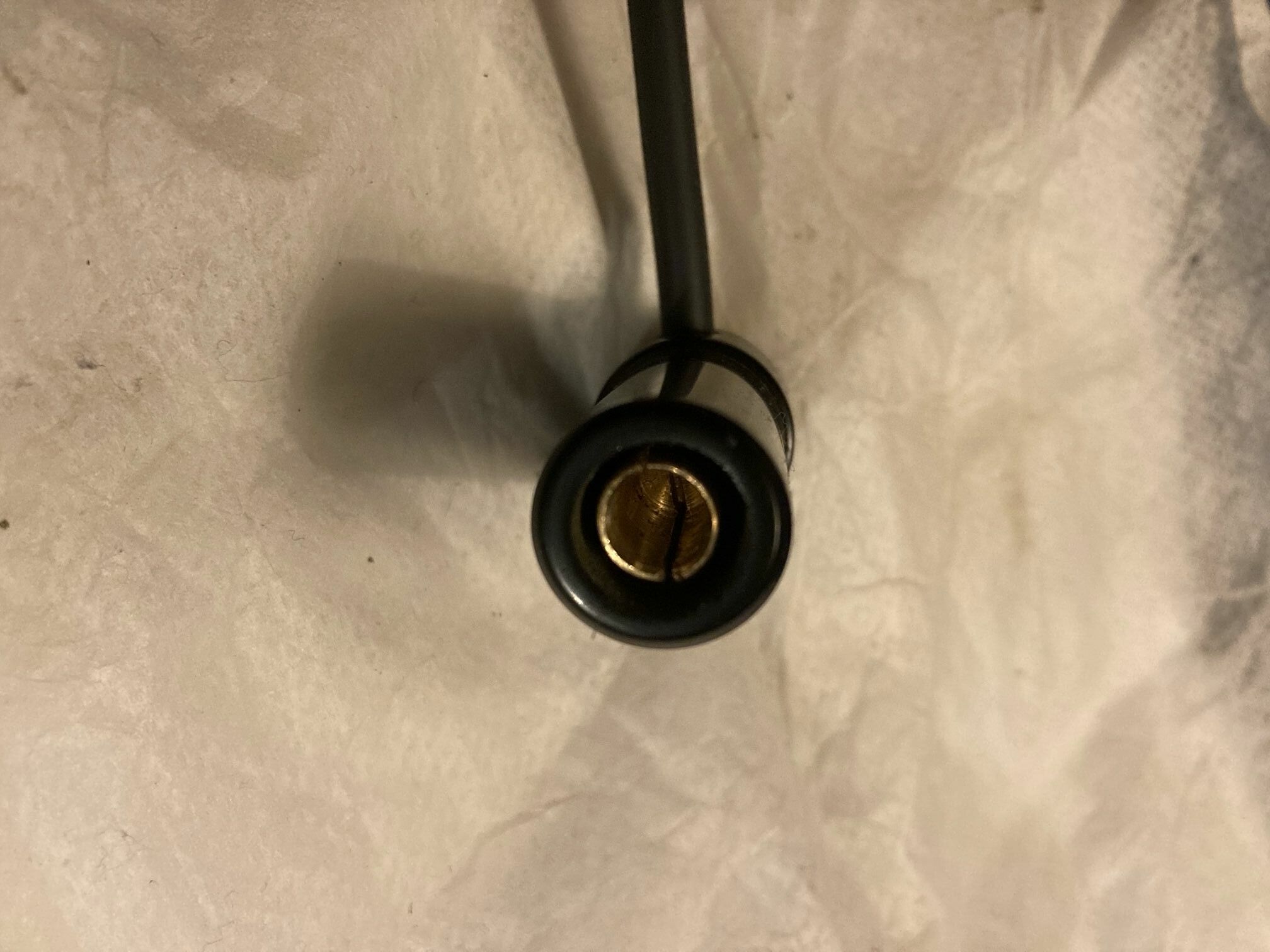

Interesting. Very neat. The parts list clip is just a lyre shaped piece of bent wire, presumably brass or bronze..  The version you have looks much more durable.  What did you make the black bit of the body from?
N
N
The body is Ebonite, following the instructions of Dick Goble, who described the design from memory. Tom Cauldwell sent me some photos of an original one and between the two there was enough to go on. The big advantage of Ebonite is that it is electrically insulating, so you can put it down while starting on petrol without risking earthing out the magneto. I can imagine that this will be particularly useful for hand starting (when I get that sorted out).
Alec
I may amuse myself by making one whilst I wait for the crankshaft to come back from being  ground  and reinstalled.  It appears to have got stuck iqn a queue behind the engine from a Rolls Royce Phantom  and the bottom end of a National, among other things.
I daresay black Delrin will be an OK substitute for ebonite.
N

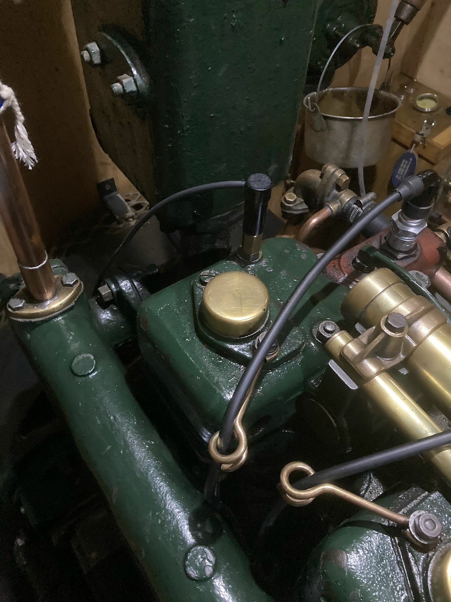

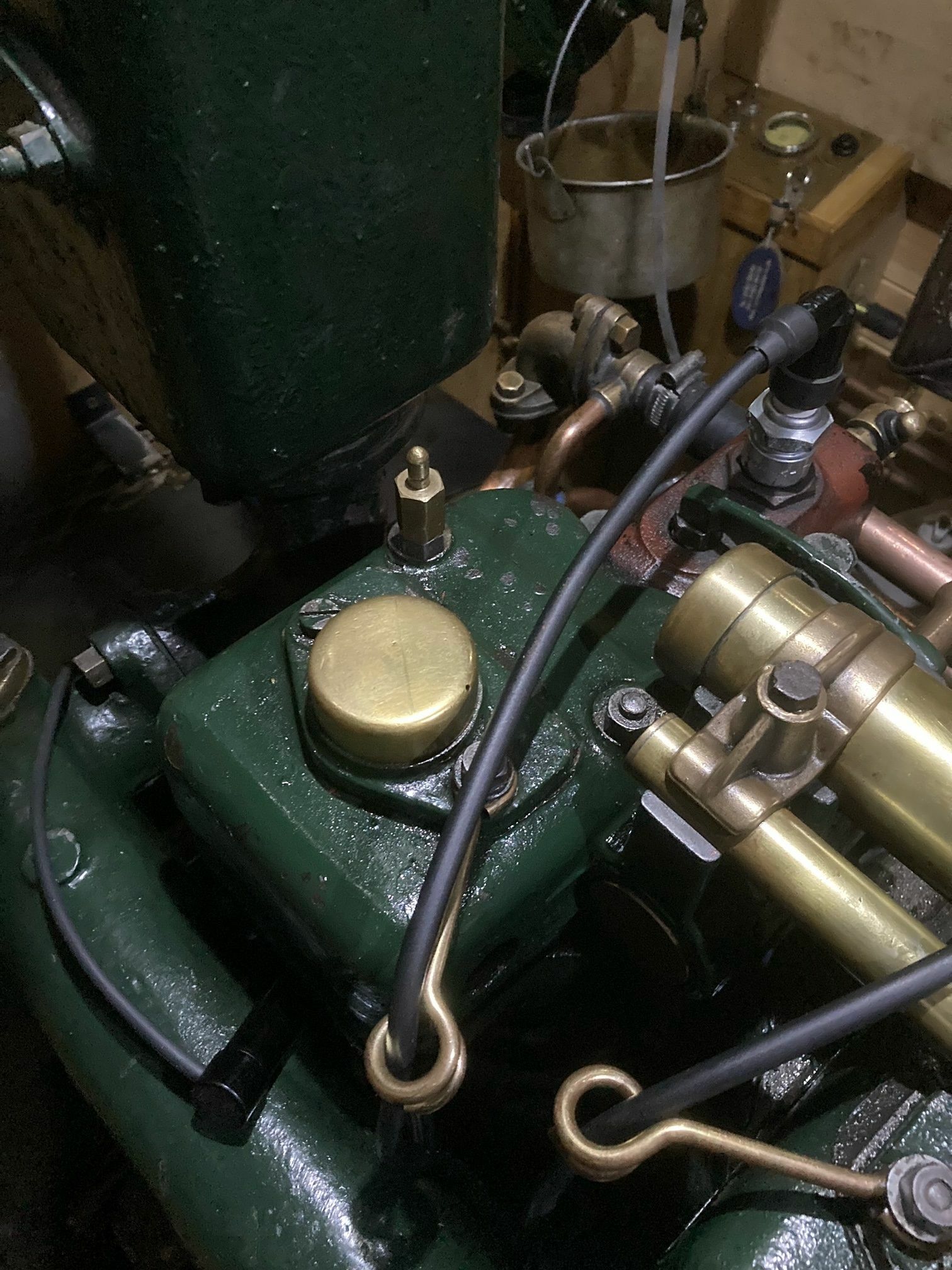

As promised, photos showing where the stopping terminal goes. Hopefully these show what you need.
Alec
Edited by agg221
12 minutes ago, BEngo said:
Splendid, thank you.  I never thought it would be up there, heaven knows why not.
N
You're welcome.
One observation - the photographs were taken before a visit by Dick Goble, who pointed out that the earthing wire should run the other side of the exhaust, down nearer the spark plug wire, to avoid direct contact between the wire and the exhaust manifold to minimise heating. This has since been changed. The other end of the wire is a simple crimp on ring terminal. I did look at the solder-on brass HT lead terminals but they only seem to be available to suit the 7mm OD HT lead and this is 5mm.
