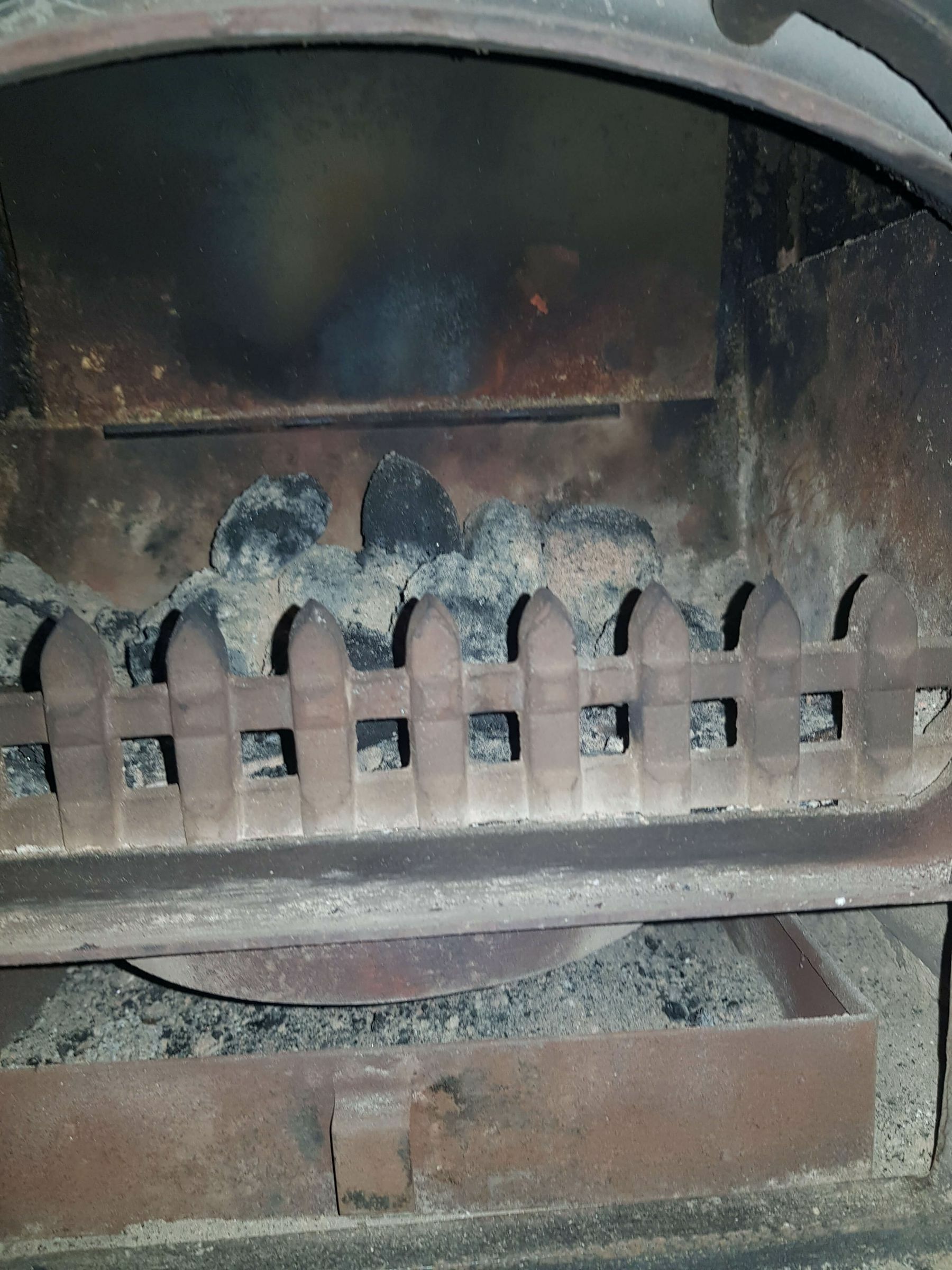

Ianws Posted October 9, 2021 Report Share Posted October 9, 2021 We have a firewarm 4 which has been in use with mainly smokeless fuel for many years. It doesn't have traditional fire bricks. It has thick cast iron bricks at the sides and back with a gap to the actual stove sides. Link to comment Share on other sites More sharing options...
PD1964 Posted October 9, 2021 Report Share Posted October 9, 2021 (edited) 1 hour ago, The Happy Nomad said: The OP posted this in June and suggested the replacement would be the same. Firewarm 4 (which personally I've never heard of) If it is that one a quick user manual search and it has no mention of fire bricks and the fire parts list does not contain any. It does say though if using coal mineral fuel, do not stack higher then the rear burn plate as this could result in damage. Edited October 9, 2021 by PD1964 Link to comment Share on other sites More sharing options...
Tony Brooks Posted October 9, 2021 Report Share Posted October 9, 2021 8 minutes ago, Ianws said: We have a firewarm 4 which has been in use with mainly smokeless fuel for many years. It doesn't have traditional fire bricks. It has thick cast iron bricks at the sides and back with a gap to the actual stove sides. Those must be what the chap referred to as baffles, but I could see no mention of them in the parts list for the stove THM linked to. That would make perfect sense as long as they are sacrificial and can be easily replaced.. Link to comment Share on other sites More sharing options...
Ianws Posted October 9, 2021 Report Share Posted October 9, 2021 This is the inside of our stove. The iron "bricks" are still sound after approx 15 years. 1 Link to comment Share on other sites More sharing options...

Ianws Posted October 9, 2021 Report Share Posted October 9, 2021 That's what I have and shown in the picture above. As long as you have the side iron liners with a small gap between them to the stove sides ( feel round the top of the sides) that's how they are meant to be . And worked fine for me for many years 2 Link to comment Share on other sites More sharing options...

Sanddancer Posted October 10, 2021 Author Report Share Posted October 10, 2021 On 09/10/2021 at 14:56, Ianws said: This is the inside of our stove. The iron "bricks" are still sound after approx 15 years. This This is just what I wanted to see and hear. Thank you Link to comment Share on other sites More sharing options...
