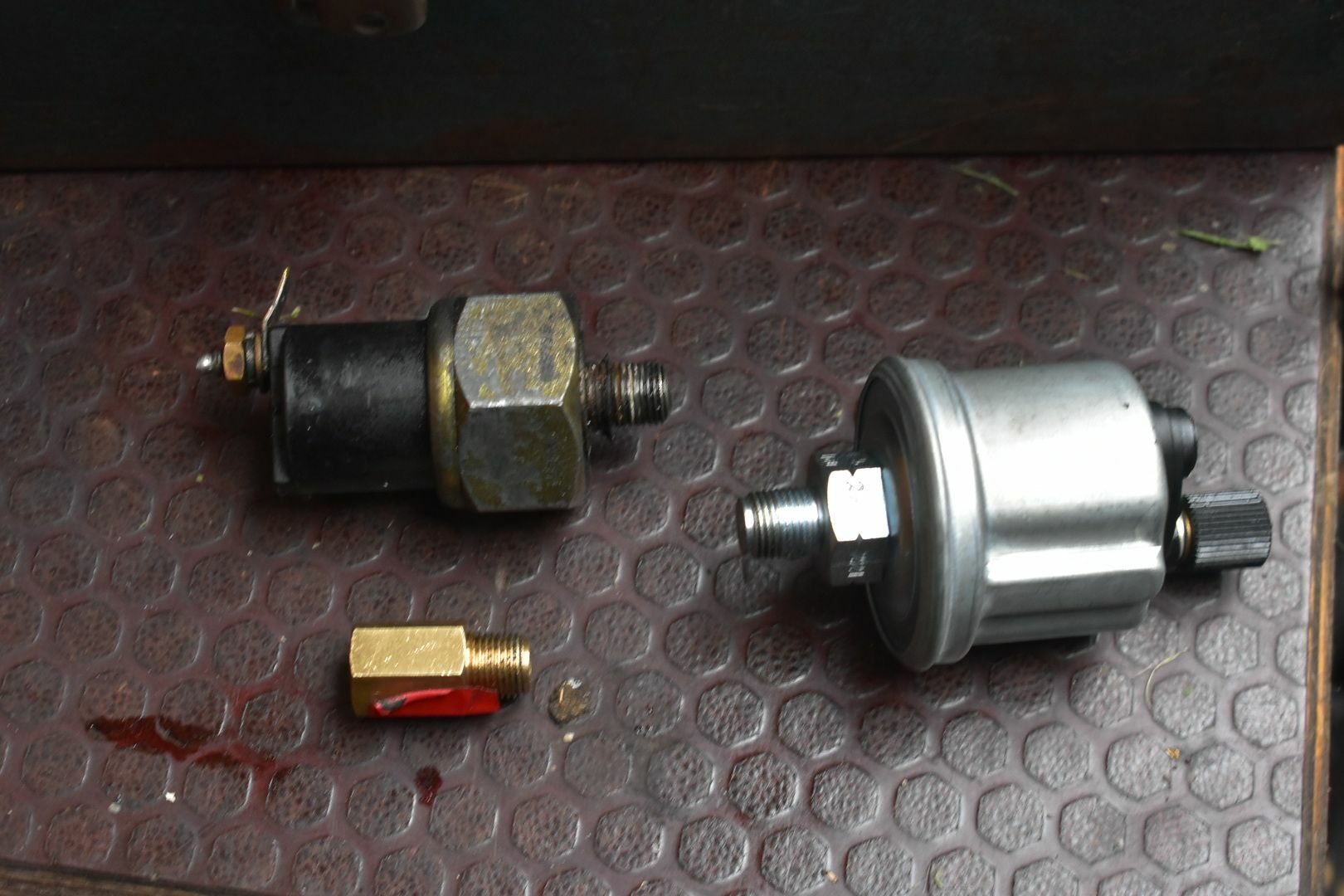

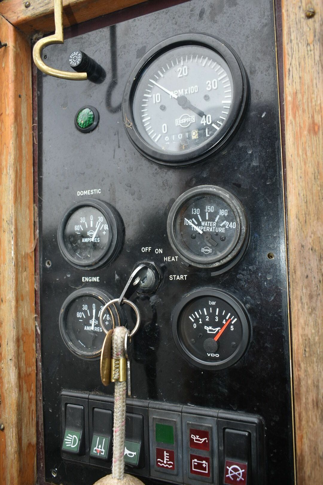

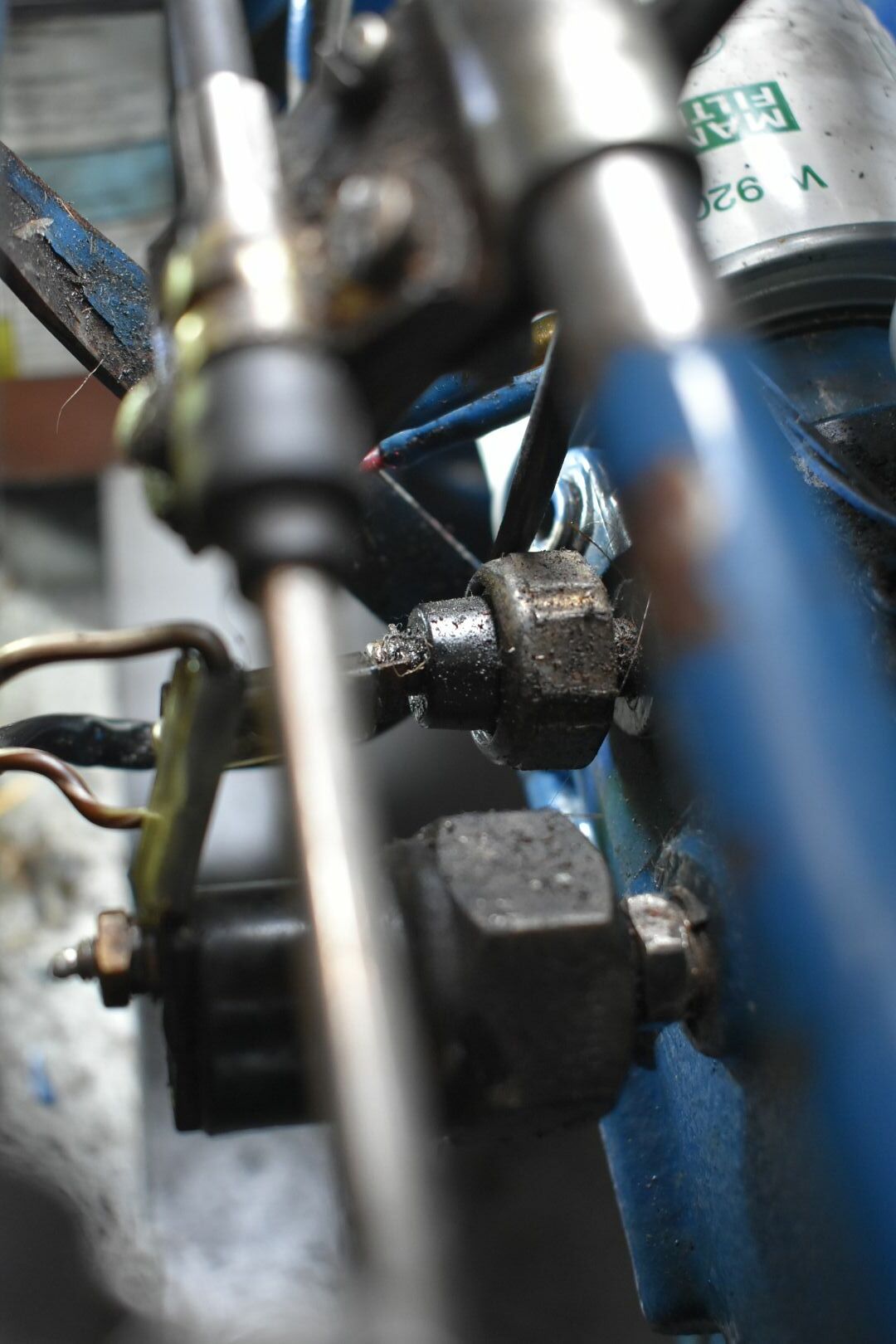

Scholar Gypsy Posted October 7, 2021 Report Posted October 7, 2021 I have two oil pressure sensors on my engine (Mitsubishi K4). The further one in this picture is the low pressure alarm, and this works fine (gets tested every time I stop and start the engine). And when I change the oil it beeps for a couple of seconds as the new oil is picked up by the pump and gets to the sensor -- all as normal. The nearer one is connected to a standard sized dial on the control panel, and this has been behaving rather sluggishly for a few months. I don't think I have a substantive problem with the oil pressure, so I am planning to replace the sensor and the dial with a new pair. (I also grounded the sensor wire, and the gauge flipped over to maximum pressure, so I think the circuit is OK - I had been about to check the connector plugs...) So my question is: is the threaded hole in the engine block a standard size? The parts list for engine also includes a couple of plugs for these holes (I guess in case they are not in use) which are labelled "PLUG, taper (PT-1/8)". I can find quite a few sensors on the internet, labelled 1/8" NPT, and as far as I can see PT and NPT are not quite the same (pipe thread and national pipe thread). It may be that there is an adaptor between the engine block and the sensor. So do I need a PT to NPT adaptor and then an NPT sensor ?? Many thanks for reading this far ....

Scholar Gypsy Posted October 11, 2021 Author Report Posted October 11, 2021 Thank you, I have found a BSPT (taper) to NPT adapter, and a NPT sender, so I hope that will work.... I am assuming that the hole in the control panel is a standard size - they do all seem to be 52mm...
MoominPapa Posted October 11, 2021 Report Posted October 11, 2021 23 minutes ago, Scholar Gypsy said: I am assuming that the hole in the control panel is a standard size - they do all seem to be 52mm... ... or two inches......... MP. 1
Scholar Gypsy Posted October 11, 2021 Author Report Posted October 11, 2021 20 minutes ago, MoominPapa said: ... or two inches......... MP. But that is 50.8 mm ...
ditchcrawler Posted October 11, 2021 Report Posted October 11, 2021 1 hour ago, Scholar Gypsy said: But that is 50.8 mm ... Not everyone thinks so 1

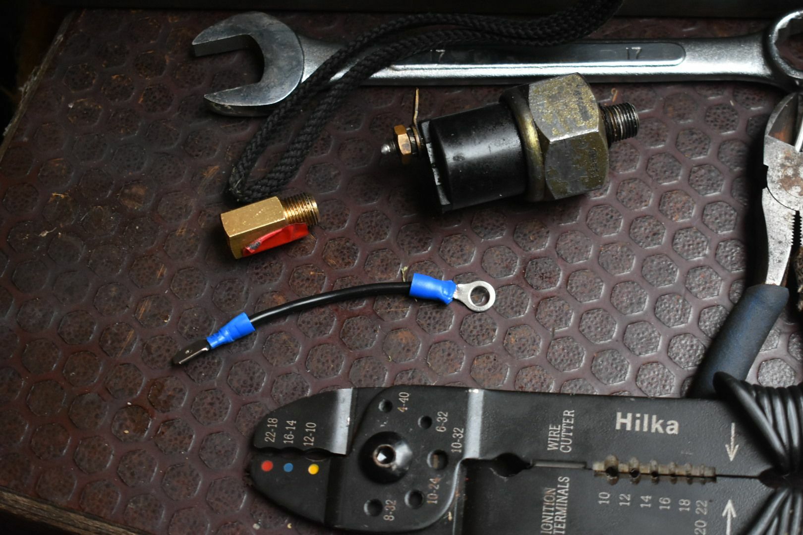

Scholar Gypsy Posted October 19, 2021 Author Report Posted October 19, 2021 Thanks again to all for their advice, and history on the making of pipe joints. I bought a BSPT to NPT adaptor, and a new sensor and gauge (VDO). In the end I was able to remove the old sensor while leaving the existing adaptor in the engine block, and I was able to satisfy myself (using the redundant adaptor) that the old and new sensors were both NPT. A bit of PTFE and some crimping, and I am now getting over 4 bars. It will be interesting to see again how this drops as the engine warms up. I also have a bit of kitchen towel in place, to check that the joint is not leaking. Also very pleasing that the buzzer (the other sensor) comes on exactly as the needle gets down to zero - I've never had that before.

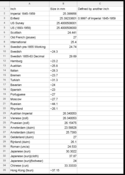

Alan de Enfield Posted October 19, 2021 Report Posted October 19, 2021 On 12/10/2021 at 17:05, BEngo said: We don't really have metric pipes. We, and the rest of Yurrup mainly have imperial pipes, and connecting threads, measured in metric units. Hence a 1/2 in (ID) pipe will fit into a 15 mm (OD) solder or compression fitting and a 1 in pipe into a 28mm solder or compression fitting. The exception is 3/4. The thread series G, Rp and Rc are all defined in SI units but are interchangeable, inter-connectable and have the same thread angle as the BSP series from which they are copied/derived. I also believe some German manufacturers still use the 26 tpi 55 deg thread angle British Brass series. Note it is not BSB, as there is no published Standard. The Whitworth series of threads also sometimes still makes an appearance from Europe! N Ahhh - but which 'inch ? There were many many inches.
ditchcrawler Posted October 19, 2021 Report Posted October 19, 2021 1 hour ago, Alan de Enfield said: Ahhh - but which 'inch ? There were many many inches. Same with land measurements in the UK, Norfolk was different to most of the rest of the country
