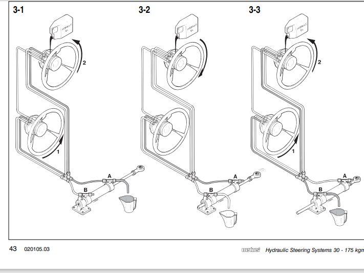

I have a similar situation with a helm in the saloon and a helm on the flybridge, unlike yours It does not have a pressurised tank, but each 'wheel' has a tank behind it which supplys the oil to the piston.
Illustration - you can fill both 'tanks' from the flybridge filler and bleeding out the air on the piston.
If it is of any help I can send the full Vetus manual whuch you can maybe use to adapt your system

Thanks Alan, that makes a lot of sense to me and suggests that my ideas about 'unpressurising' my system are reasonable.

I think you are right. As far as I know there is no need to pressurise the system, the steering pump - the thing the wheel is attached to - has maybe 5 little cylinders and pistons in it and an angled plate that pushes the pistons in one at a time as you turn the wheel. (In fact it is a smooth continuous action) That is the pressurising bit that pushes fluid to the ram. On my boat the wheel and pump are up in the wheelhouse so higher than the ram and it works entirely by gravity. If the reservoir (basically just the pump body( is full then the whole system should just work without any separate reservoir.  The filler plug on the upper wheel might have a tiny air hole in it, the filler plug on the lower wheel should'nt or you will have a puddle of oil under it.  I would just try it and see.
